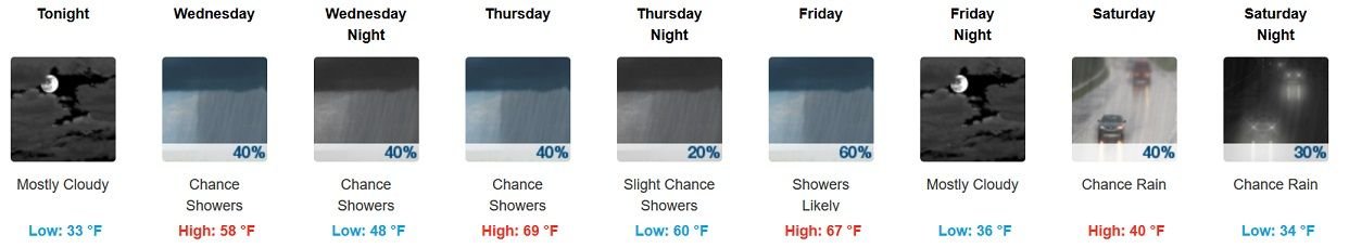

Forecast for next few days....no dry, warm garage or barn to work in! yarg!
