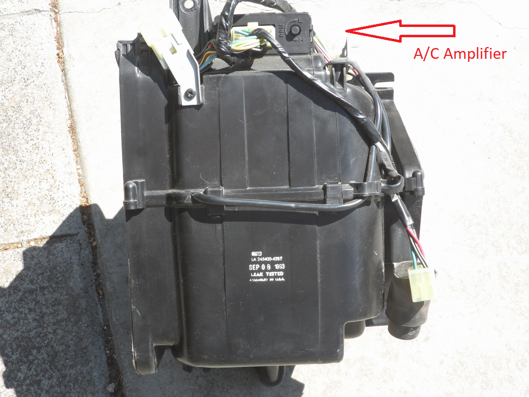

Where is the AC amplifier located? Is there a way to test if it's bad? I'm in Phoenix so it's hot and the only time I see or feel a difference with the engine, is when it "idles down". When I say idle down, I am referring to the engine not running normal, feels like it's gonna die out. So. Have to do some checking this weekend.

The A/C amplifier is on top of the cooling unit (where the evaporator is).
There is no procedure for directly testing the Amplifier. The page provided by jjrbus is actually to test the HARNESS side of the connector to the A/C Amplifier. The manual suggests that if you get all the right voltages on the harness side, then you should replace the amplifier. That might be okay for a dealership, but you'll go broke pretty quickly putting in a new amplifier on a guess. (It's only $58-$75 depending on model, but still ...)
If you suspect the operation of the amplifier, and you have the knack, you might get further using the circuit diagram. http://web.archive.org/web/201102052.../2aircondi.pdf
You could, for instance, watch the output of the pressure switch, and see if that shuts off the compressor.
