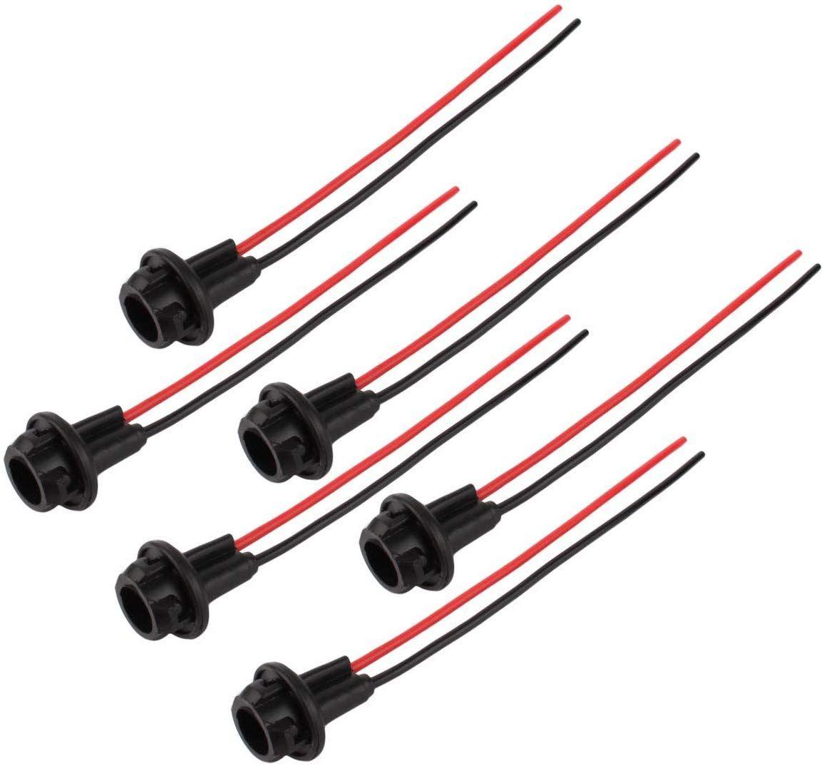

MY objective is to get brighter signals but keep blinking normal so I'm considering...
1) Keep one stock incandescent bulb on each side (rear or front, Incandescent would provide enough load to blinker relay) OR snip that resistor.
2) AND/OR add enough LED bubs to satisfy the blinker relay's current requirement by adding a T3.24 socket (below) epoxied to a hole on reflector, plug in a 194 or 921 LED, whichever would fit the housing.
T3.25 Sockets to Fit 194 or 921 bulbs.
