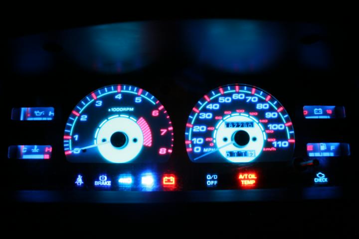

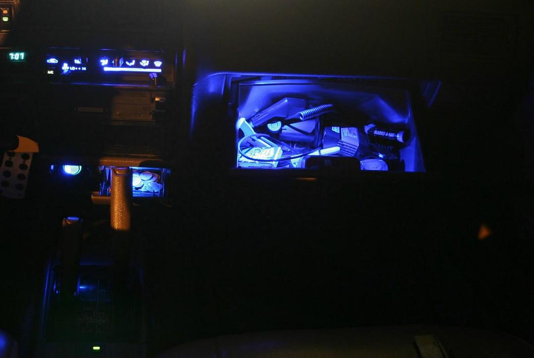

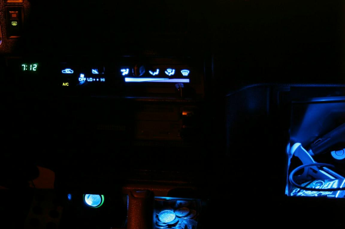

I put all my blue LEDs in the dash, cig lighter, keyhole, ashtray, climate control, and glove box, and most work fine (I ordered from superbrightleds.com). I'll post some pix when it's all reassembled.
However, the "ECT" and "A/T Temp" indicators will not work with the LEDs; they will only light up with the original bulbs. Also, the "battery" and "rear brakes" indicators stay on the entire time the truck is running when using LEDS. They don't stay on when the original bulb is used.
My gear indicator is not lighting up, so I assume it won't work with an LED either- I tried turning the ECT and A/T Temp LEDs both ways in the sockets, to no avail. I also made sure the LEDs had a snug fit in the sockets.
What's going on here?
Old Jan 25, 2009 | 08:00 PM
  #76
aviator's Avatar
Joined: Mar 2003
Posts: 11,334
From: COTKU,Ontario,Canada
The problem with the lights could be a resistance issue... some electronic indicator circuits depend on the resistance of the light to function properly, when you switch to an LED you need to add a resistor to make it functional.
Old Feb 1, 2009 | 05:07 PM
  #77
wiseguymmiv's Avatar
Joined: Mar 2004
Posts: 234
From: good ole Mississippi
A few of the gauges would not work with an LED, so I left them intact with the original bulb. Here's final product:
Attached Thumbnails Im seing blue, LED that is-dash-leds-10-6.jpg   Im seing blue, LED that is-ac-panel-leds-16-10.jpg   Im seing blue, LED that is-glove-box-16-10.jpg
