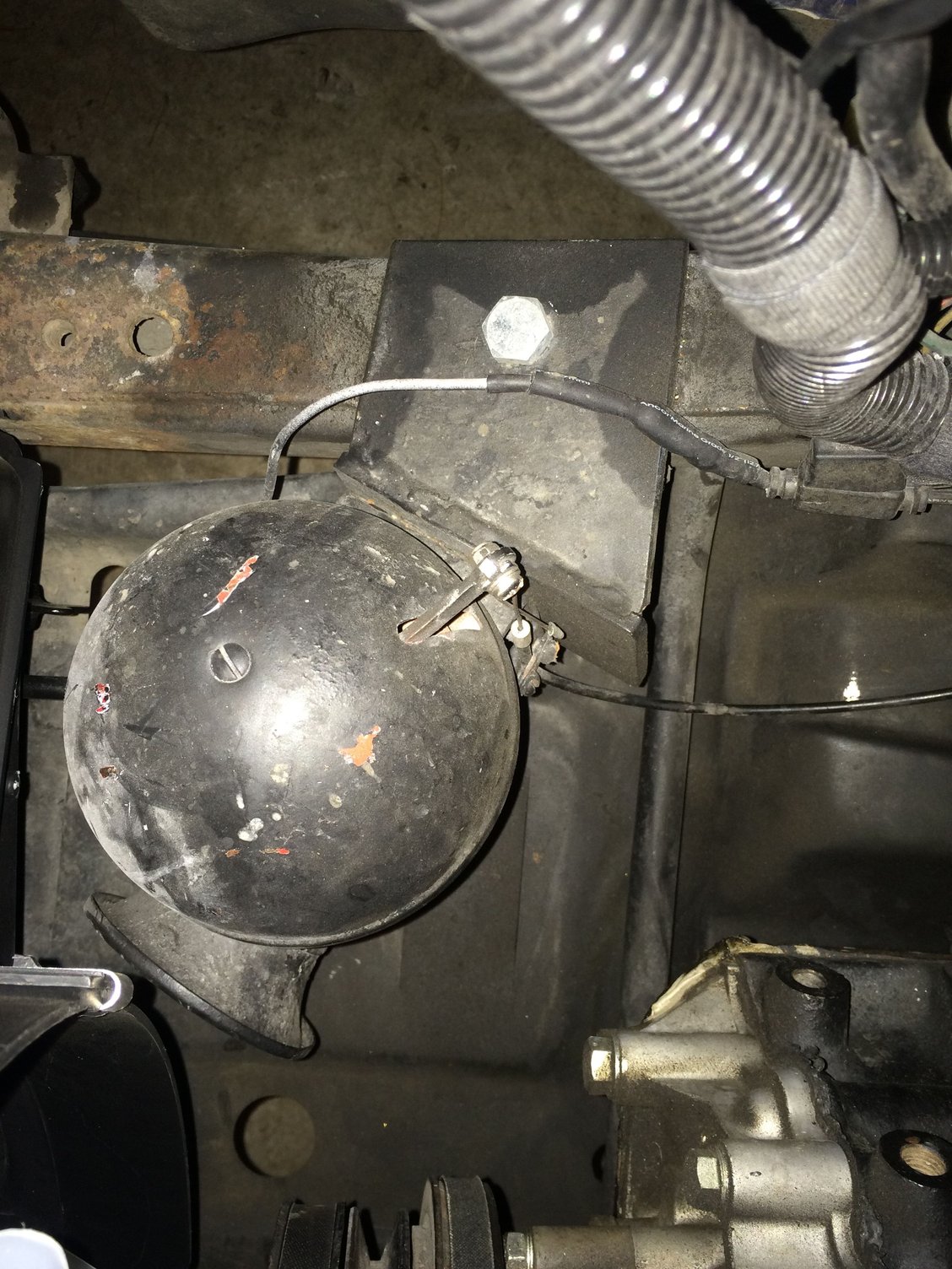

I found an old lever actuated OOOOGAH style horn years ago, built a bracket and mounted it to the frame rail near the radiator. I used classy old bike shifter and cable to actuate it. Love tooting my own horn...
