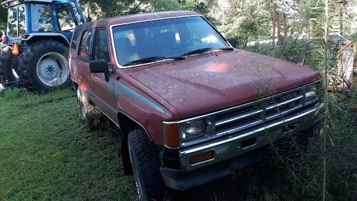

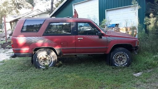

So I found an '89 Toyota 4runner, 3VZE, auto trans that I could get for free/scrap price from a friend. It has been sitting for 8 or 9 years outside with a blown HG. However he also has another 3.0 out of a parts pickup (unsure of year) that used to run good, has 80,000 miles and would need new seals. My goal would be to switch motors and use it as a daily driver. Are V6's like that even worth fixing? Also what kind of fuel mileage should I expect? I am going to go take a look at it sometime is there anything in regards to frame/ body rust etc that I should especially keep an eye out for?

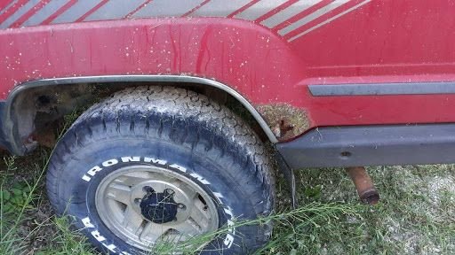

It's a 30 year old four wheel drive, suspect and inspect Everything for abuse! If the frame plugs aren't intact expect the frame is full of mud. See the rust spot on the fender, there is a similar point in the frame behind here that tends to collect dirt and water and proceeds to rust. This happens just from normal on road use where dust collects and blocks drain holes, if it's been in muddy water and not cared for it's worse.
