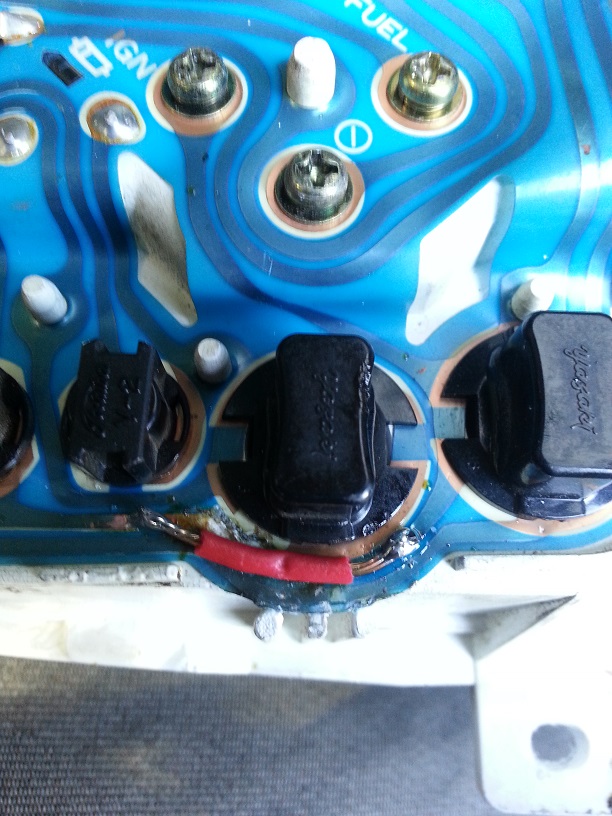

Old Aug 9, 2014 | 07:06 PM
weaselman's Avatar
Joined: Mar 2007
Posts: 642
From: Renton, WA
here was the problem. no power to any of the gauges.
repaired!
