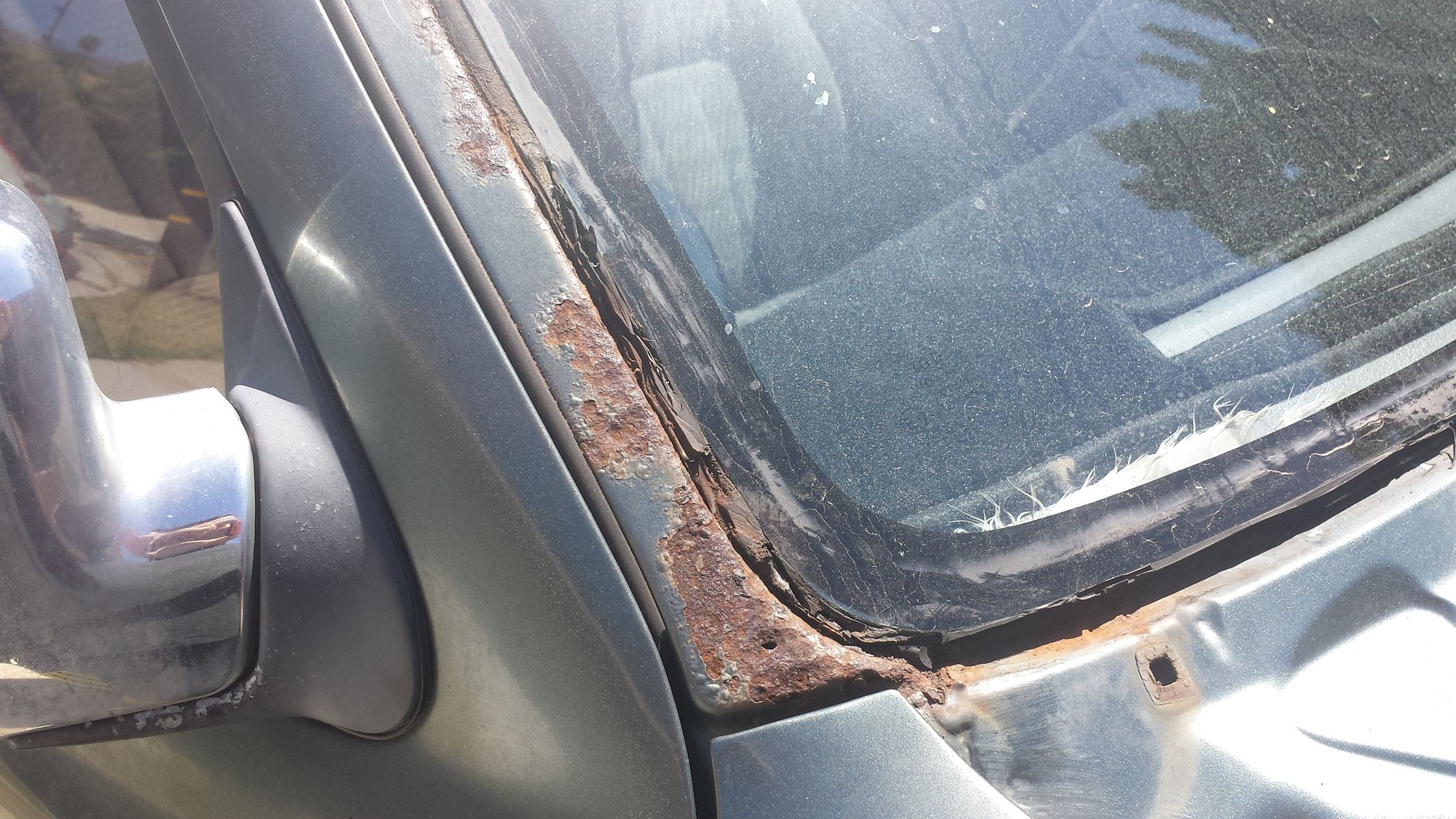

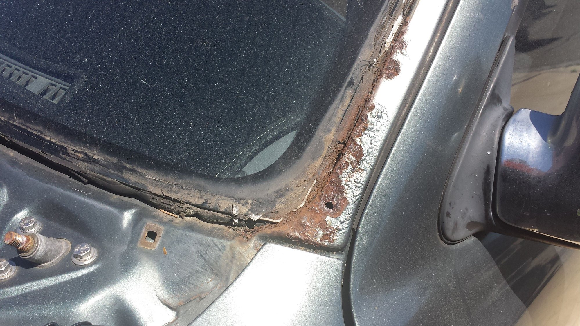

Ok, I just ordered a quart of the black semi-gloss POR-15 and a quart of the pre-cleaner / etcher which as per some YouTube videos shows what it does and how it needs to stay wet for 15 minutes or so to "do what it gonna do". (I got full quarts since I'll be doing a trailer soon too..I'll just have to be careful with sealing the can as I saw on a video that it is a big issue since this stuff is like hard glue). I also see on Amazon several options for urethane adhesives from Sika, 3M, and Dow with Sika being the cheapest in cost of the 3 major brands. I also noticed most of them say primerless so should I assume that if buying that type then I can just skip out on added primer? Much like some of the newer paints from Behr at Home DeepHole they are making a lot of "all in one" stuff these days. Better living through chemistry I suppose. Also attached are images of what I'm dealing with. It wasn't nearly this bad a year ago and then suddenly took a nose dive. Mother nature is a real bitch! Holy Jesus!
OMFG!
Old Apr 18, 2018 | 04:33 PM
  #205
RAD4Runner's Avatar
Joined: Mar 2012
Posts: 7,125
Likes: 681
Originally Posted by MudWaspSR5
...Holy Jesus! OMFG!
LOL! You are not alone. We've seen worse. You may also notice that rust is worse around where the clips are because moisture and dirt are more likely to pool there.
Mine was not to bad - only one tiny pinhole- but I could grow pot on the dirt that collected there - LOL!
