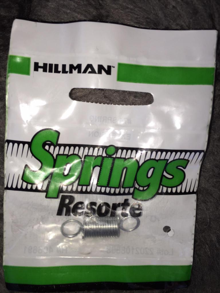

Originally Posted by dieselloco427
seems like my problem is exactly the same as what happened to 93toyrunner. I had to push down on the lever that the return spring was attached to, pull the lock up and then pull the handle and tada! door opened!! Now its off to the various hardware and auto parts stores to see if I can find a replacement spring... I'll upload some pictures once I find my camera...
Edit: PICTURES!! if anyone cares...
Broken spring and latch assy:
Broken Spring and New Spring - which is a little longer but works just as good (ACE - the helpful place - and yes they do have almost everything!!):
New Spring Installed:
Plus I re greased everything...

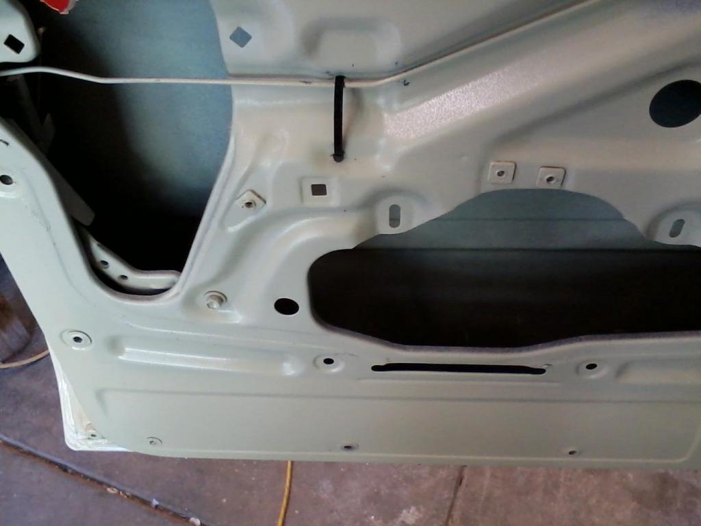

Hi, I don't know if this is related, but was having a problem of not being able to open my door. Now I just can't open it from the outside - when I took off the door panel, this is what I found:
Sorry the pictures aren't very good, I could try to get better pictures later, but basically...there is a rod/thing just laying there. It is the reason my (crank) window wasn't rolling all the way down, it was in the way.
I think it's supposed to be connected somehow to the inside of the outside door handle (if that makes sense) but I can't figure out exactly how or what I'm missing.....
It's a 94 Toyota pickup...any ideas?

I know this is an old thread, but I had this problem last week and found that I was able to remove the panel, intact, without breaking any clips while the door was shut. I needed a 90 degree pick to push in the turkey-timer pin up by the A/C vent, but by moving the seat forward and for the rear lower clips, then backward for the forward lower clips, I was able to take off the panel and hand it to my friend Bill while we was yelling at me that I had to take out the seat. Unfortunately, I ended up buying an entire latch assembly instead of just a little spring. And new door locks.

Once the panel is taken off or off enough to access the rear inside door panel, you can open the door by using a long stick or screwdriver and press the lever down (where the arrow is) then the door should open. The circle is where the spring belongs on the two little hooks inside.
I bought the spring at OSH for about $3.
The spring allows the door lock to unlock. When the spring is broken, the lock thinks someone is pulling on the door handle so the lock wont unlock. The lock actuators are trying to unlock the door (if you have electronic door locks). By pushing the lever down (arrow), doing this does with the spring does and release the lock safety, but when you open the door using the handle, the spring release the safety lock so the lock can't unlock the door again without the spring being in place or pressing the hinge on the arrow.
Clear as mud..right?

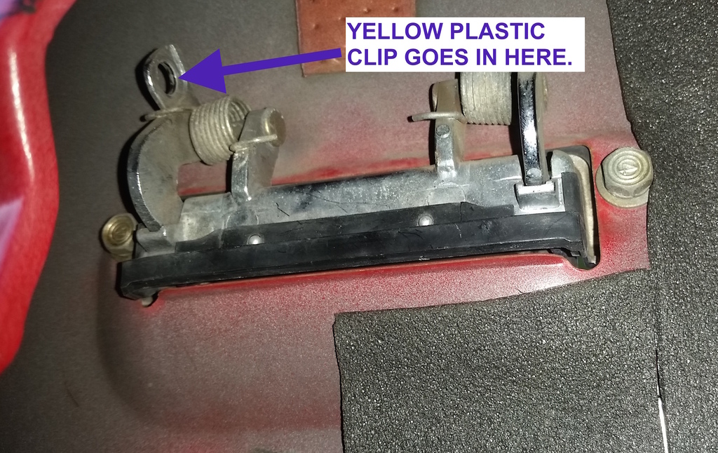

The yellow clip that attaches link rod between outside door handle and door latch mechanism on my truck broke. I searched for replacement from online stores but no luck. Does anybody know of source for replacement for this? If not sold as part for the first-gen, perhaps it's interchangeable with that of later gens?
If you have one handy used or new, would you consider selling, and how much? Here are pics:
CLOSE-UP
It goes into here:
If no replacement can be found, does anybody have a clean and robust solution?
If this part is accessible enough, I could probably make some sort of a a collar that locks to end to rod with a set-screw, But rather tight in there.
TIA.

It looks to me like it's P/N 69293-12040, from this drawing http://www.toyotapartsoverstock.com/...rimLevel=18406
I googled that PN and found a couple of sources for it. Whether or not they actually have it is another matter. Hope this helps.

It's a pretty generic part (there might even be a Dorman version at your local parts store). It looks like there's a left hand and right hand version. So get 'em both!
http://www.ebay.com/itm/like/361225336493?ul_noapp=true&chn=ps&lpid=82
(What, you only want one? No you don't. If you drop one inside the door, you can't use a magnet-on-a-stick to get it out. Stock up!

Needed to get it fixed right away so I just got one from the dealer ($5). Replacement procedure was quick. A few pics here.
Terry has more on removal of the latch assembly itself.
