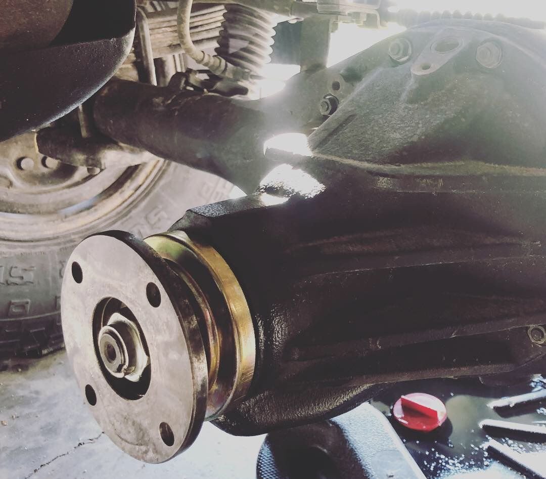

From: fort smith, arkansas
The rear diff work caused my pinion seal to start leaking slightly so today I changed it out with a new eco seal from marlin crawler and a new dust shield because my old one was slightly warped and rubbing a spot on the casing. Straight forward, too many threads about it for me to post any step, getting the old dust shield off took a few hits with a hammer though.
Also got my sliders put on. Man the body line sits low on the frame with these things, not much room to mount.

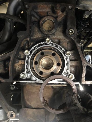

clutch install
my near rear main came in just before the weekend kicked off so I replaced it along with the new clutch components, and unmated the tcase and transmission. I had planned on removing the piece that the rear main fits into, completely forgetting that the oil pan is snug up against a piece of 2x4, so I went the route of prying the old seal out with a small flat tip and tapping the new seal in. clutch install was cake, the new pressure setup should be a night and day difference.
old and busted
new hotness
little bit of paint
new parts
torque to spec
started to polish up the tcase, and did get it divorced before i quit for the day.
