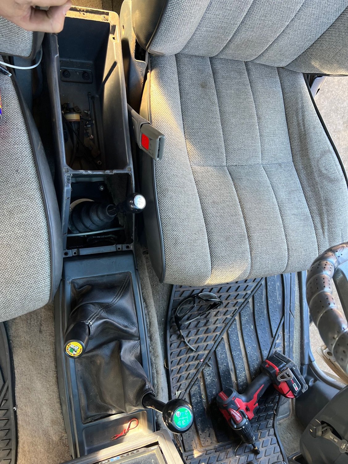

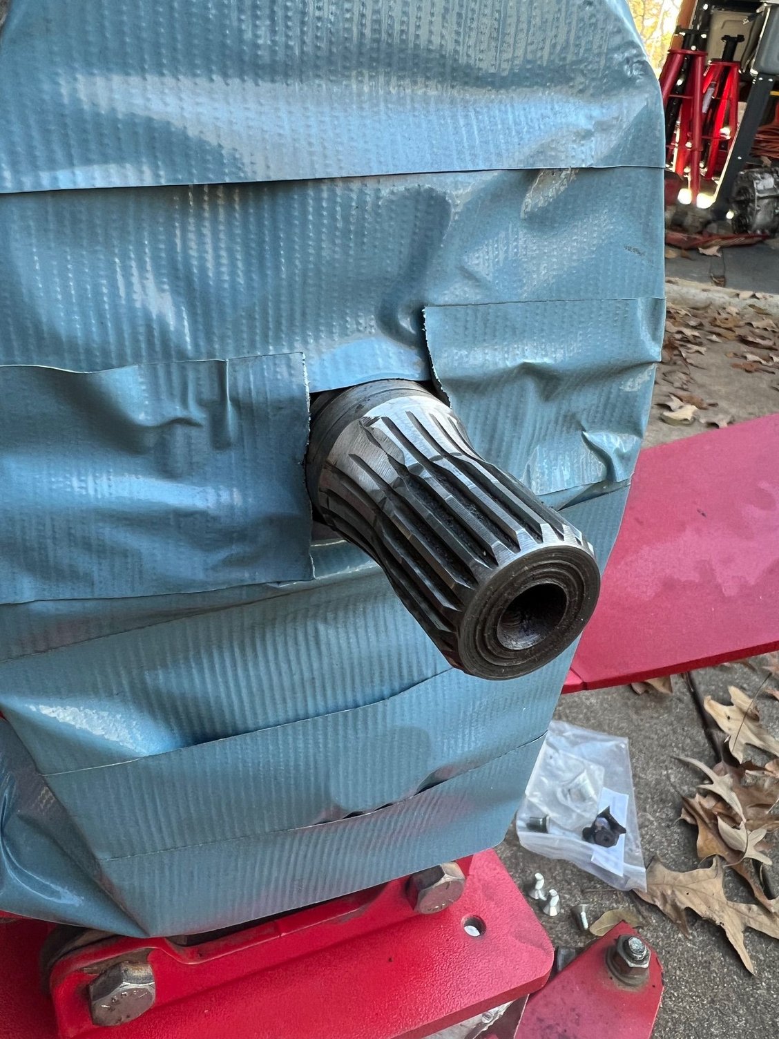

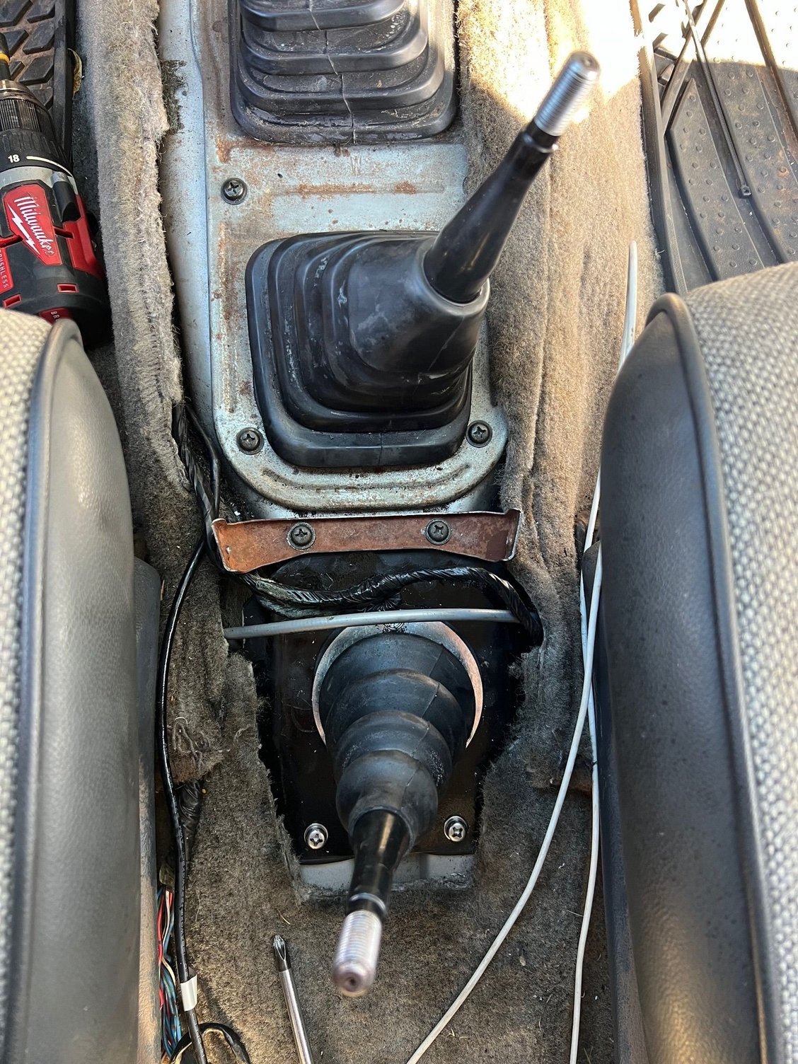

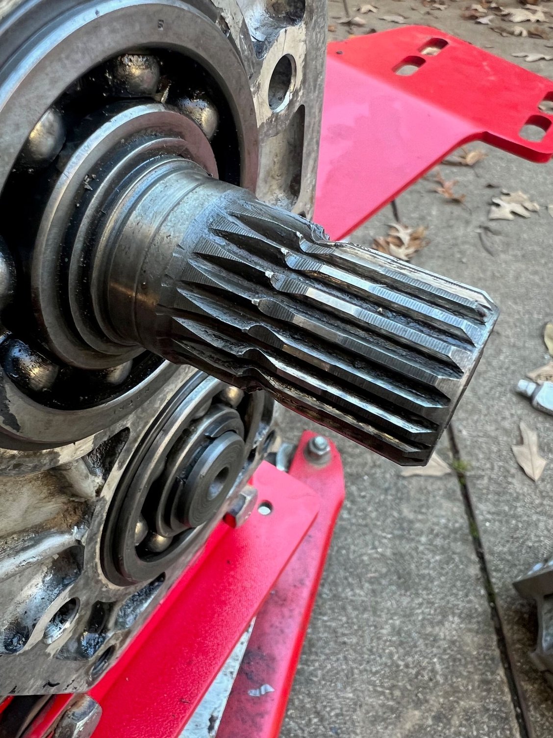

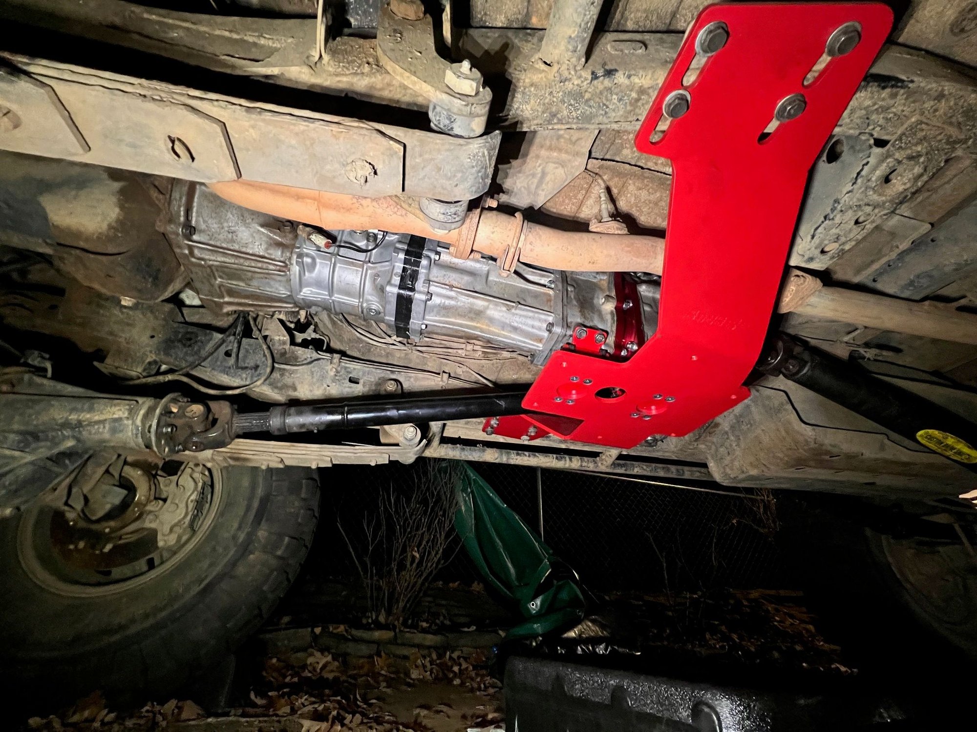

lots of work done over the past month and i havnt posted anything. i built a set of dual cases. i had a local shop rebuild my marlin transmission, had driveshafts modified, and installed everything with a budbuilt crossmember. i used a stock front case, mc08 adaptor, and a 4.7 rear case. no twin sticks. driveshafts were 5.5 inches shorter/longer. cut my shifter hole big enough to get the shifter plate in and out of, then made a cover plate and put some m6 rivnuts in the floor and bolt it on with oem fasteners, used bulb style weather seal underneath it. everything works great but ill need to shim the rear end up a few degrees because my driveshaft angles are around 13 degrees and i have a little vibration at speeds. only issue i hit was one of my cases had a 79/80 output shaft and i didnt know there was a difference. he met mr grinder and we fixed his attitude.
loaded up
79-80 shaft with longer splines
splines gone..
shifters going in
done
installed

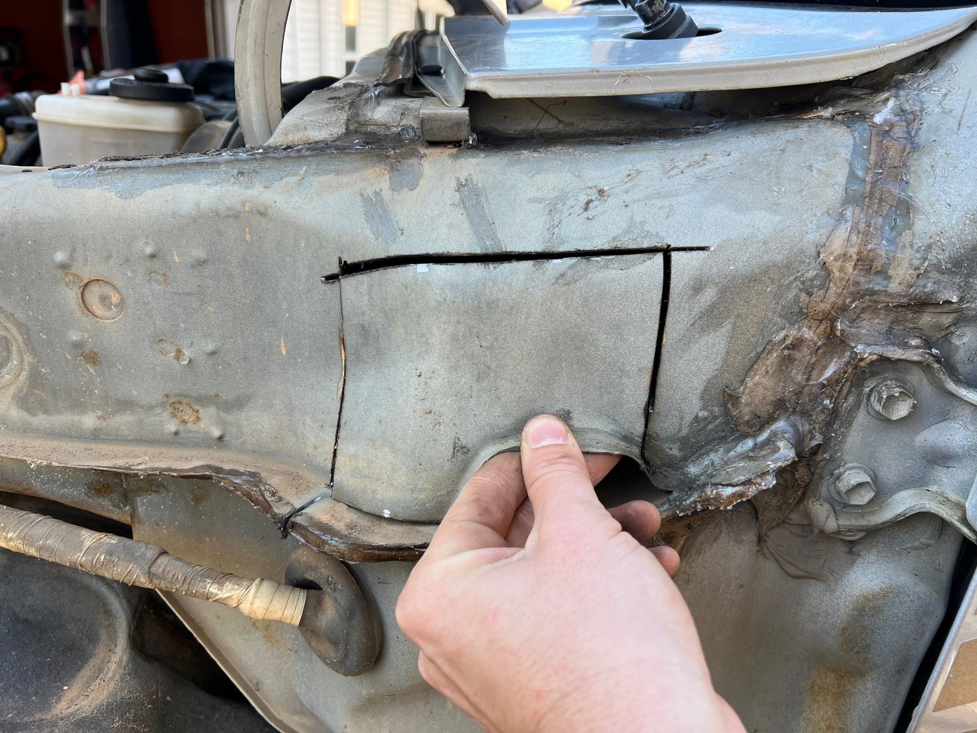

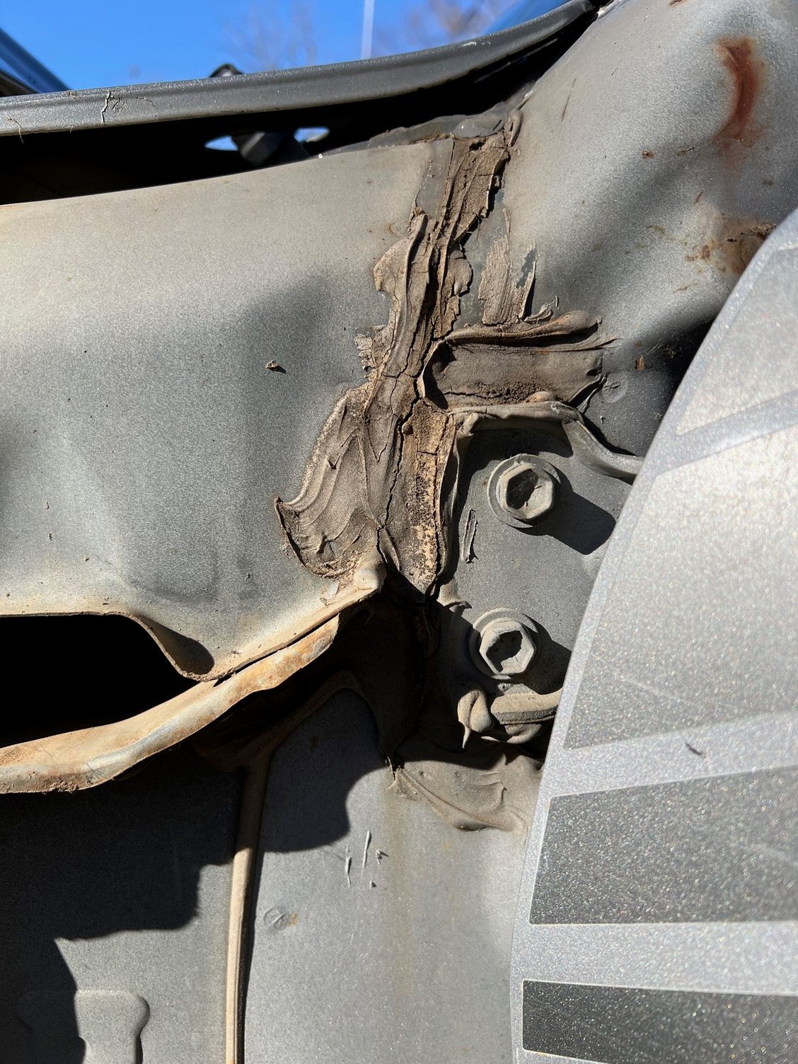

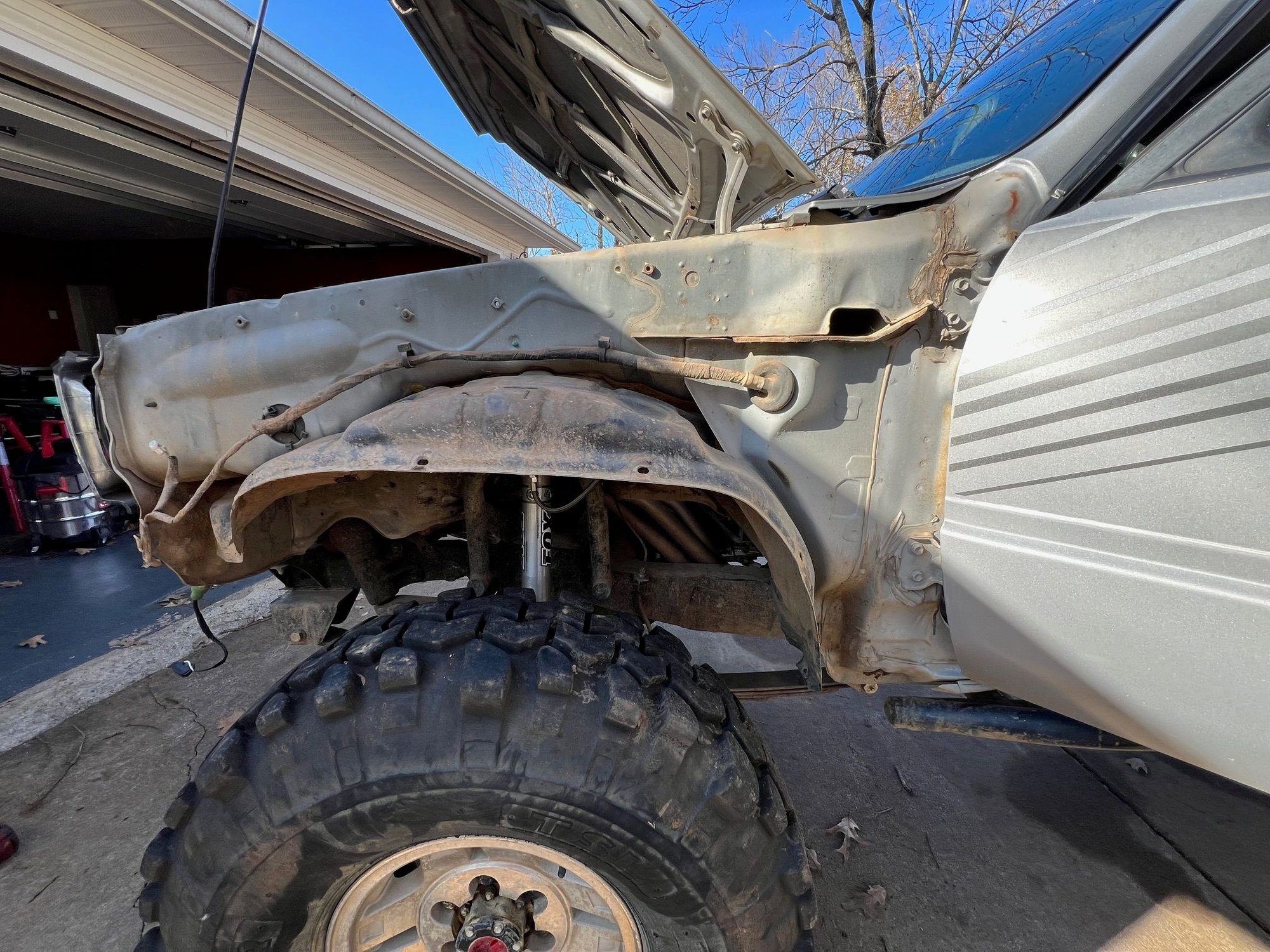

this weekends project was pretty sucky. i recently discovered i had a rain leak. i found that my windshield was leaking, and decided to ditch the trim and go back to a rubber insert and glue to try and save myself some rust issues. that fixed one leak but i had another. the dreaded firewall/cowl leak finally got me. man what a pain. if you are seeing water in the floorboards or on the firewall chances are its the seam sealant in the cowl. its old, its brittle, its gone. i pulled the fenders, and cut access holes in both sides big enough to fit my arm inside. resealed all along the edge and the outside seams under the fenders. i used a quality body seam sealer from a local auto paint shop. i welded the access hole back up and have her back together, mostly, at this point. i did not pull my dash, although i suspect there is rust under there at this point. after i welded the access covers back i seam sealed and painted over the welds. its not color matched but its under the fenders and i really dont care. i made sure to try and get seam sealer over all of the cowl areas and anywhere i was cracking oem sealer.

Well. There goes your cup holder lol.
iSorry I'm a bit of a dullard, but I can't find why you had to grind off part of the input splines?
im not super set on the center console yet, that was just an old crusty spare i had in the shop. i kept my clean original one. i may pick up one of those 3d printed cup holder inserts for the console base in it now. the splines are different on the 79/80 models than the 81-newer models. the 79/80 have a little extra spline, that wont seat into a newer transmission (w56) so they have to be ground smooth to mate.

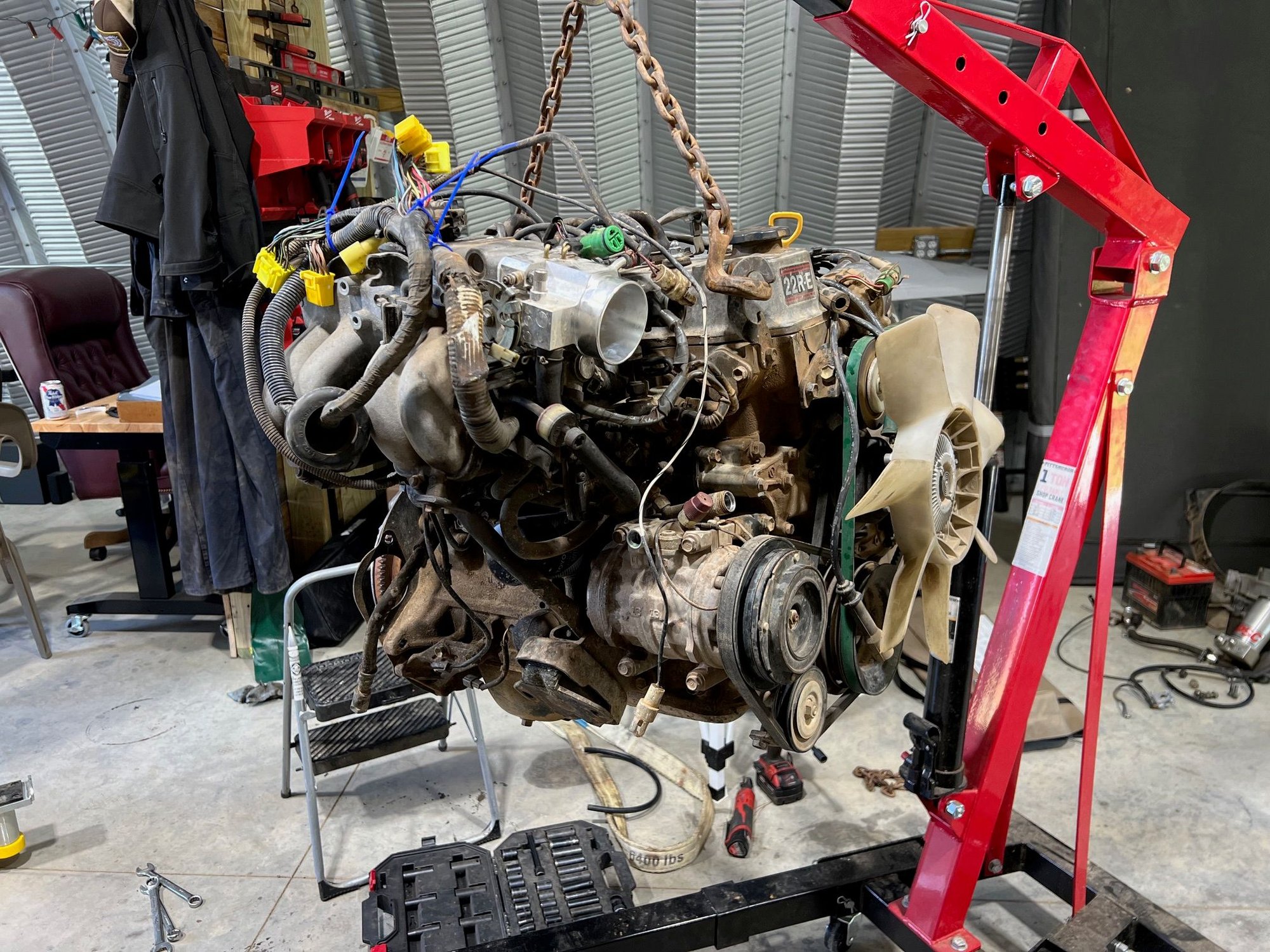

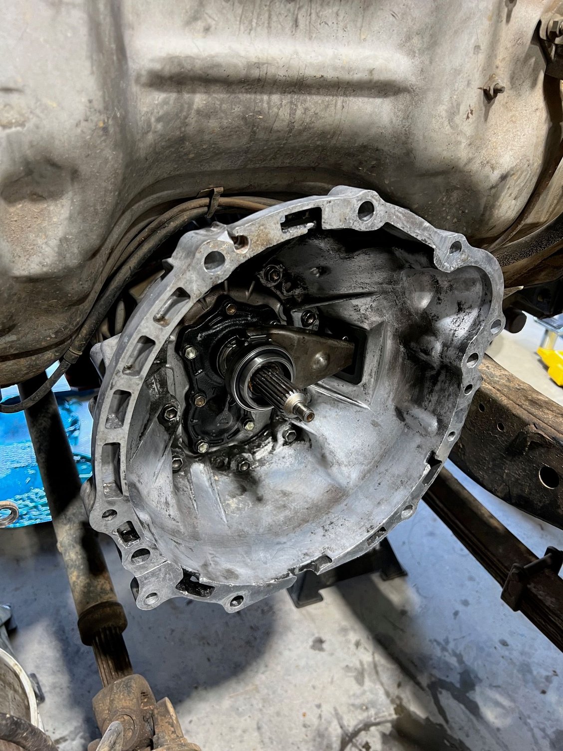

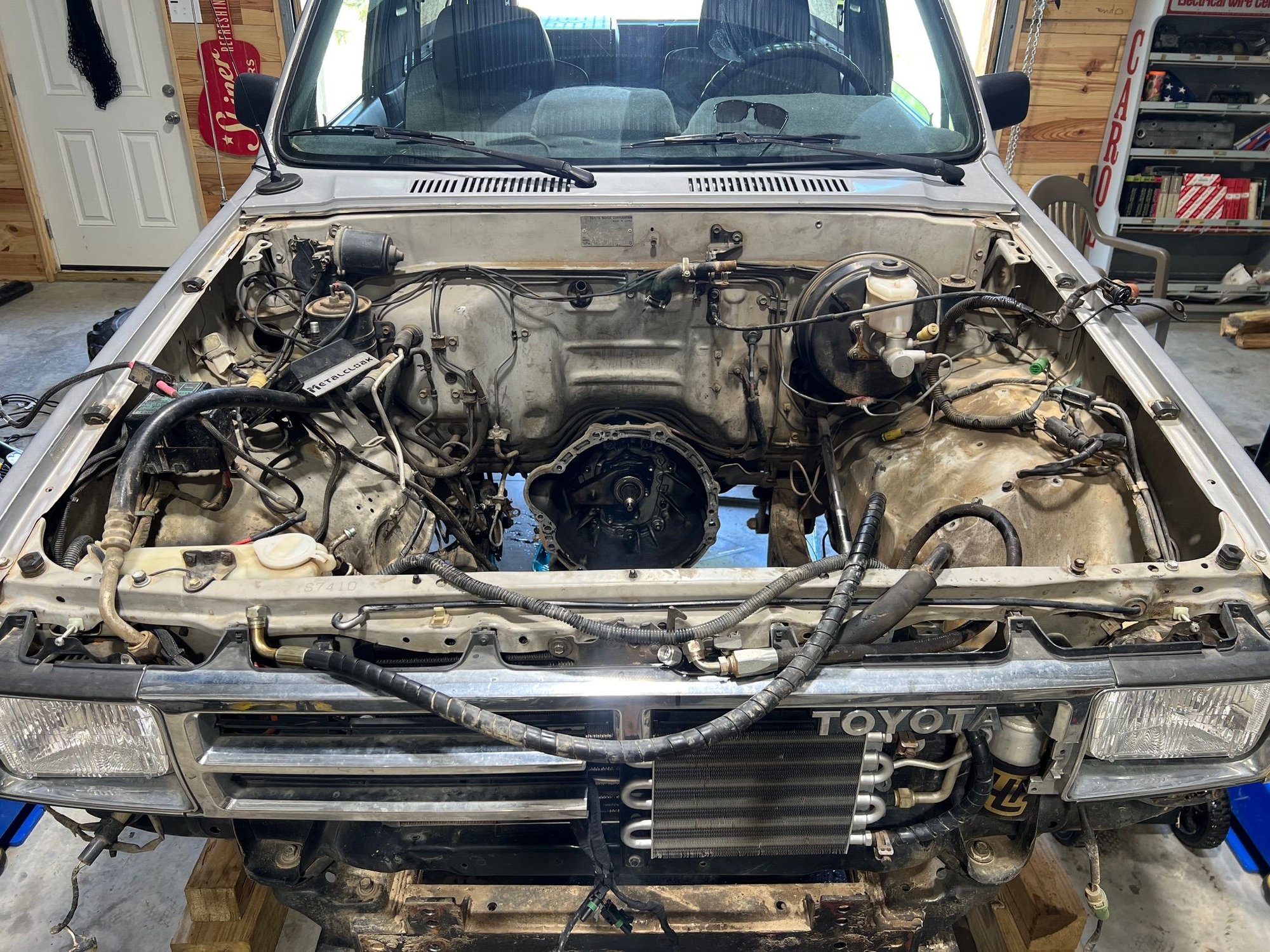

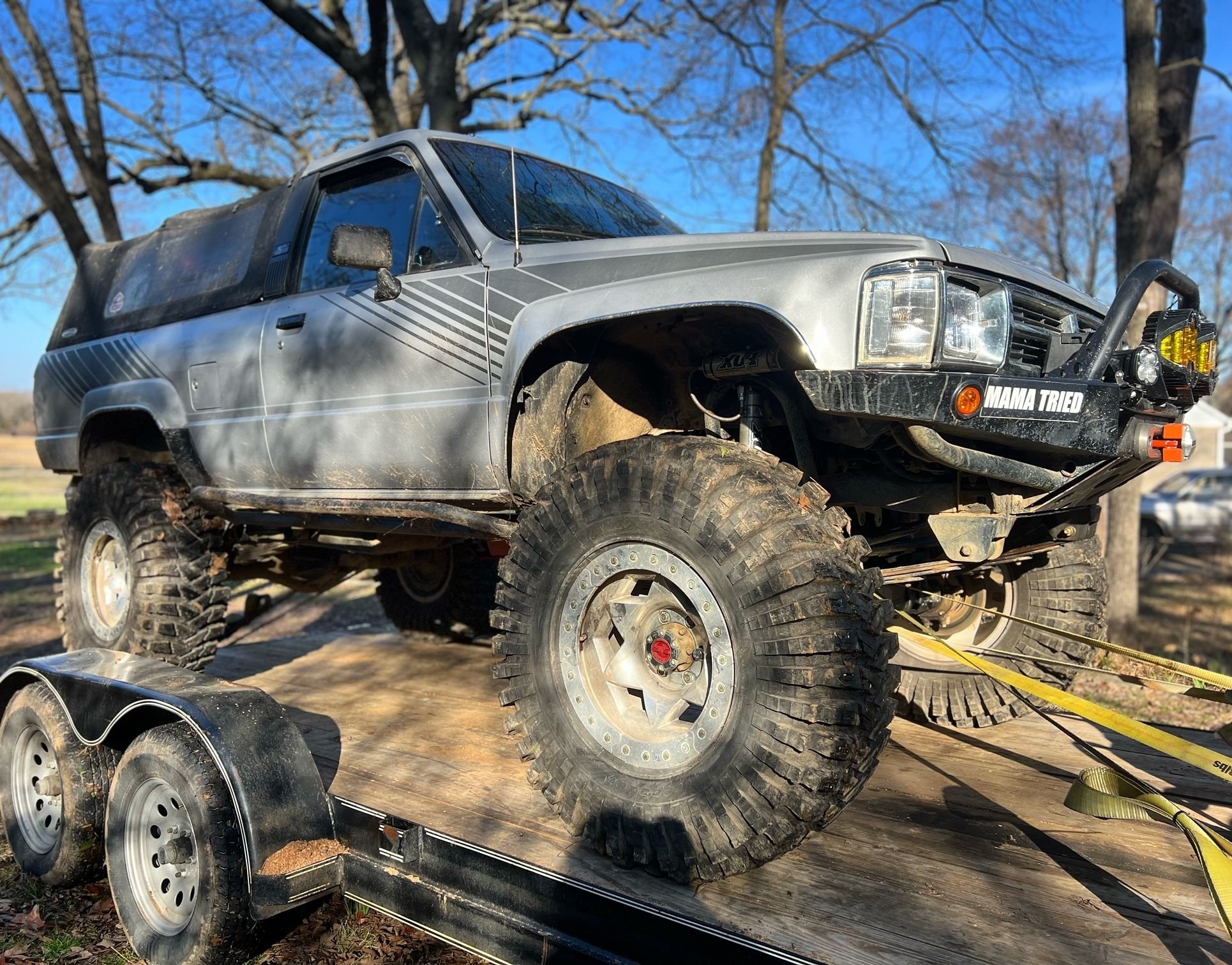

been a while, but i really havnt done anything except use the truck the way it was. i took on several other projects and had to do some big jobs on my wifes 100 series and my 40 series. i did a trip in the runner a few weeks ago and decided it was the last big run for the 22re. its time for the 3rz. lets freakin go.
last ride on the 22re
pulled her into the shop for start gutting

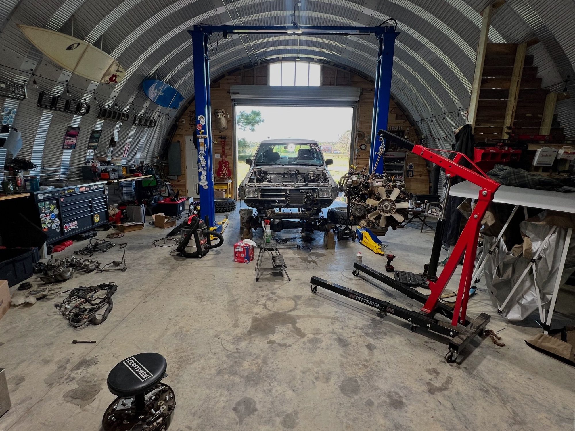

work flow
work flow
gutted
gutted

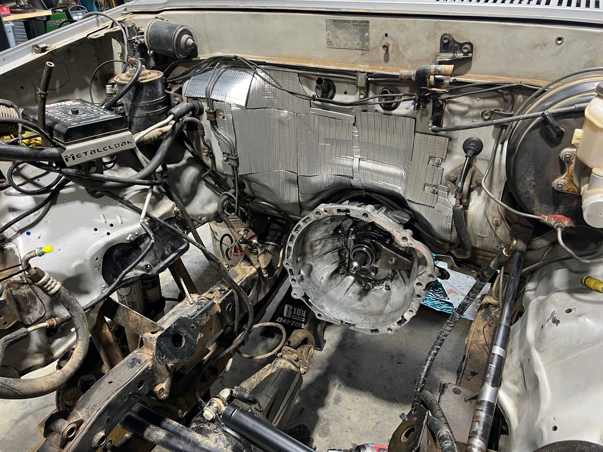

w59 bellhousing installed

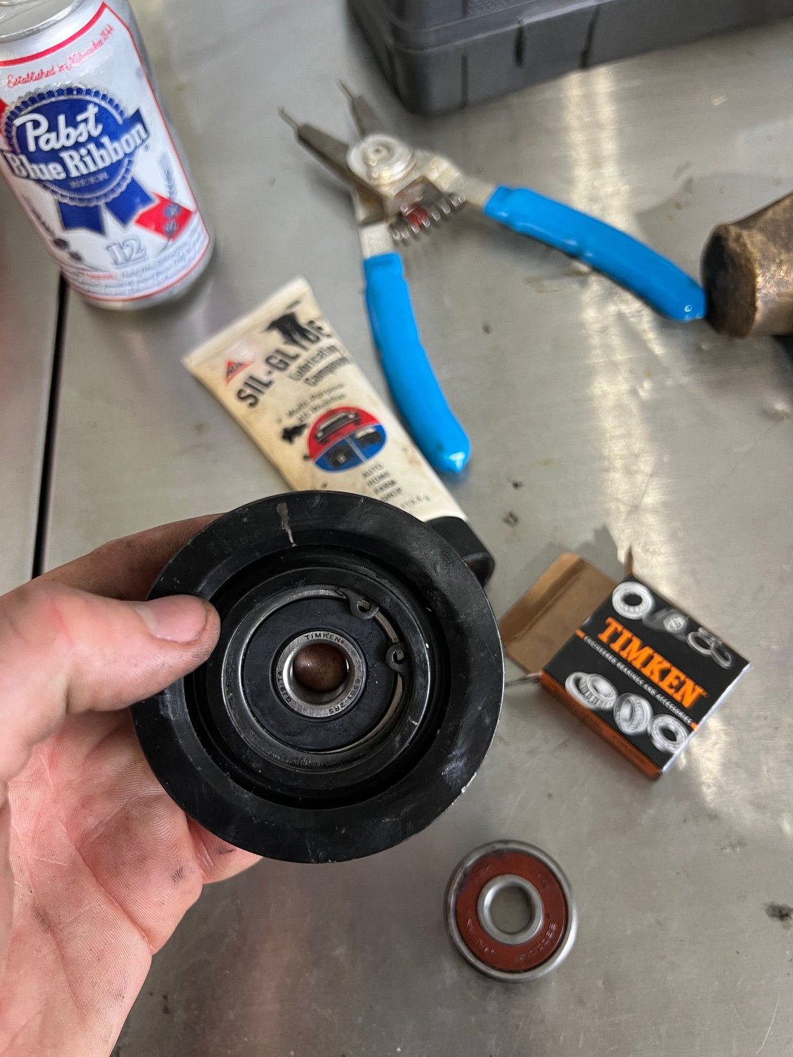

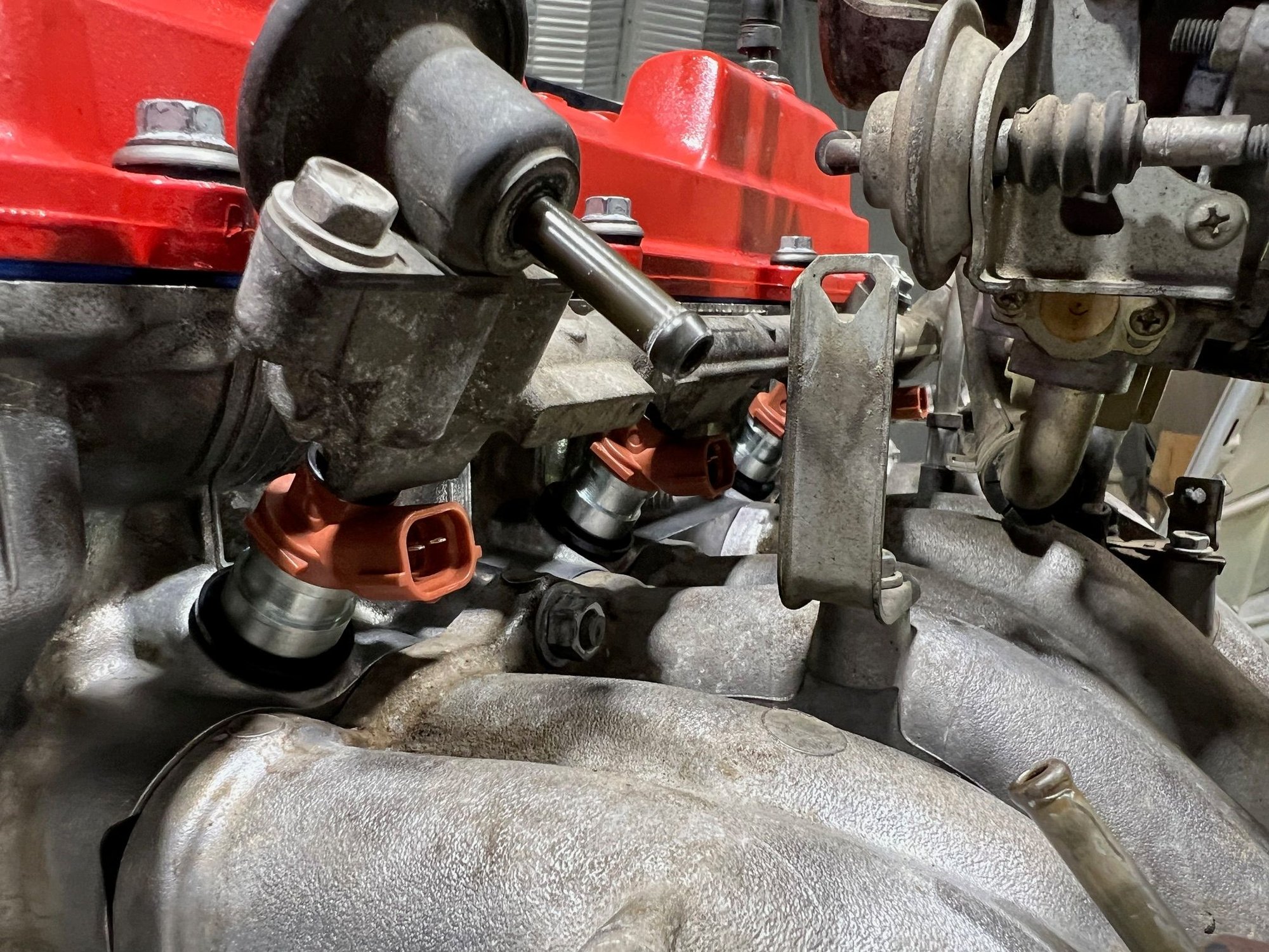

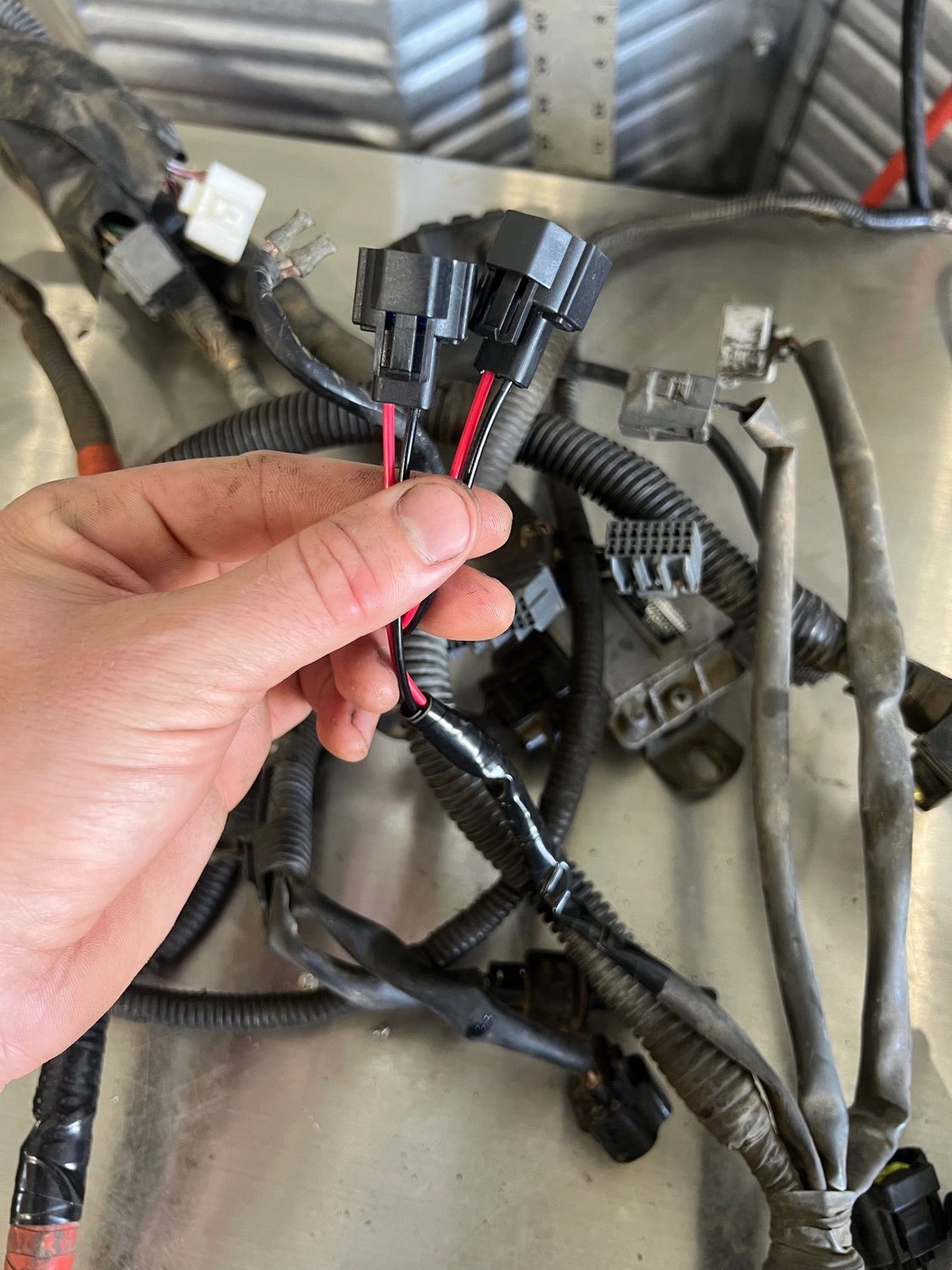

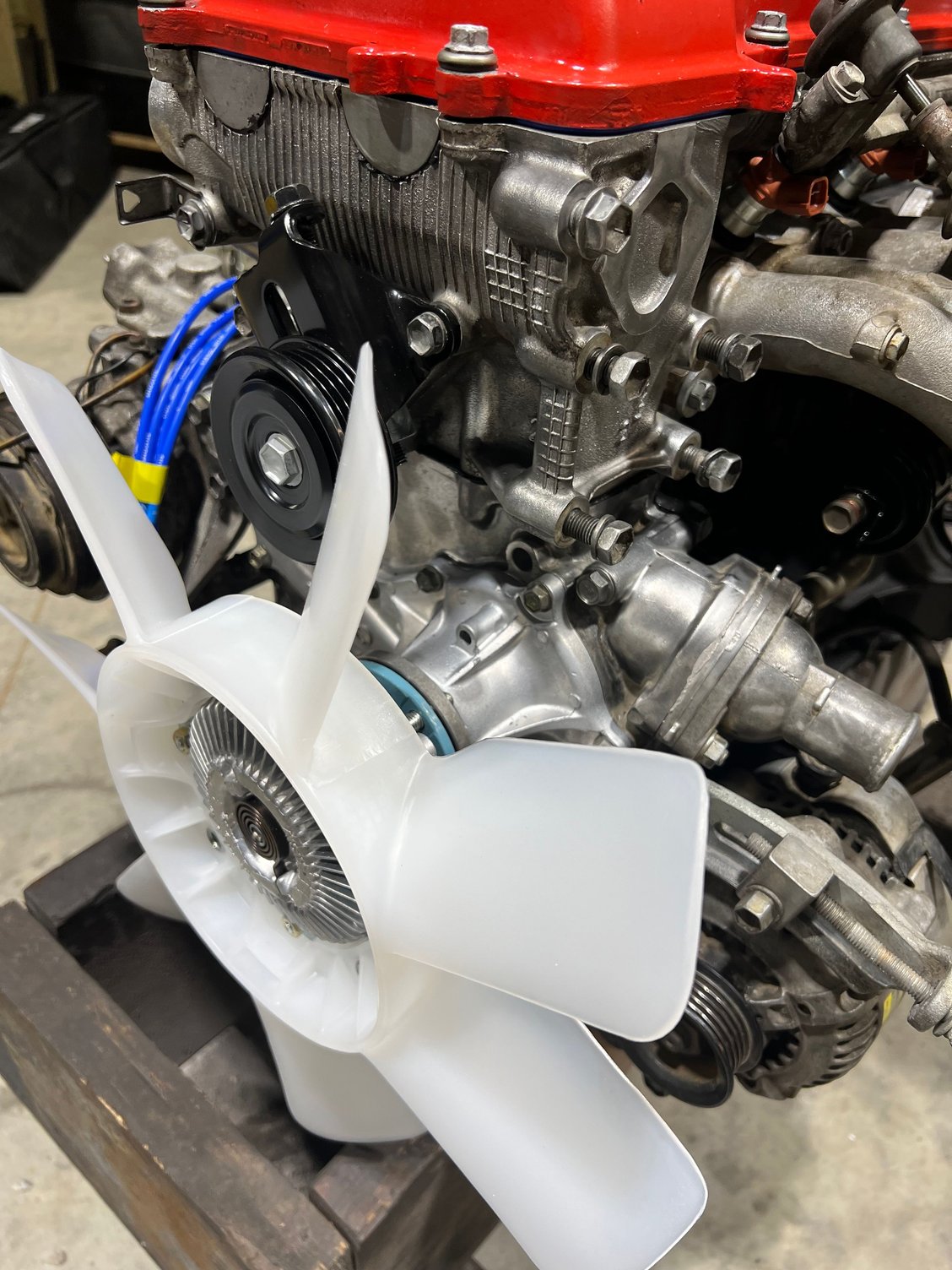

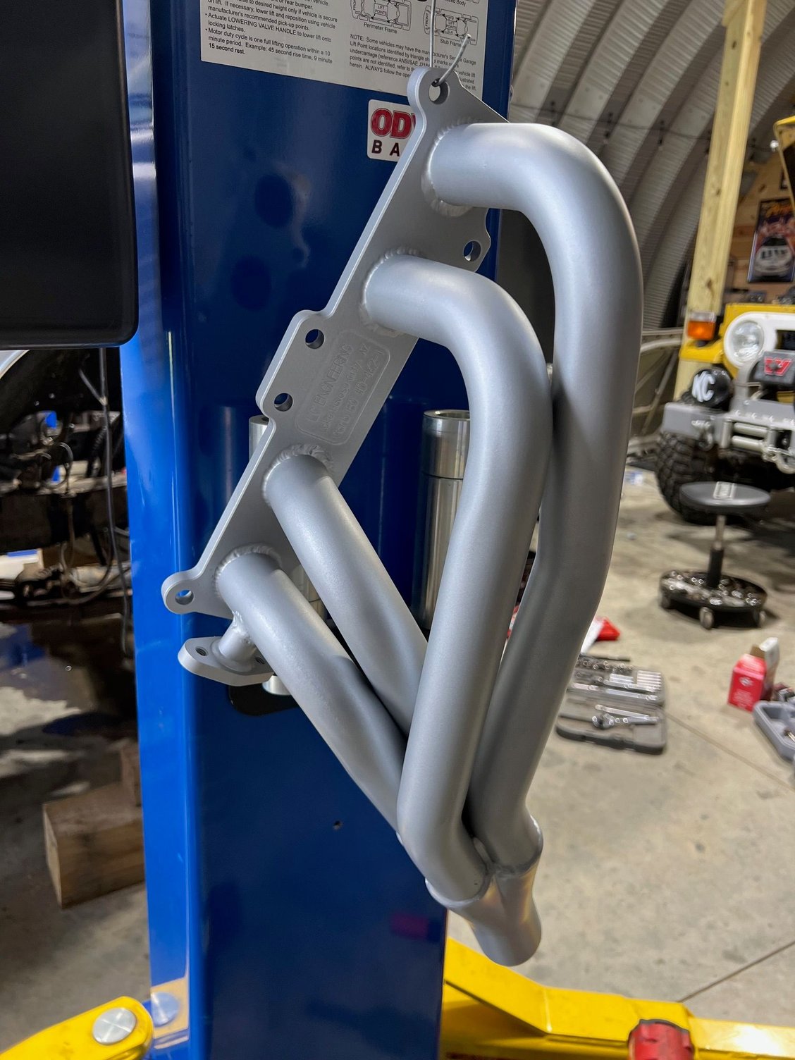

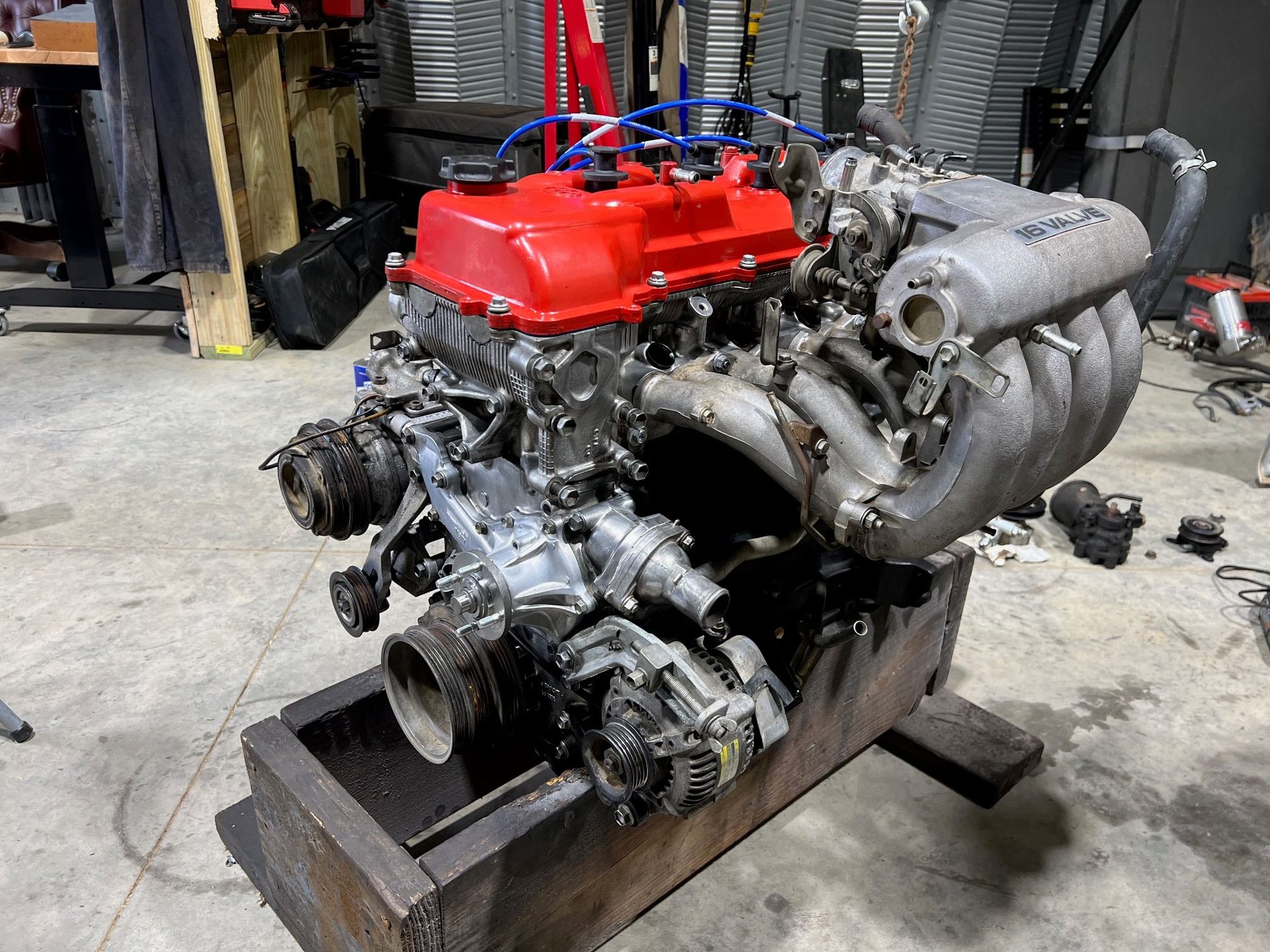

my setup will hopefully be simple and straight forward. i have a 3rz from a 96 t100 (i think) with the oem engine harness and an ors adaptor harness. the 3rz just came home from the engine shop with a fresh rebuild. i am being nickel and dimed on the little stuff like random hardware, seals, gaskets, sensors, hoses, belts, etc etc. so far, i have it mostly back together but i am waiting on new flywheel bolts and a flywheel from marlin. old marlin and pirate threads seem to indicate keeping similar components together, so i am using the w59 bell with the 3rz flywheel, clutch, shift fork, bearings, and slave. ors for the clutch and fuel lines. remaned fuel injectors are in with new pigtails on the harness. i also burned in the 10k resistor on the back on the tach this week. i plan to add an A pillar gauge pod setup to monitor water temps, oil pressure, and vacuum.
new injector plugs
new injector plugs
headers painted
headers painted
getting close to back together
some heat shielding on the firewall
save some money by using new bearings instead of entire pulleys

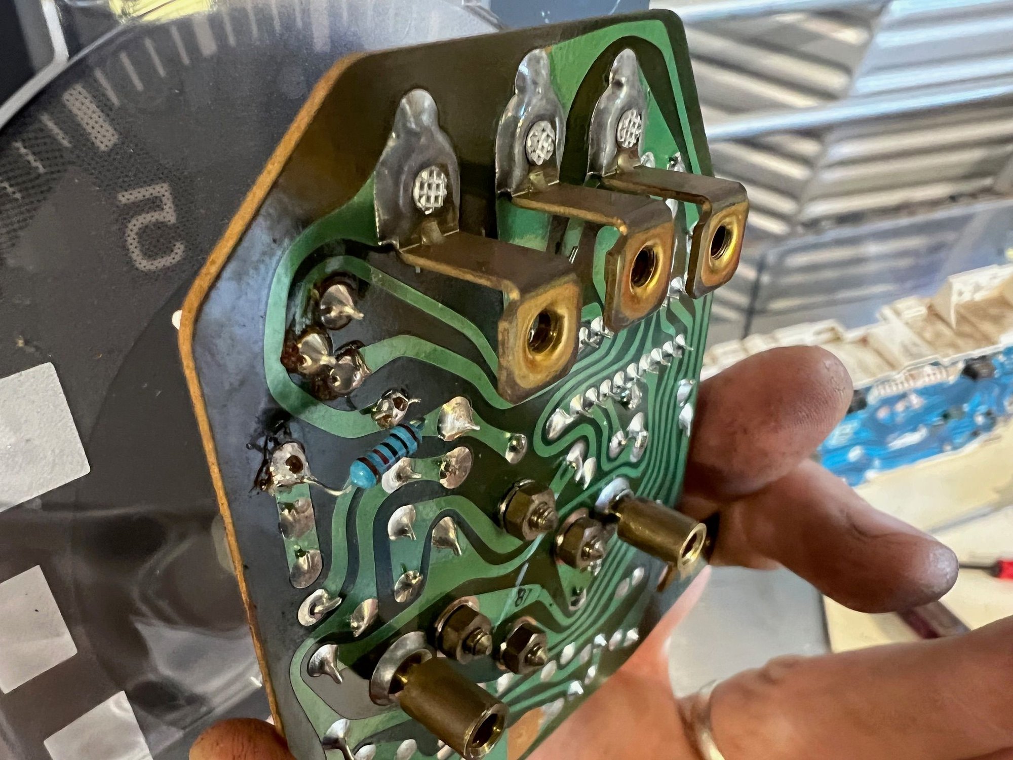

tachometer ready (hopefully)
fuel rail and injectors in

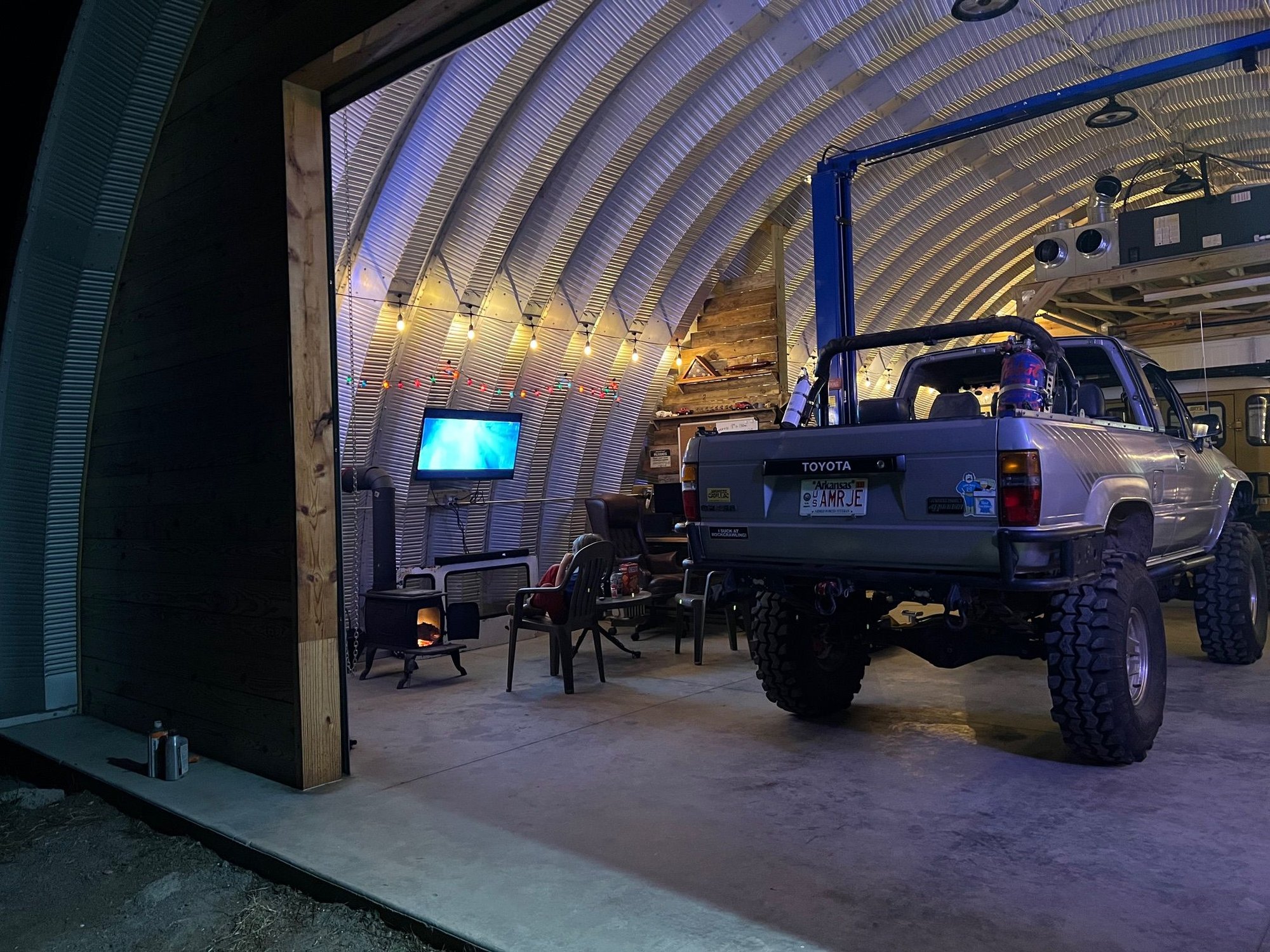

I am a bit distracted by that incredible garage

Likes: 466
From: fort smith, arkansas
haha thanks man, that was also a big part of my 2024, building it out and getting it ready for some wrenching. And beer.

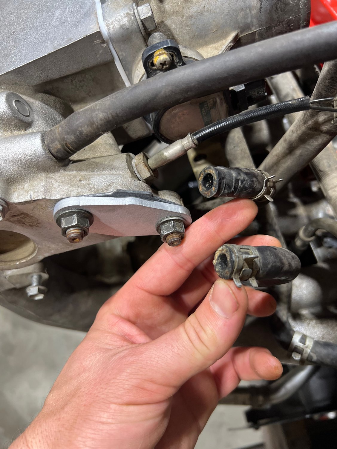

I ordered a new rad, three row aluminum from LCE. I will retain the 22re shroud. I got a new aisin fan clutch and fan blade, the flan clutch mount must be drilled out a bit to fit the 3rz water pump studs. EGR delete is on, EGR is properly in the scrap pile, I think I can use some fuel line and just loop the old coolant line in/out of the iacv ? My PSC bracket doesn’t fit the 3rz so I have a custom one on the way. Hurry up and wait.

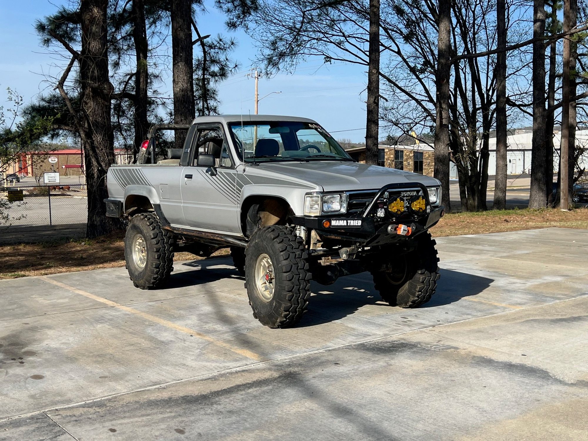

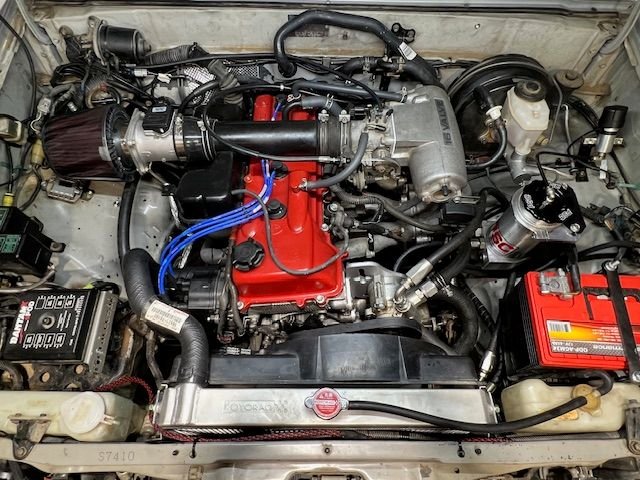

im going to skip over the dull info for actually stabbing the motor, but its was fairly easy. the 3rz sits a little tilted to that makes for a little trickiness lining up the motor mounts. motor is in and happy. the iacv was stuck and i had to pull it to get it to idle correctly. i used the psc steering pump with chilkat mount, and had my buddy at 4lofab make me a reservoir mount that goes in the factory location. oil pump leaked, so i had to pull the timing cover, impact the phillips head screws out and replace with a new oem pump, seal, and some allen head screws form lce. used oem rad hoses, cut lower to fit. the intake was fun to figure out. i sourced the factory air muffler pipe thing from ebay, which mounts to the side of the head for stability. then got a cheap MAF to cone filter adaptor and slapped it all together. the air is pretty warm at the filter because of the headers, i need to fab a little heat shield somehow. for exhaust, i had my local shop make a crossover pipe behind the bellhousing that is removable. both 02 sensors are in, i used one of those little mini catalizer things on the rear 02 to trick the engine into not throwing codes, works great and cost 25 bucks. it just screws into the bung and the sensor screws in on top of it. anyhow, heres the engine bay. also slapped a useless oem trd oil cap because why not.
this swap was so worth it. the truck is so fun to drive now, plenty of power and keeps up with traffic easily, merges onto the highway good, hits 80mph with ease, and has obd2 which is awesome. if anyone is debating this swap, just do it. i honestly will never understand sinking money into trying to get power out of a tired 22re when you could just do this swap for probably the same money.
