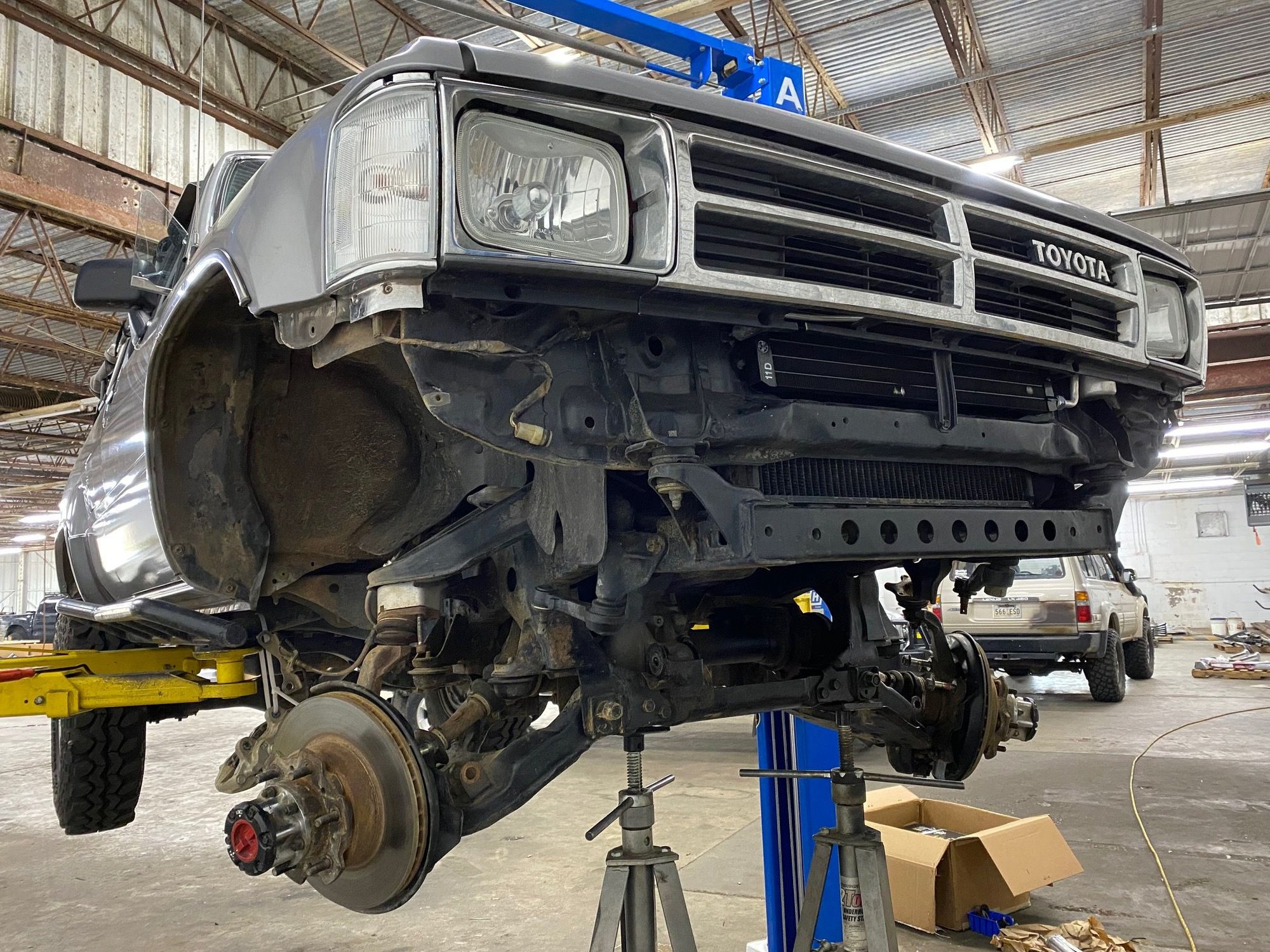

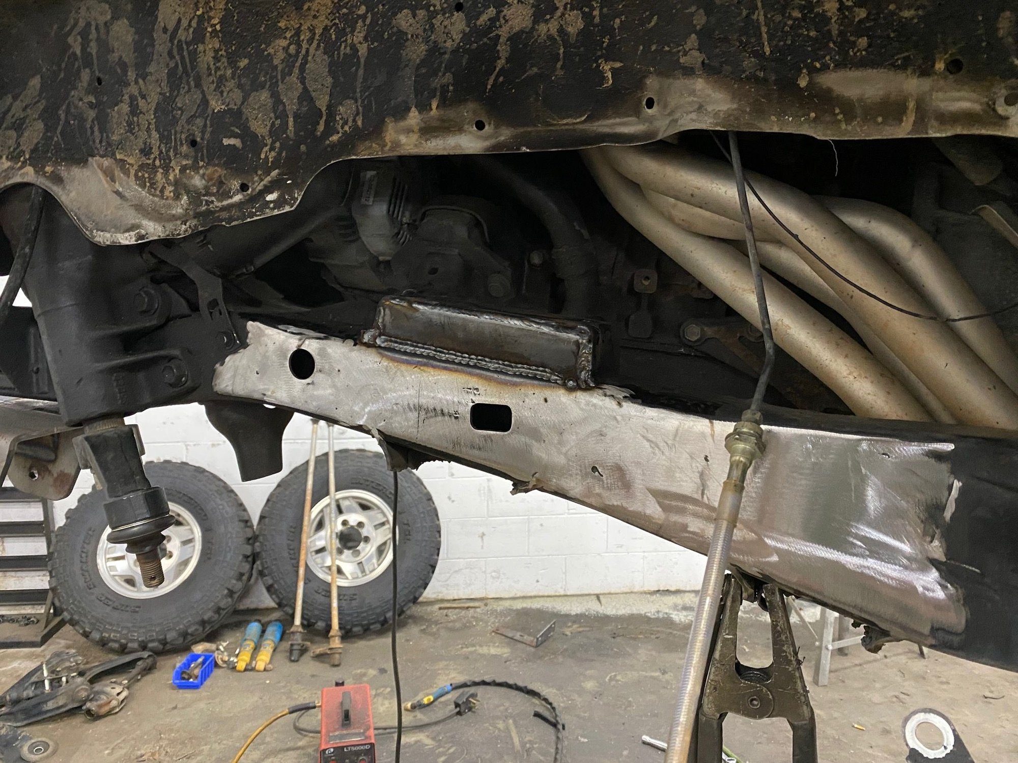

started on my SAS on saturday. worked for about 5 hours and then got another 5 hours in on sunday. all in all i feel like i got alot of work done for about 10 hours of wrenching. id say grinding took most of my time, and cutting the frame tubes was the most time spent on any single item. i thought i could use my plasma to cut the holes, but there is some sort of webbing inside the frame at the area for the tubes and i ended up having to borrow a friends torch to burn it through. i am using Sky 3F spring packs. goals here are simple, still keep my truck looking clean and good, keep it as low as possible. but gain the offroad abilities to stop destroying my IFS when i hit the trails.

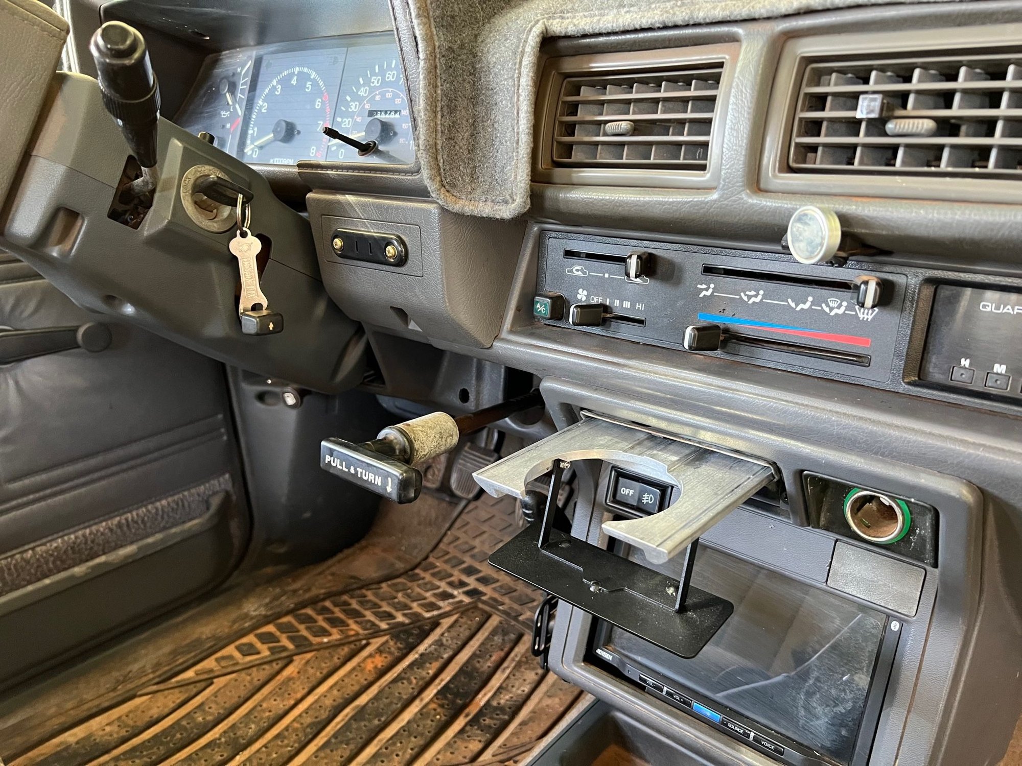

other than that, i havnt been active on the site much because ive just been driving the truck and enjoying it. i took her to toyota jamboree a little while back in texas, was a blast. i ended up needing lower tcase gears for my tire size so i pulled the case and dropped it off, had a set of marlin 4.7s slapped in. great low range now. i also snagged one of the retractable cup holders from caribou a few weeks ago. its a pretty slick little doodad.
at jamboree
cup holder

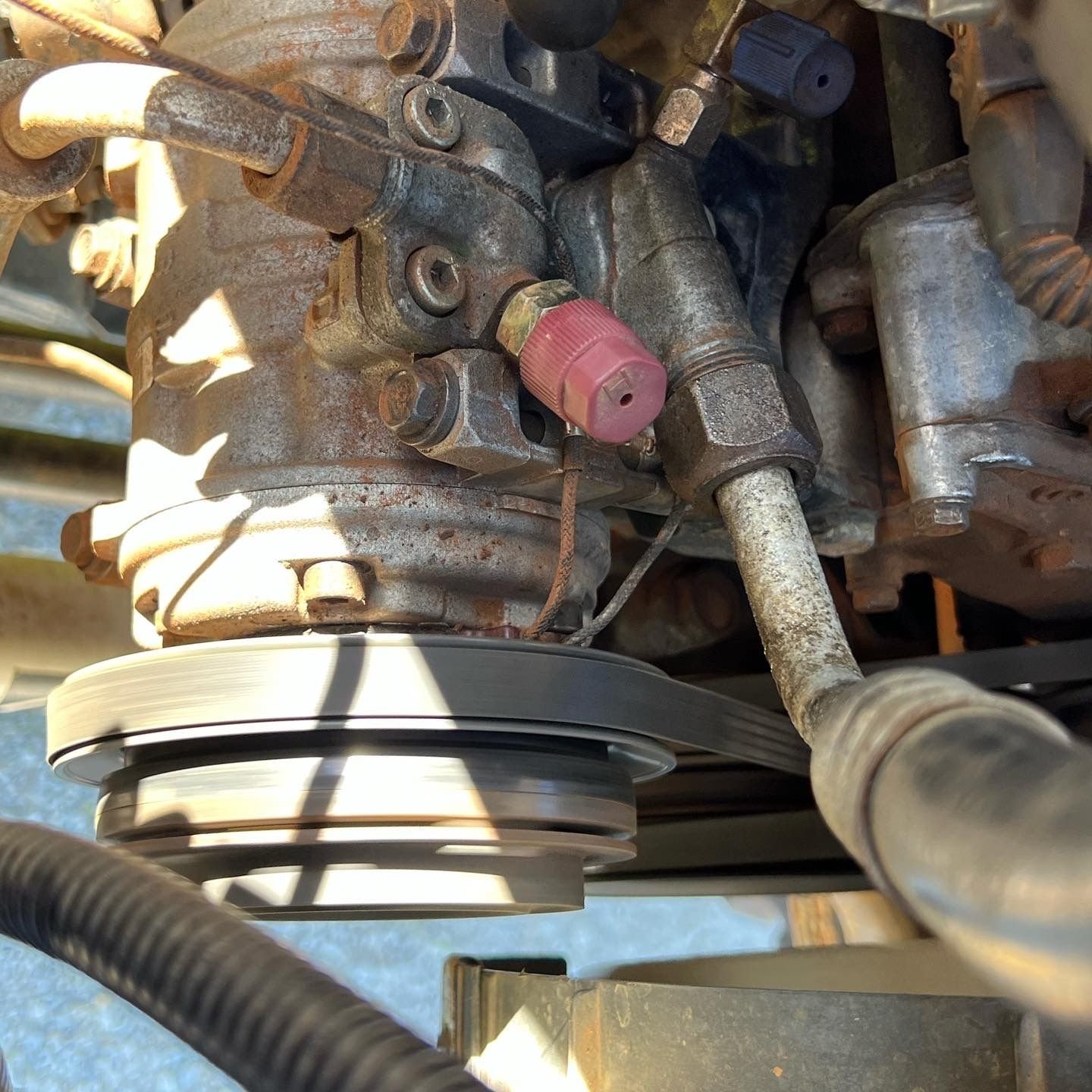

wanted to follow up on my AC system install for anyone that was using this thread as inspiration. i replaced my brand new denso expansion valve with another denso brand new expansion valve and swapped my dryer around the proper direction, and had the system vac'ed and charged. it kicked on and was working, and then i remembered i never hooked up the vac lines on the idle up valve. i had to use a T in the line from the PS to the valve and then to the throttle body. now the system is working great.
to recap on parts and the job in general
i pulled the complete system from an 88 pickup.
bought a new compressor, evap coil, condenser, thermistor, expansion valve, dryer, almost all denso parts, from rockauto except for the thermistor. MAKE SURE YOU GET THE RIGHT COMPRESSOR! there are two versions.
youll need the little mounts for the condenser up front also, i pulled some from a toyota previa. i used some lines for the dryer off another toyota car as well, i just used a hand bender to shape them as needed.
the holes in the firewall will need to be drilled. i used a step bit and just kept sizing up until the grommet fit, you can buy the firewall grommets new from toyota. youll need a third hole for the drain hose. the holes are all dimpled in the firewall for easy placement from the factory.
your harness is all plug and play, very easy. the box fits in place with no mods. just drop the glovebox and remove the little cross bar that holds the glovebox hinges. there are a combination of little m6 bolts and screws with a 10mm head on them holding the evap box in place.
you need to get some adaptors for the compressor. it most liekly will not come with the ports on top either, so track some of those down. i saved the ones off the old oem compressor from my parts truck. for the inside valve i bought a 45 degree elbow fitting, because i could easily get the gauges to attach.
use new orings , the green ones. and oil them with reefer oil when you install. the compressor takes something like 4-6oz of oil i cant remember but its in the install book for the compressor.
the new txv and thermistor goes inside no problem and are easy to replace, i suggest some new foam strips on the edges of the box where it meets the other duct work for good air seal.
thats really all i can think of, good luck! its a hell of a fun mod and well worth the trouble.

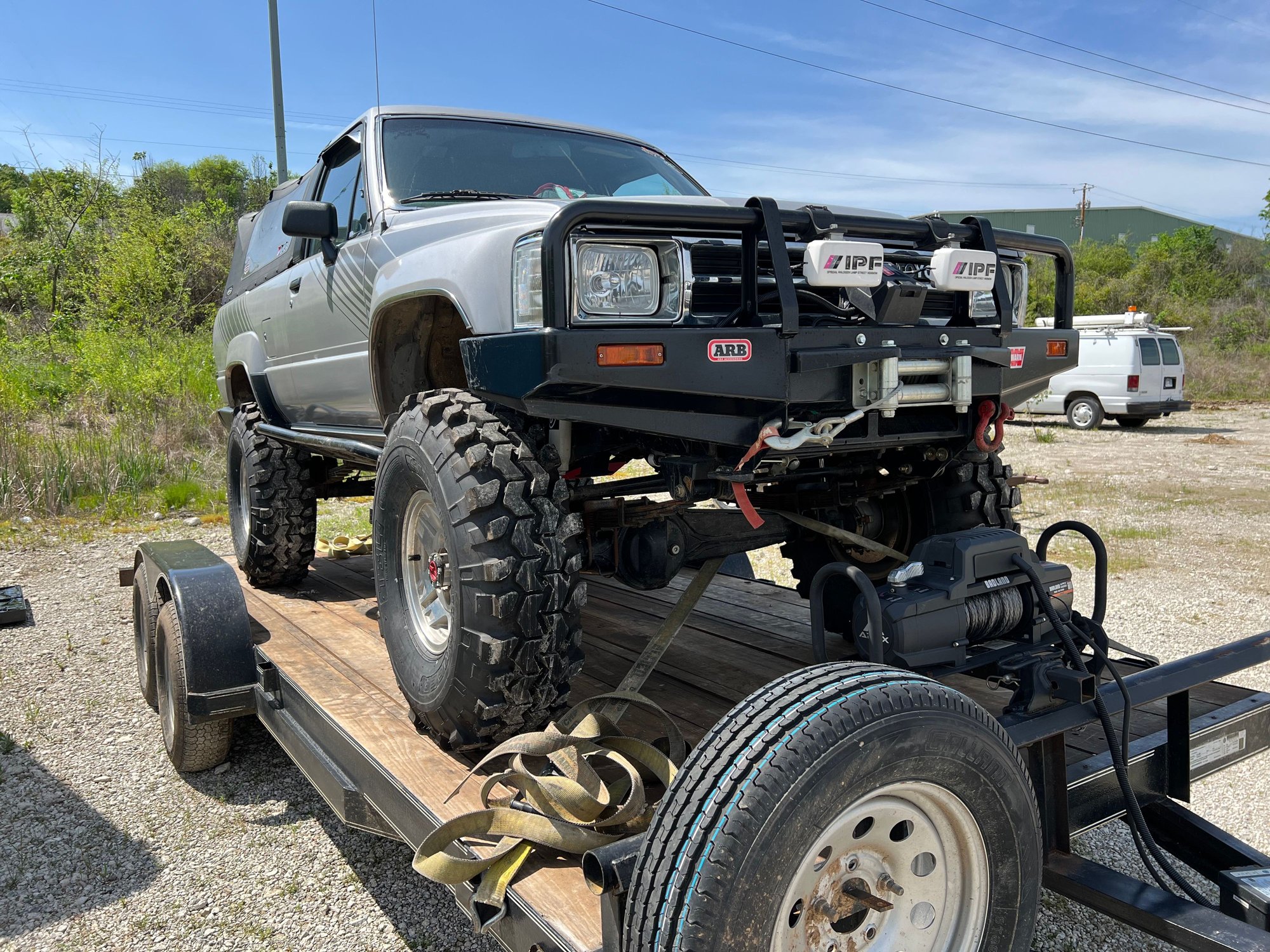

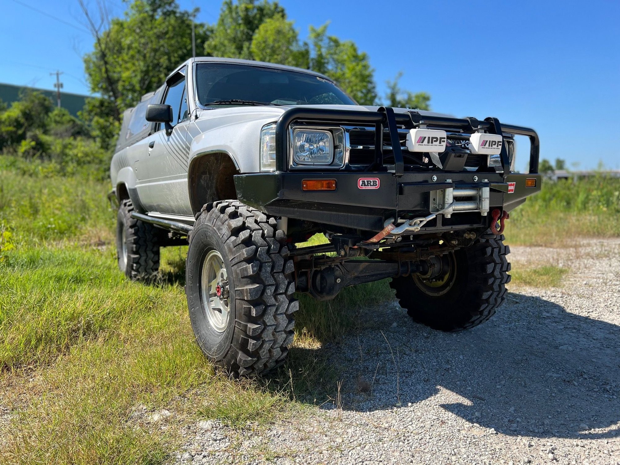

I suppose I should start a new thread titled “cheap restoration turned expensive wheeling rig” lol. Two years to the date since I did the SAS and I use this truck all the time. My Sky springs settled way too much over time. The rears are in a W already and I actually have a set of their new HD packs in the garage. The single 4.7 case I installed is great but left me still wanting a middle gearing option so I have been building a set of duals in my garage. I finally ditched my ARB bumper after it damn near ripped off trying to winch someone up a hill, I did an addicted Offroad bumper and installed a weld on brace kit behind it. I’ve been installing an sPOD as well, and running everything through it. ALSO I ditched my halogen lamps for the Morimoto Holley lamps last week, they are very nice. I fell short on putting updates here, but here are some pics to catch up.

Great pics, always loved your truck. I completely understand the single 4.7 issue, I have a single 4.7 case also, and while it is fantastic, there have been times where I longed for regular old low gear instead of this ultra low. I don't think I really offroad enough anymore to warrant dual cases.
