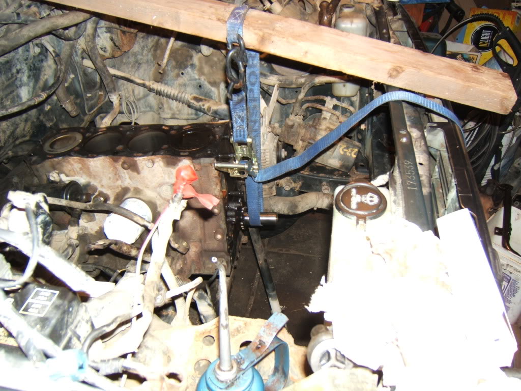

Originally Posted by irab88
i'll have to look at clearances with the diff and driveshaft. if i can't get the oil pan out cleanly, then i'll have to at least disconnect the driveshaft, if not drop the diff. i want to do as little work as possible, as i don't have all the time in the world. this weekend i want to get as much done as i can, so i can check clearances then. i might be up there on friday, if not saturday morning
I found removing a few motor mount bolts worked rather well when lifting the motor to get the clearance for the pan...IMO much easier.

what did you lift the motor with? i don't have (access to) an engine lift
You can use a floor jack from under the oil pan and then put some 2x4 laying flat as spacers between the motor mounts and remove the jack?

I used a 2x4 and a heavy ratchet strap. Put the strap around the crank. Might want to use a 4x4 though the 2x4 was bending a bit.
https://www.yotatech.com/forums/f116...l#post51494738
Just be very careful!!!

Jack it from the bell housing/front of tranny perhaps a block of wood under the engine mounts once she is free. Engine hoist will be in the way if you are doing head work... i think.

do i need to remove anything besides the motor mounts to do this? or are there a few more things, like t-case mount, exhaust holder, drive shafts, etc...

Just unbolt the mounts, everything else should let you raise it a few inches up front, if not unbolt the trans mount. The exhaust will be unbolted from the manifold if you are doing a head gasket anyhow.

ok, now i got it
