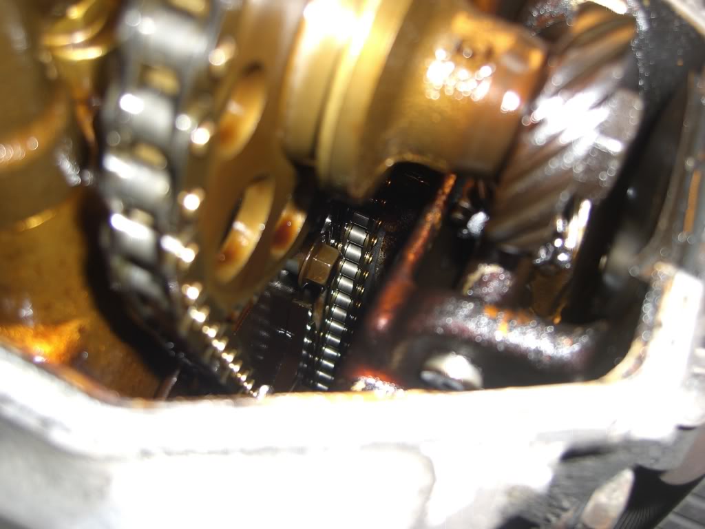

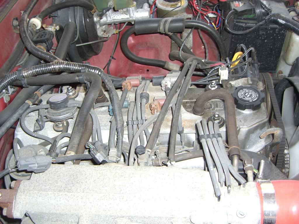

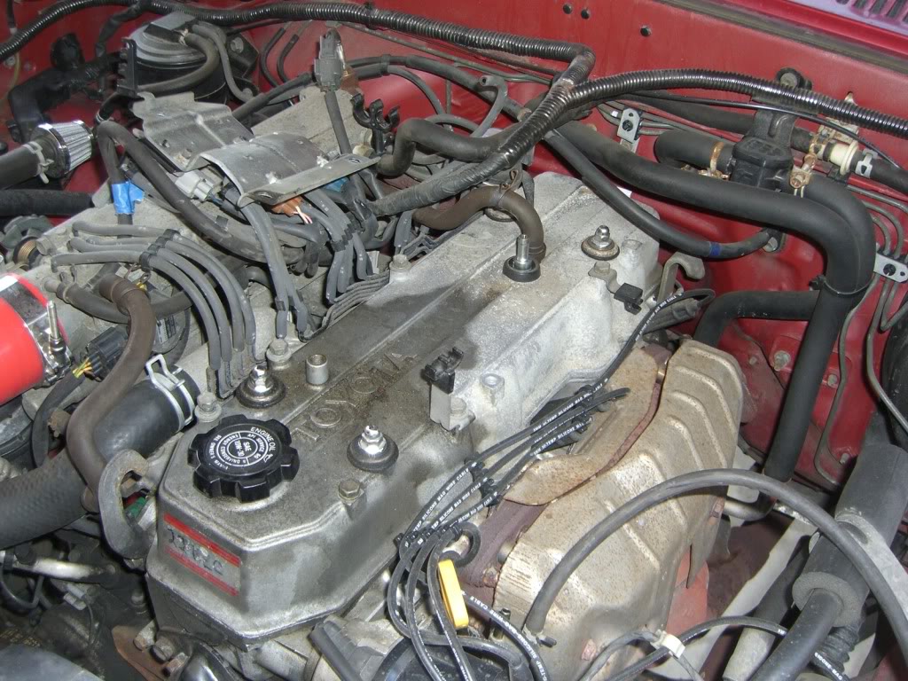

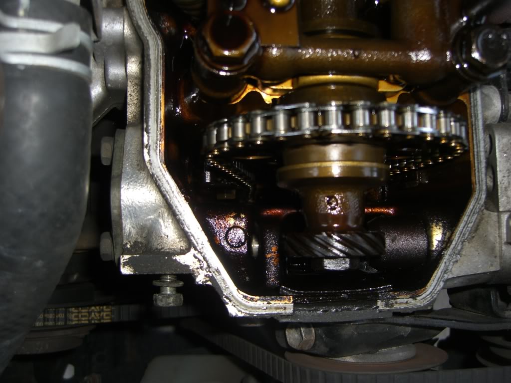

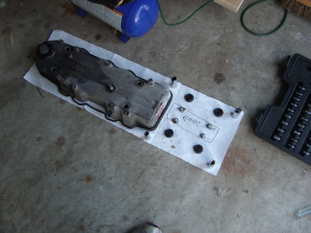

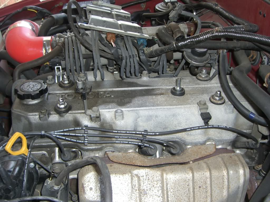

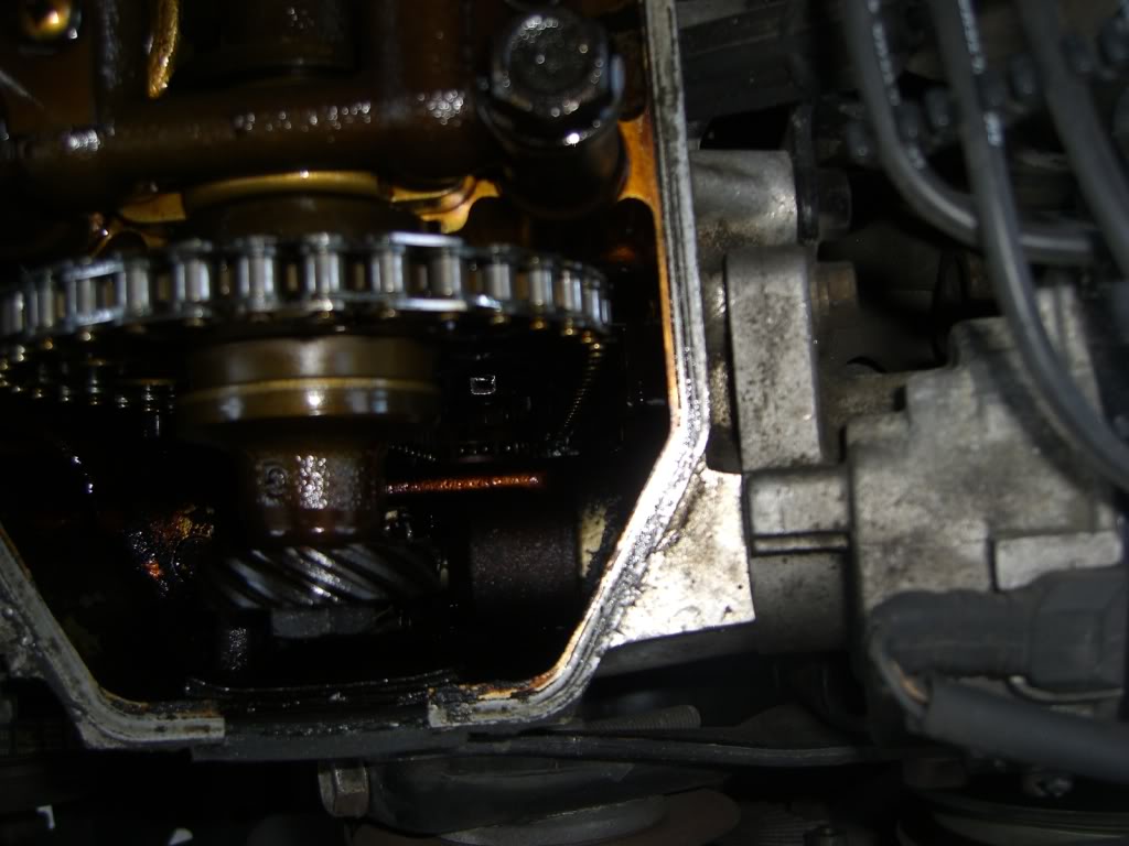

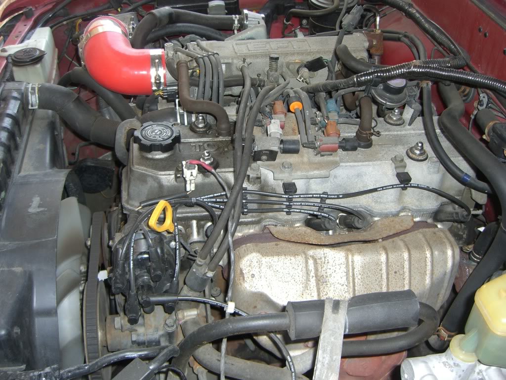

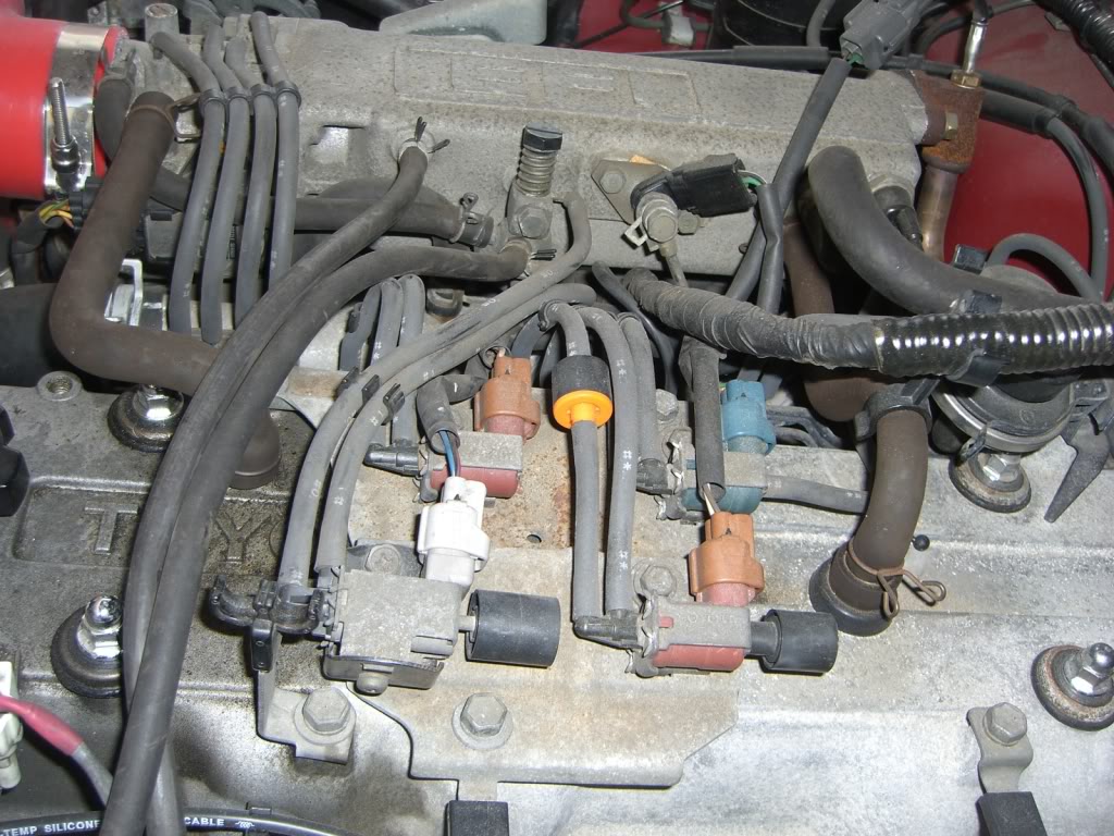

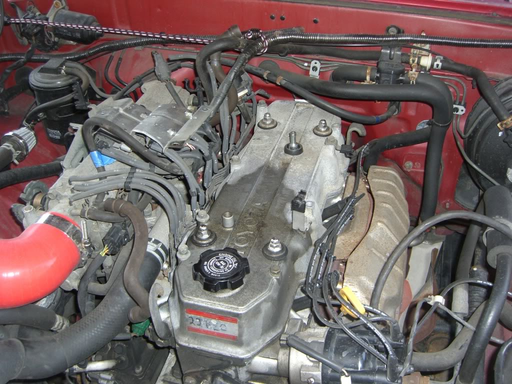

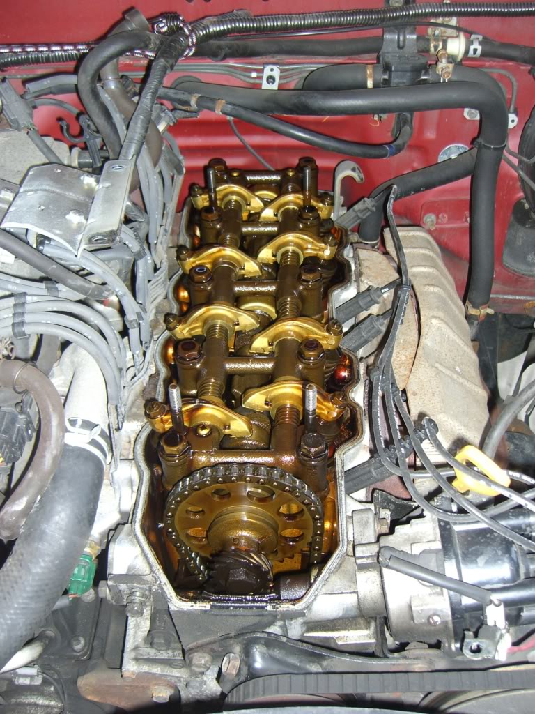

as the title states, the infamous timing-chain-itis has struck my truck. the straight timing chain guide (driver's side) is completely broken, and is probably what i've been finding in my oil. so now it's time to install the new stuff and get this puppy back on the road! (or off the road, i guess)
symptoms i had prior to opening up the valve cover:
-rattle at around 2000 rpm
-knocking under stress
-bits of stuff in old oil
here's the pics and video of taking the cover off and discovering a loose timing chain

timing chain guide broken

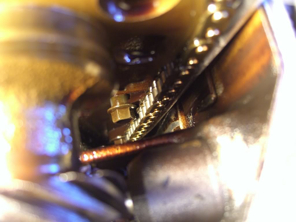

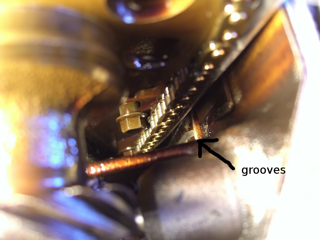

Good luck Ian, It's not too bad of a job. May I ask...why replace the timing cover? Unless it has bad grooves in it from the chain rubbing then it should be fine. That is not a "given" part to replace IMO.

it's got deep grooves. really deep. not something i want to be driving around with
