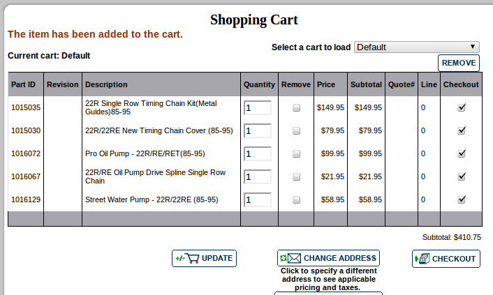

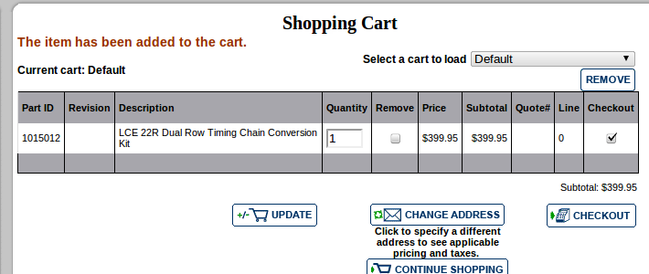

also, what i was wondering with the lce quote above, is it true? i looked it up, and the brands eb lists are also in the rock auto catalog. i'm not likely to do a rebuild until i have a good, full-time job and can afford the time and money. so i'd like oem (or better) quality. lce states it on every page, but their prices are high (for a reason, i assume?). also, i found out this:
single chain, individual components (there's no complete kit)
double chain, kit (everything included, even new bolts)
if engnbldr isn't using oem parts, i dunno. i might have to go with lce on this one
