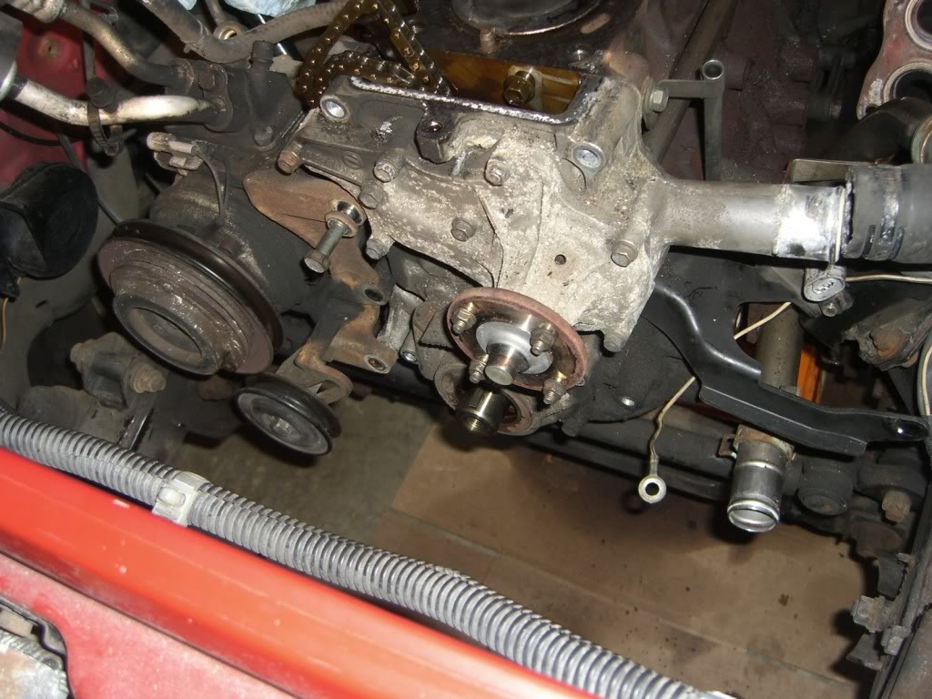

here's what i got done today:
pulley off

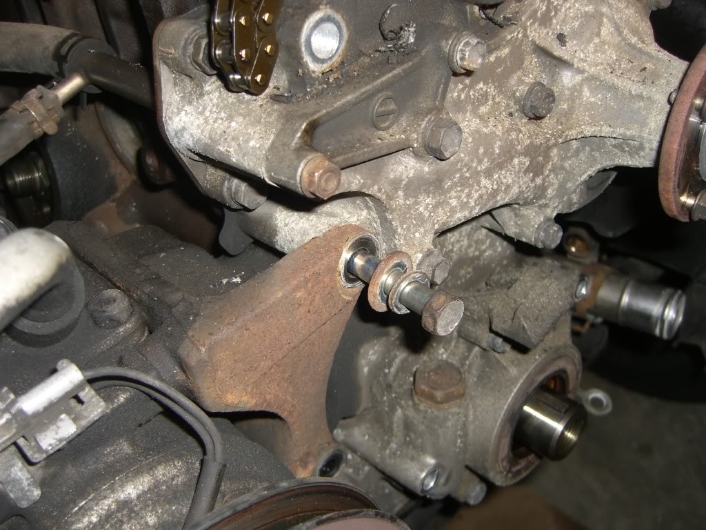

this bolt did not want to come out of it's hole

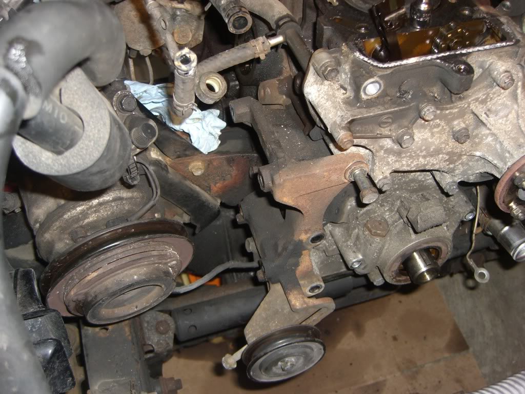

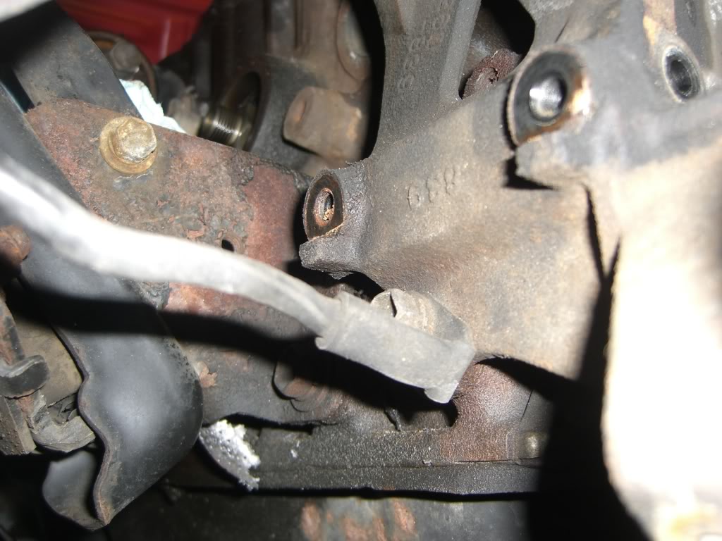

so i looked, and saw i had to take the entire a/c off

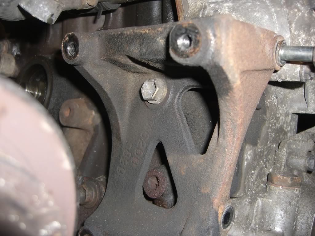

here's the side bolts of the a/c bracket. not in the haynes manual, of course

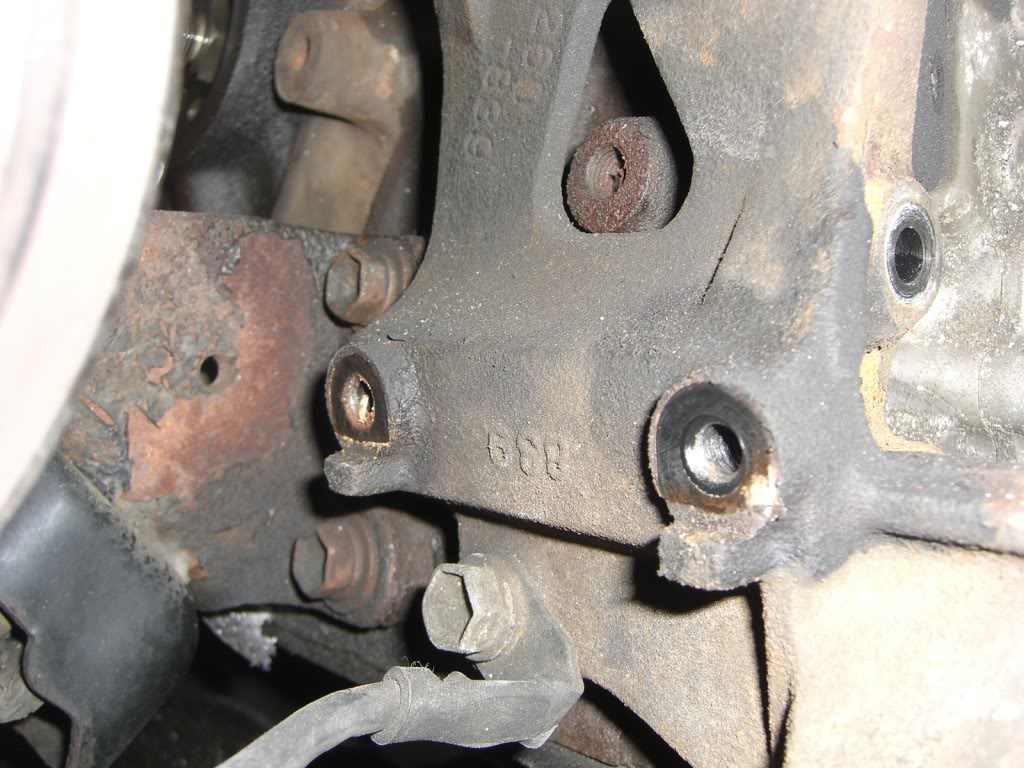

and the lower one

that infamous "hidden bolt"

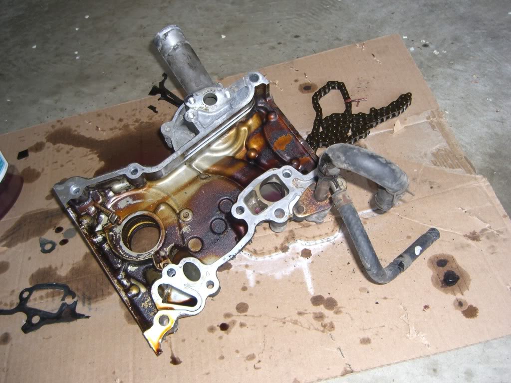

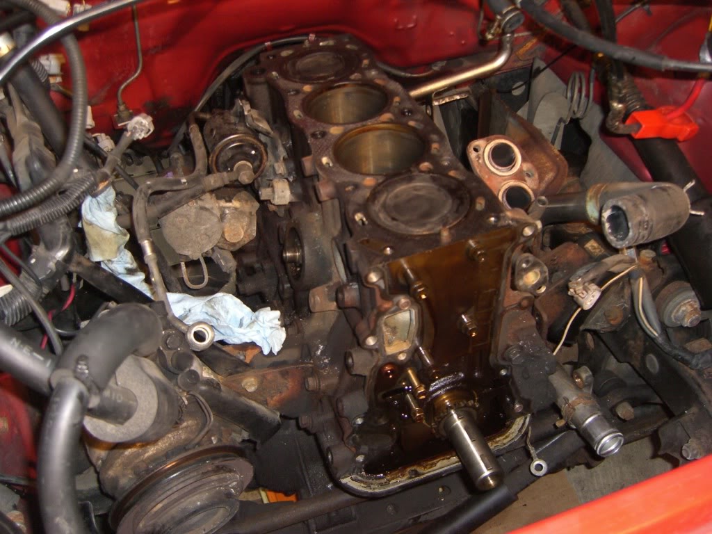

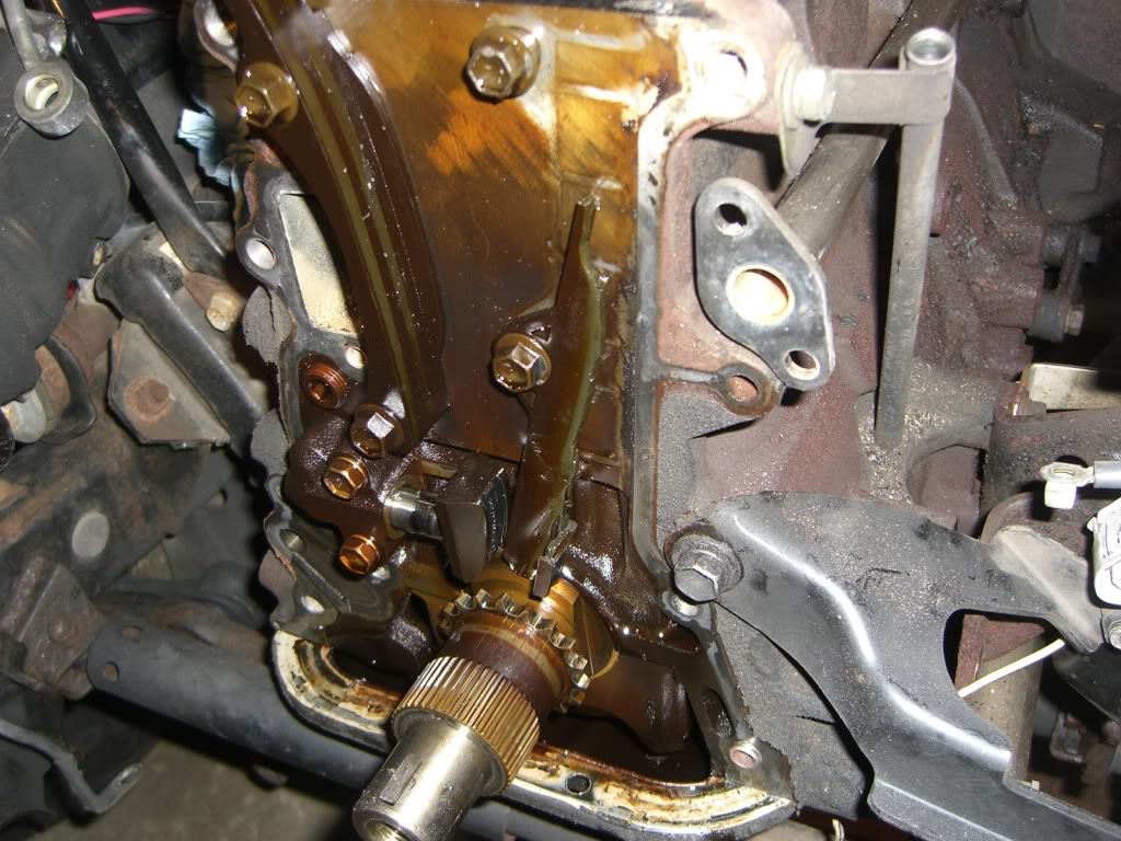

front end off

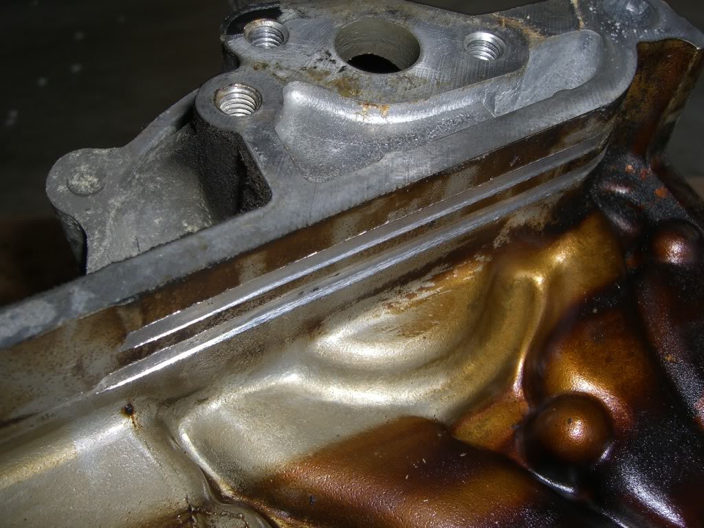

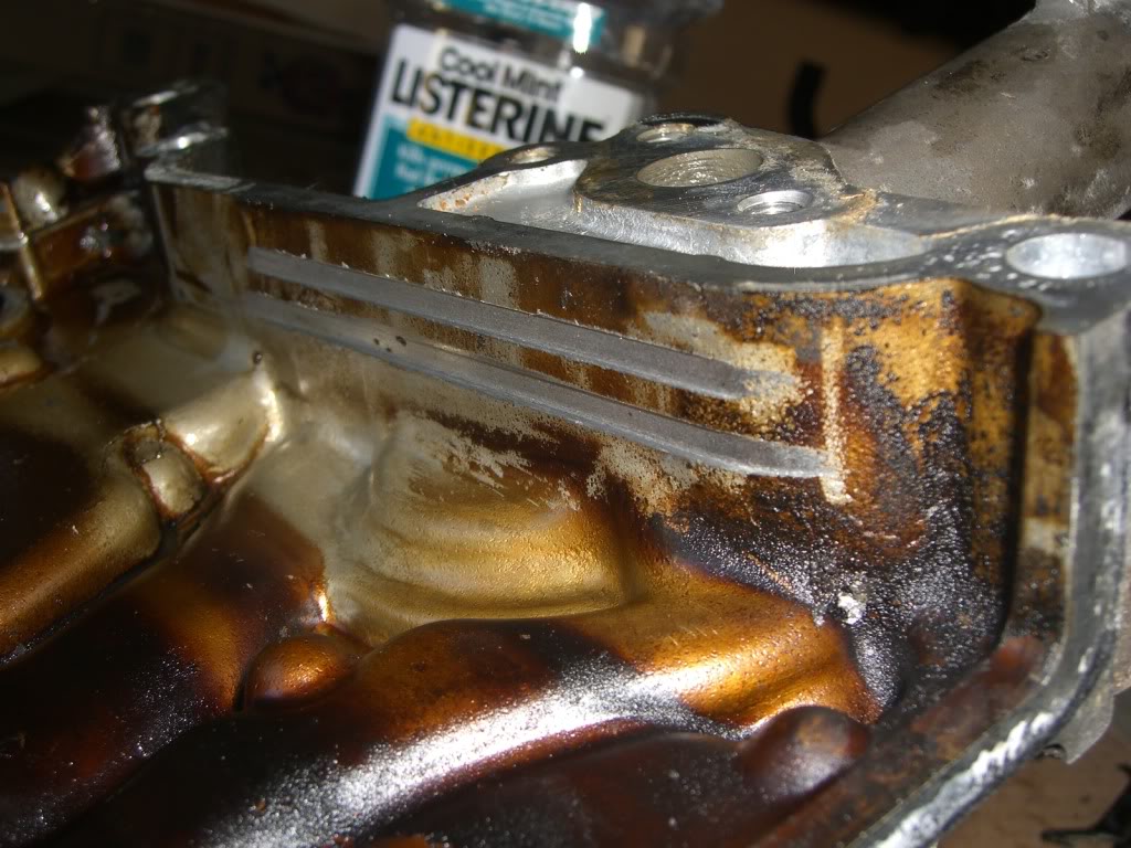

yay... grooves

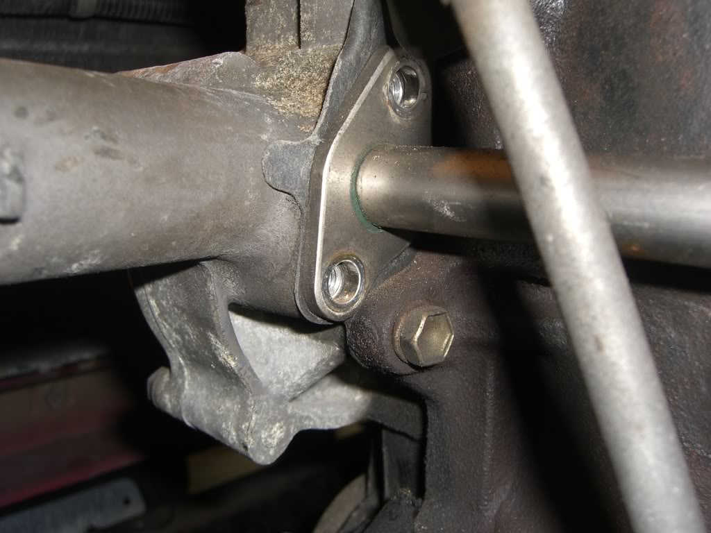

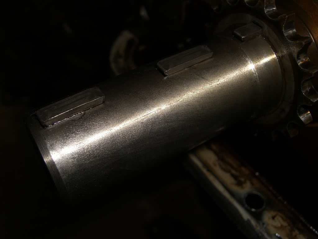

front shaft

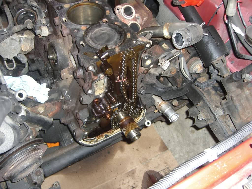

how it sits right now

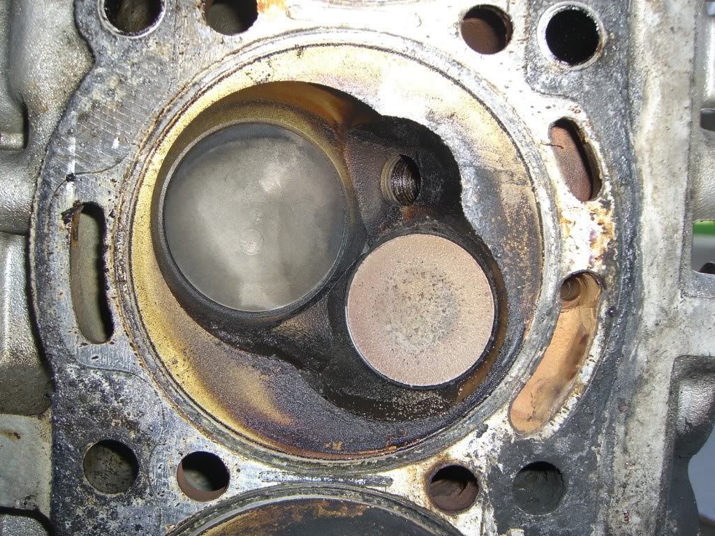

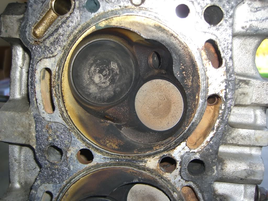

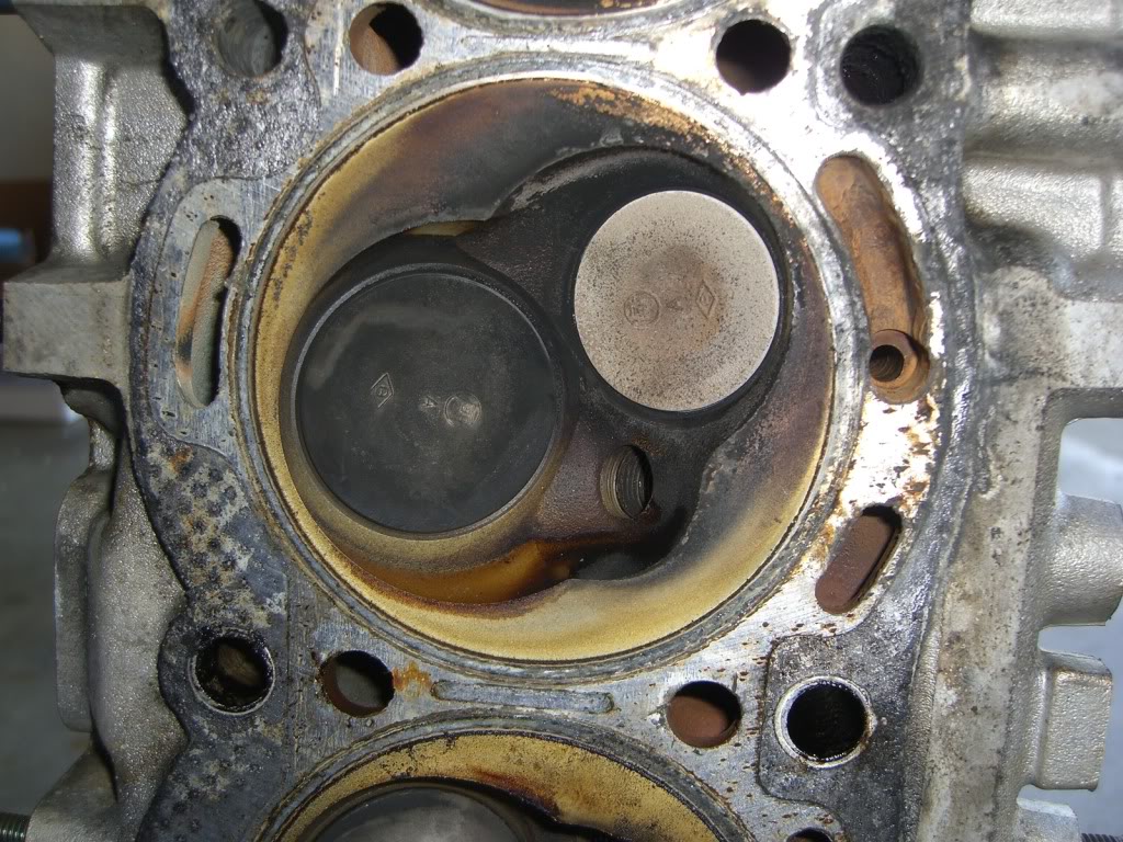

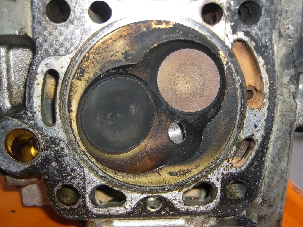

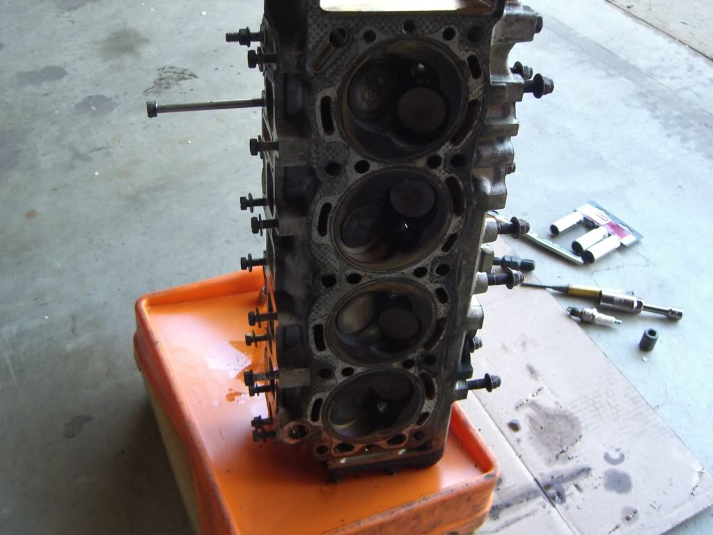

here's the chambers- 1 through 4, in order
and that's it. this week is going to be long, but i should have the truck up and running within two weeks. woo!

SUWEEEEEEEEEET! Great pics, Ian, .... and love seeing those "Toyota" stamps on the valves, lol. Looks like pretty even on the carbon and exhaust ash across the board, and pretty nice in general.(You're not doing anything to the head but the adjusters, etc., right? No 'servicing'?)... Just curious if anything's changed in the plans since you're swooopin right along, lol.
Way to go, man, ..... you're kickin rump!
