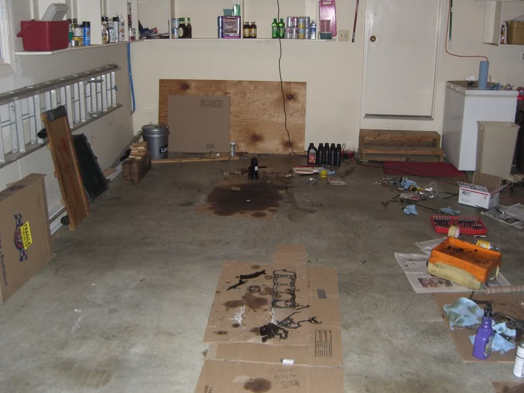

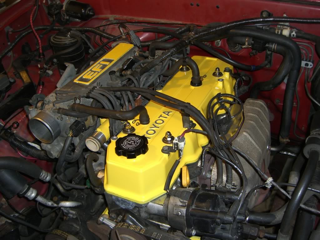

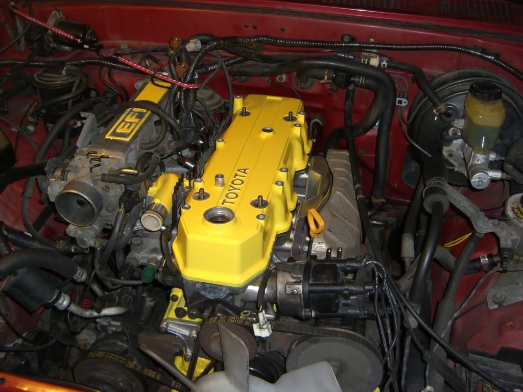

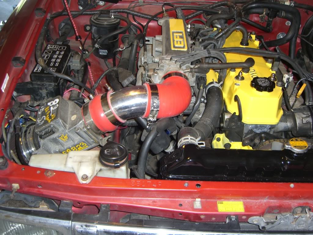

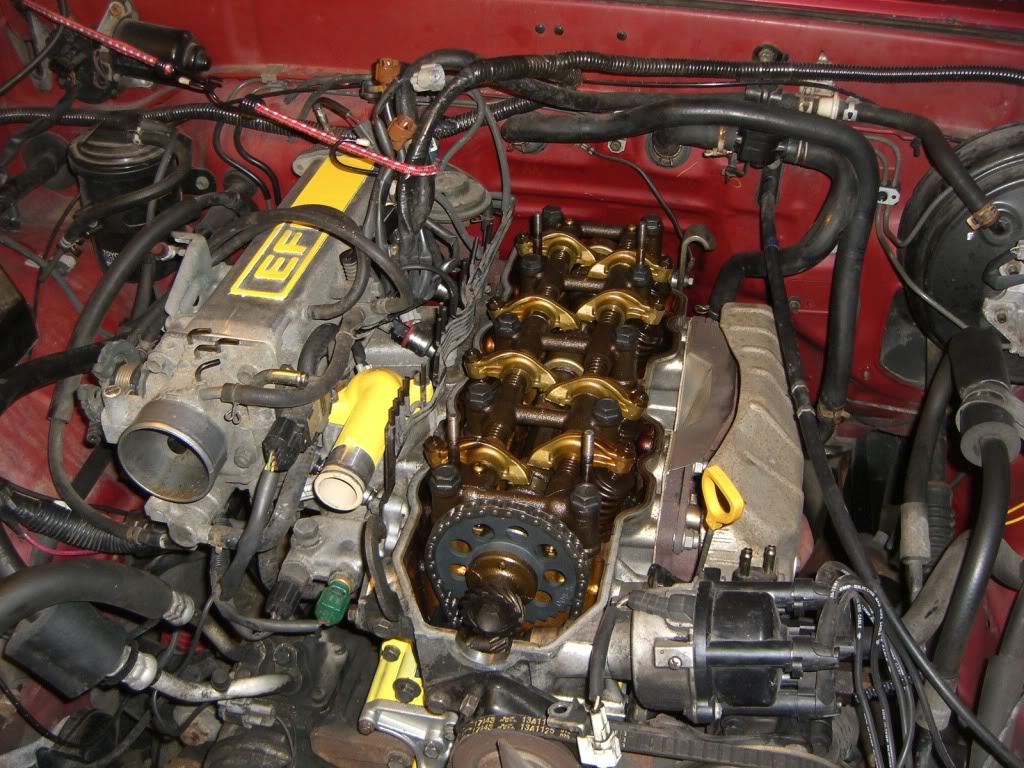

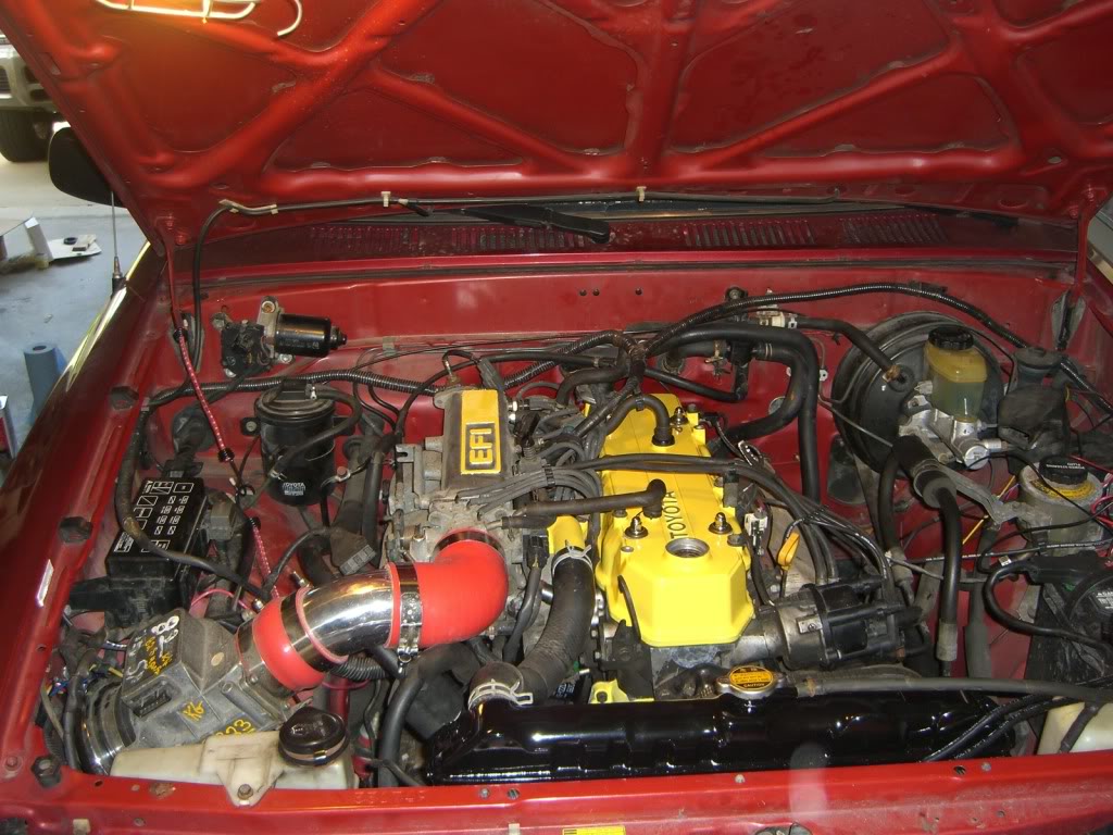

probably. thanks.

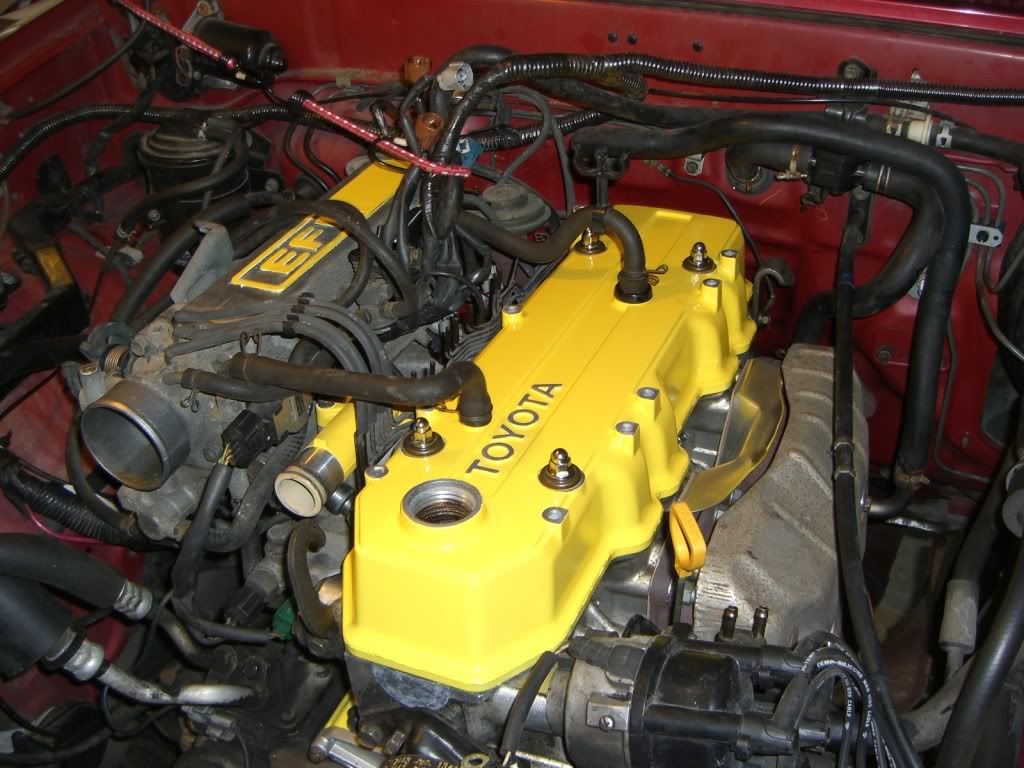

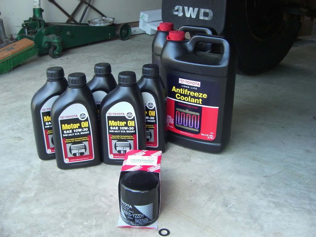

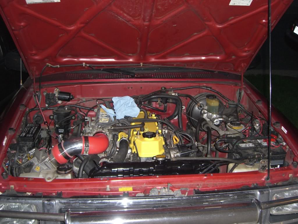

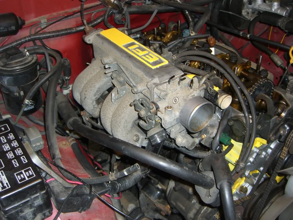

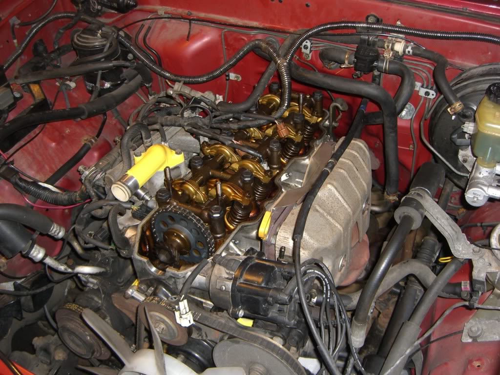

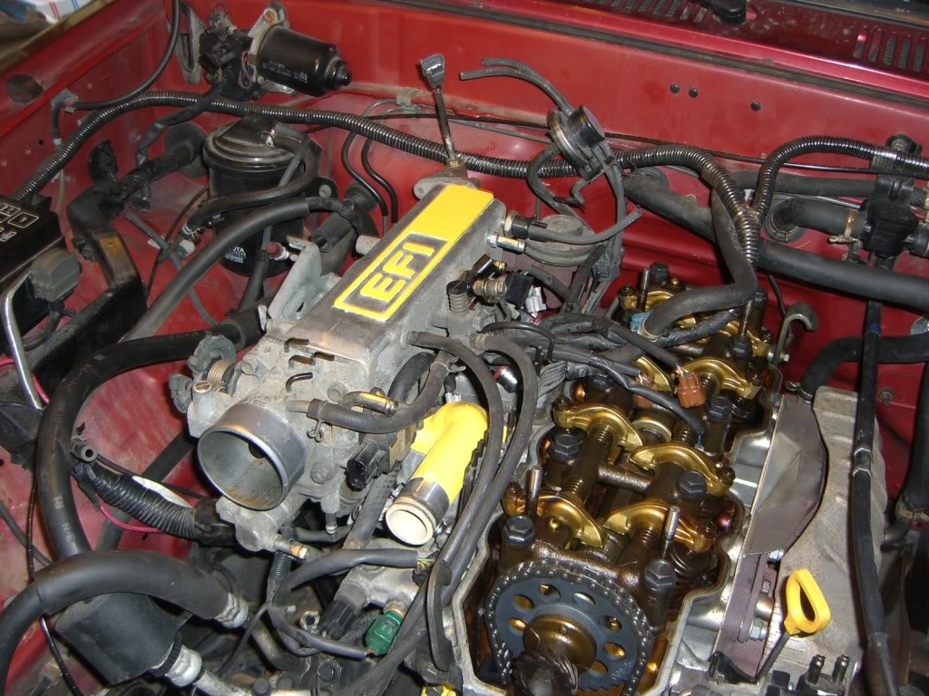

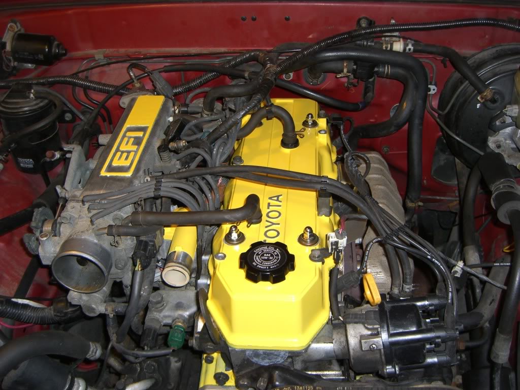

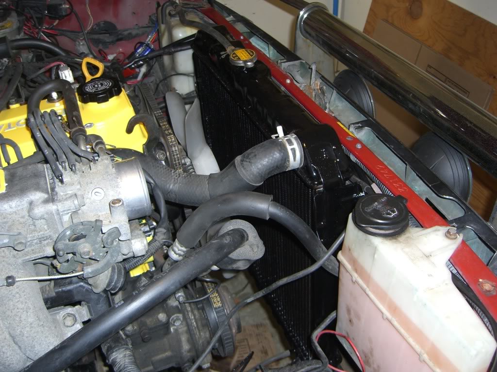

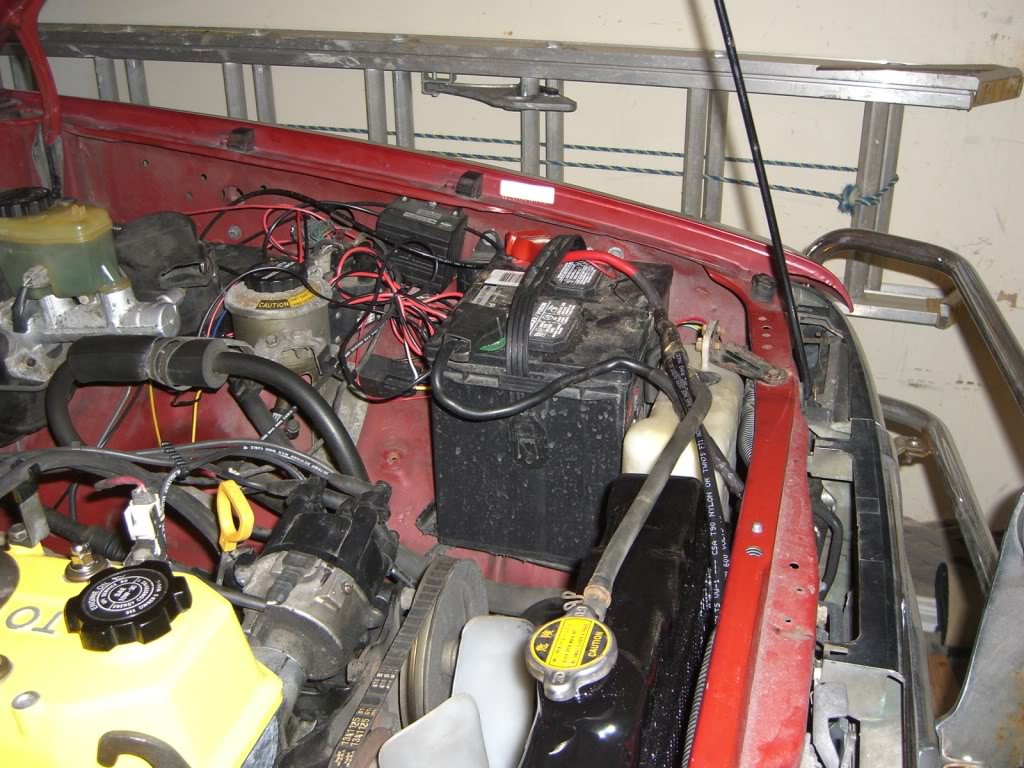

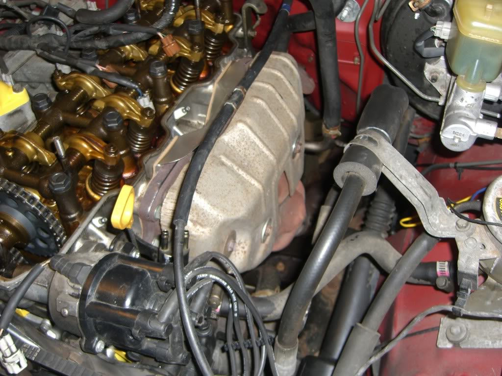

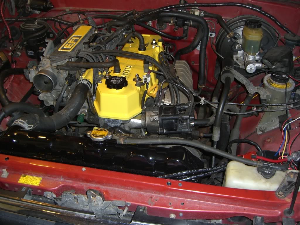

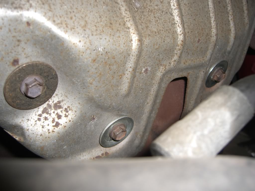

now for some pics! (no labels as it's late and i'm tired. i'll put them on later)

Man, it must have been great to pull outta there running, eh? WOOT! Great job, man!
Far as the crush washers, ....one of them is copper and one is soft steel/tin/aluminum? hahaa. It's silver, I'll just say that. Far as my leaks, it was my damper. I did what RBX said and voila! Just used some emery actually, ...wasn't bad with impression, etc., so it worked fine. However, ...the CSI ones?/Yeah, I'd just get it, I did, and they were like 4$ each. The one with the tongue on it is a lil more, but both are like 7$ I think? With those fresh clean things in there, why not use new ones, eh? lol. (HOWEVER< ....that method probably would work fine on those, as well )
Have a nice night sleep, man, ...bet you're wiped out, eh?
PS> LOOKS GREAT, ..like that color scheme, ..it's AGGRESSIVE! grrr, lol.

like the empty bay pic.....I did the same thing.
good job bud.
good job bud.
thanks. now i have to clean it up
