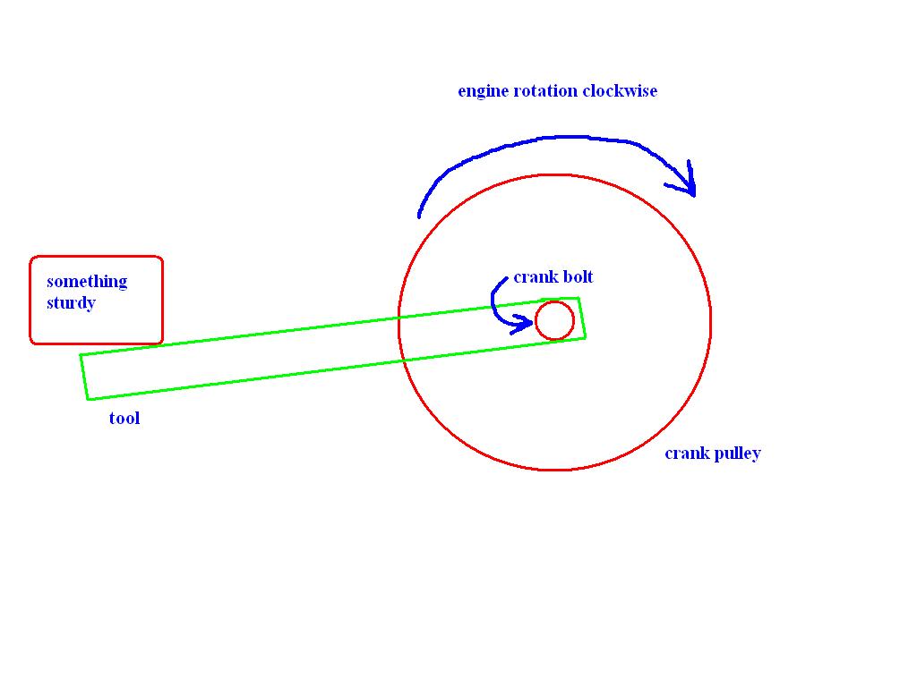

No I'm not intending on re-using the head gaket. I meant it looks like it was not the cause of my problem....which segways to my other comment.....the timing chain guide was gone so it ate into my cover and there was evidence (besides the milky oil) that it ate in far enough to allow the water leak.....so that's why i'm taking the timing cover off.
being the newbie i am, can i do the starter trick with the head and all that other stuff off, so could someone detail how you do it.(i did not SEARCH that, so feel free to flame me on it) my battery is conveniently laying on the floor under my truck so if i just need to hook to the starter with it, it's ready.
#282
gotcha. i was a little worried cuz i thought you were gonna reuse the head gasket. when i changed my timing chain, my right side guide was gone as well, and i have 2 grooves also. however, i never had a problem. i only changed my chain when i first got the truck as a precaution. (by the way, i'm not necessarily "advising" this, but i never dropped the oil pan to get the chain guide chunks out. they're still in there, somewhere, and i've been driving just fine for about 5 years that way now).
wait till someone else replies also, but as far as i know, you could still do the starter trick. i don't believe turning the engine for a fraction of a second will damage anything (no oil in engine other than residual). the problem is, you have lots of electrical connectors off, none of which i know of which ones you need to send the electrical message to the starter to engage. so i don't even know if it's physically and electrically possible at this point. try the jack trick again, but this time with an open end wrench instead of a socket, it might make a difference cuz the socket/ratchet/extension combo won't be twisting. (again, you'll have to have the truck in gear with someone stomping on the brakes).
anyways, back to the starter trick, assuming a normally functioning engine. looking at the engine (at the front facing rear), while it's running (or in this case starting), the crank pulley will turn clockwise. this is important. instead of turning the bolt and keeping the pulley still, you are doing the opposite. you are turning the pulley and keeping the bolt still. to do this, you'll need some kind of tool (ratchet, wrench, breaker bar) that is long enough to attach to the pulley bolt and the other end will have to have firm contact with something sturdy. by "sturdy", i am highly suggesting the frame. make sure you put it on the CORRECT side of whatever sturdy feature you use, otherwise when you turn the engine your tool is going to go flying intil it hits something else sturdy, or worse, something else not sturdy and breaks it, or worse, hits a person. ouch. once the tool is in position (feel free to hold it in position with duct tape or whatever so you don't have to hold it with your hand), just barely tap the starter. if you were going to actually start your truck, it should not be enough rotation to actually start it. that's how little you are going to be turning it over. 1 of 2 things will happen. you'll break your socket or the bolt will come loose. here's the fun part, it's no longer in TDC. DO NOT FORGET TO PUT IT BACK IN TDC!! and that's the starter trick!
#283
oh and i really hope you enjoyed my artwork on the starter trick. feel free to print it off and put it in a frame for your living room wall! just don't sell it without the artists prior consent! lol

Ok thanks for the BEAUTIFUL artwork, I'm speechless. uh, I assume you saw my artwork on my block, so your's is waaaay better!
I'm tied up with work until wednesday so i don't anticipate touching the truck until then other than touching it with my coffee cup.
I appreciate the info on the starter trick, I will re-read several times before attempting it, i still have all my teeth in my mouth and would like to keep them where they are.

I'm curious about the "bump the starter" trick.
I understand about the placement of the bar on the nut and that the engine is going to go clock-wise, where do I touch the wires to? I guess in that case I will be safely UNDER the truck out of the way of a flying breaker bar if that happens which it sounds like it won't.

You've GOT to be kidding me!
Is that starter seriously gonna work? I have so much stuff unplugged that I don't know what the hell I was unplugging and it's gonna still work? I was sure I was way too far gone for that.
Here I am thinking I have to defibrillate the damn thing while laying on the garage floor and trying not to die with 2 live wires to 2 bolts or something like that.
I seriously am too much of a pessimist or I am over-thinking the hell out of it. At least I don't have to get under the truck.
