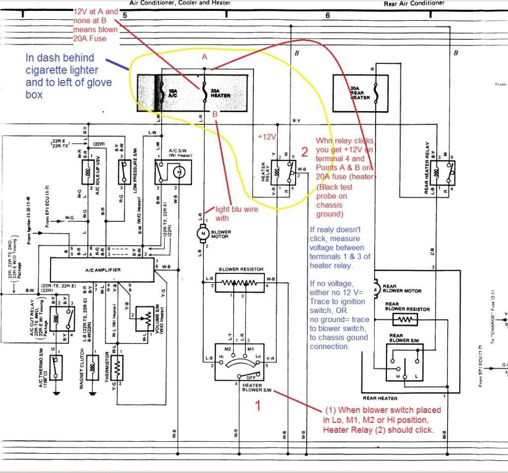

Closest I could find see A23 & B23:

Resistor and blower switch are on the negative side of blower motor. They provide ground to motor and to negative side of relay coil when switch is NOT in off position. If your negative (black) test probe is on ground, do not expect to see any voltage on resistor or switch (unless switch is on OFF position, when you'll read voltage leaking through relay coil).
If 22RE, since relay clicks follow notes "2" in red below.
If you get 12V on both sides of fuse, you should also get 12V at terminal 1 of blower motor.
Now measure between terminal 1 and 2 of motor. If you get 12V there but motor still does not work, most likely the motor. To verify; disconnect blower motor, measure resistance between pins 1 & 2 OF MOTOR, compare with what other owners read (Gotta ask those who have measured theirs).
Fuse and relay scope103 mentioned above are here: Name:  001_Blower_Control_Relay_0001.jpg
