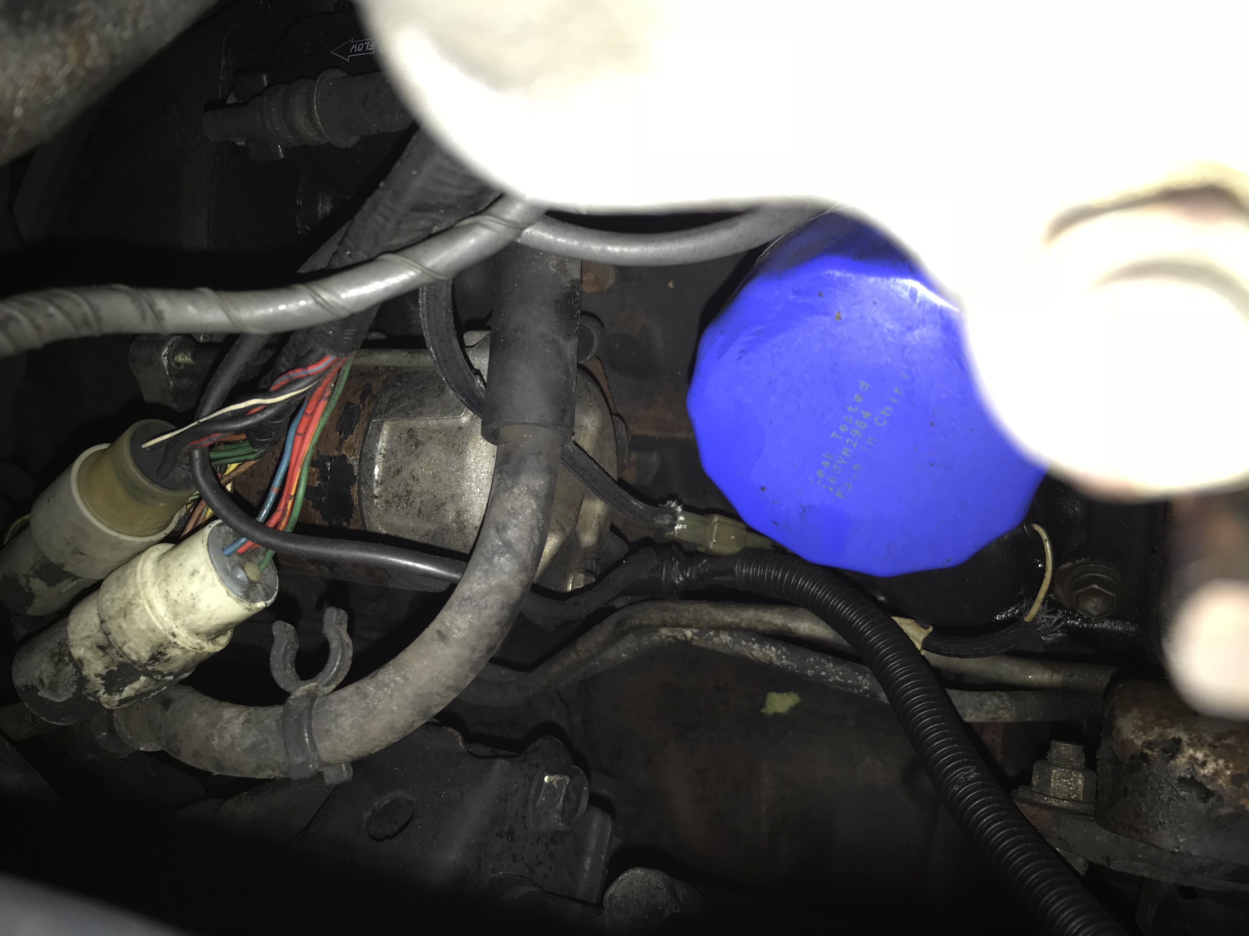

I read about jumping the starter by connecting the starter terminal directly to the Positive end of the battery. Haven’t done this yet as the terminal and wiring looks fine to the starter. Starter looks old though.
