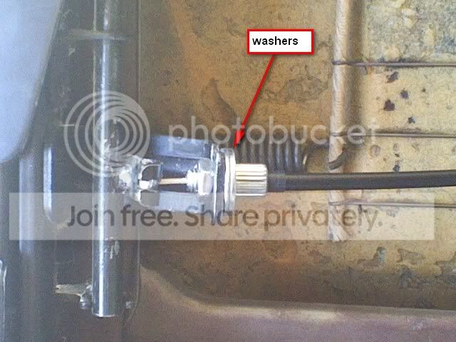

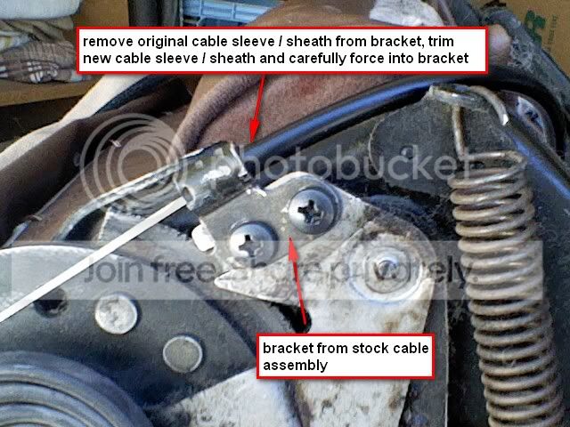

passenger seat fixed w/ bike cable
A couple of people asked if a BMX bike gyro cable can be substituted for the Toyota seat cable. I just finished using an Odyssey G3 universal lower gyro cable to fix my seat. The only piece I used from the old setup was the cable end that is screwed to the seat. I attached the two ends of the new double ended cable to the seat track release points just as you would with the stock cable. Well... I actually had to add some washers to get the adjustment right, since the new cable doesn't have double nuts like the stock cable, but it's no big deal. Then I pulled the old single cable sleeve out of the cable end attached to the seat ( see the 2nd pic in post #6 of this thread) and measured roughly the sleeve of the new cable, cut the excess off, and forced the sleeve into the attachment bracket. I did this with the actual cable wire removed from the sleeve. Then I fed the cable wire through the sleeve and measured the cable wire to a length that would pull the seat track lock brackets clear when the seat back was in the forward position ( I think this is the only part of this that is minimally tricky ). Then I compressed a wire rope stop "sleeve" onto the cable w/ my "nicopress" tool, hooked up that end as per the stock cable and it works (for now). I got the cable for $10 + pennies for the stop sleeve, but I've seen the cables online for $5. Not quite as easy as the stock cable, but close and 1/3 the cost. We'll see how it lasts. Hope this helps.

bike cable pics
Hope these help. The whole operation was so easy, I didn't take time to take step by step photos.
