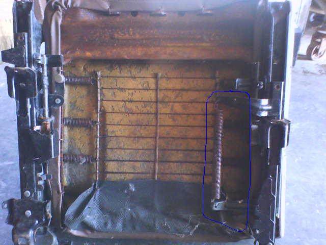

ok so thanks goes out to ... Mark ( DemonRunner ) for sending me these pics ..
exactly what I needed ...
thanks Mark

Nice pics , So nothing goes connected here at the red circle in the pic

I dont think so .. not here in North America anyway .

The pictures I took was of my 88 4runner seat , I just went out and looked at my 85 4runner seat and there is a spring where RMA had circled,my 88 is missing the spring I never noticed that before.

ahhhh yes ... this makes perfect sence now ...
the spring is what would actually pulls the seat forward when the leaver it "tripped" DOH !!!!
