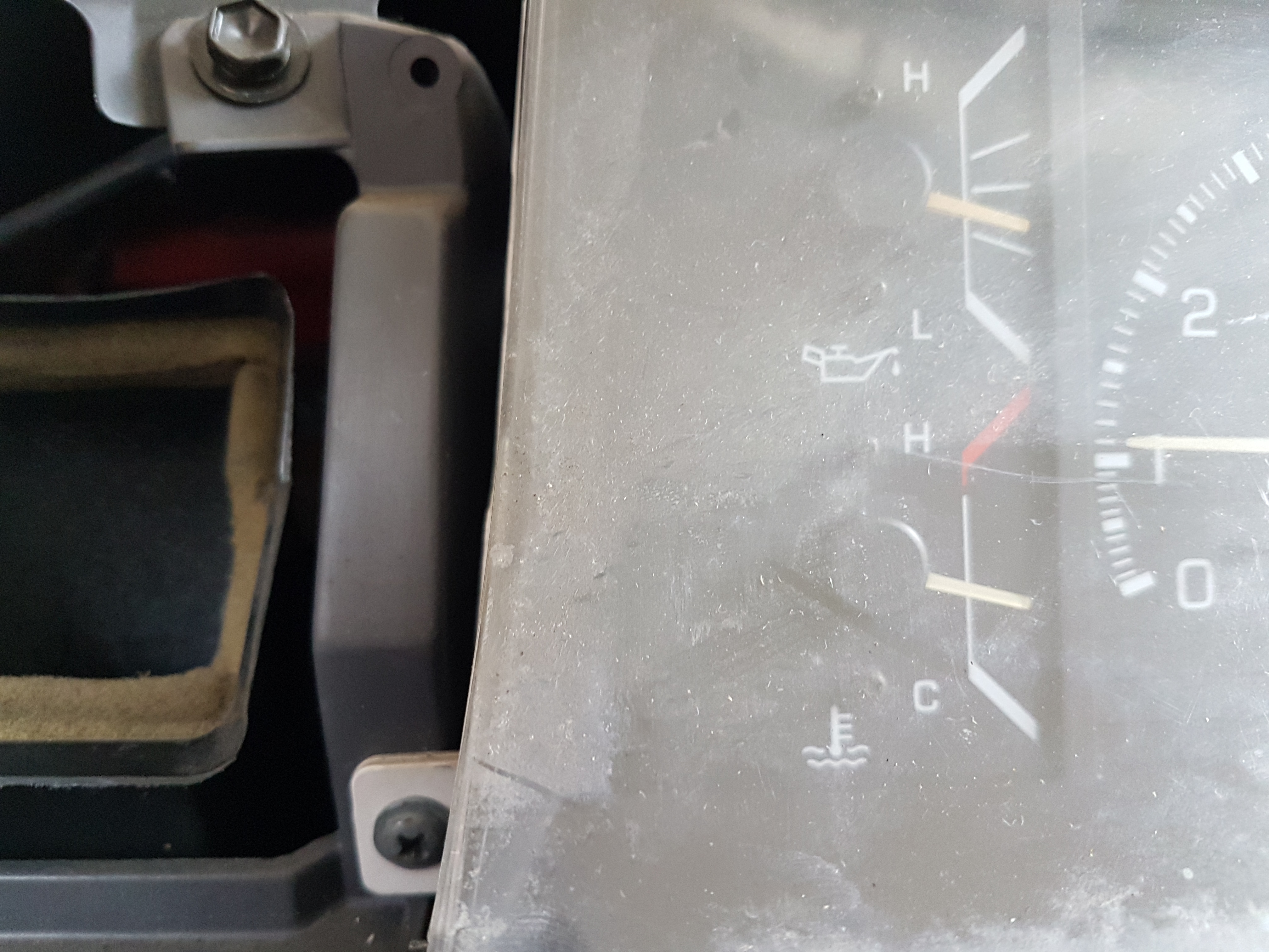

The temp gauge of my Toyota 4Runner first gen (1988 SR5 22RE, no airco, manual trans) doesn't work.

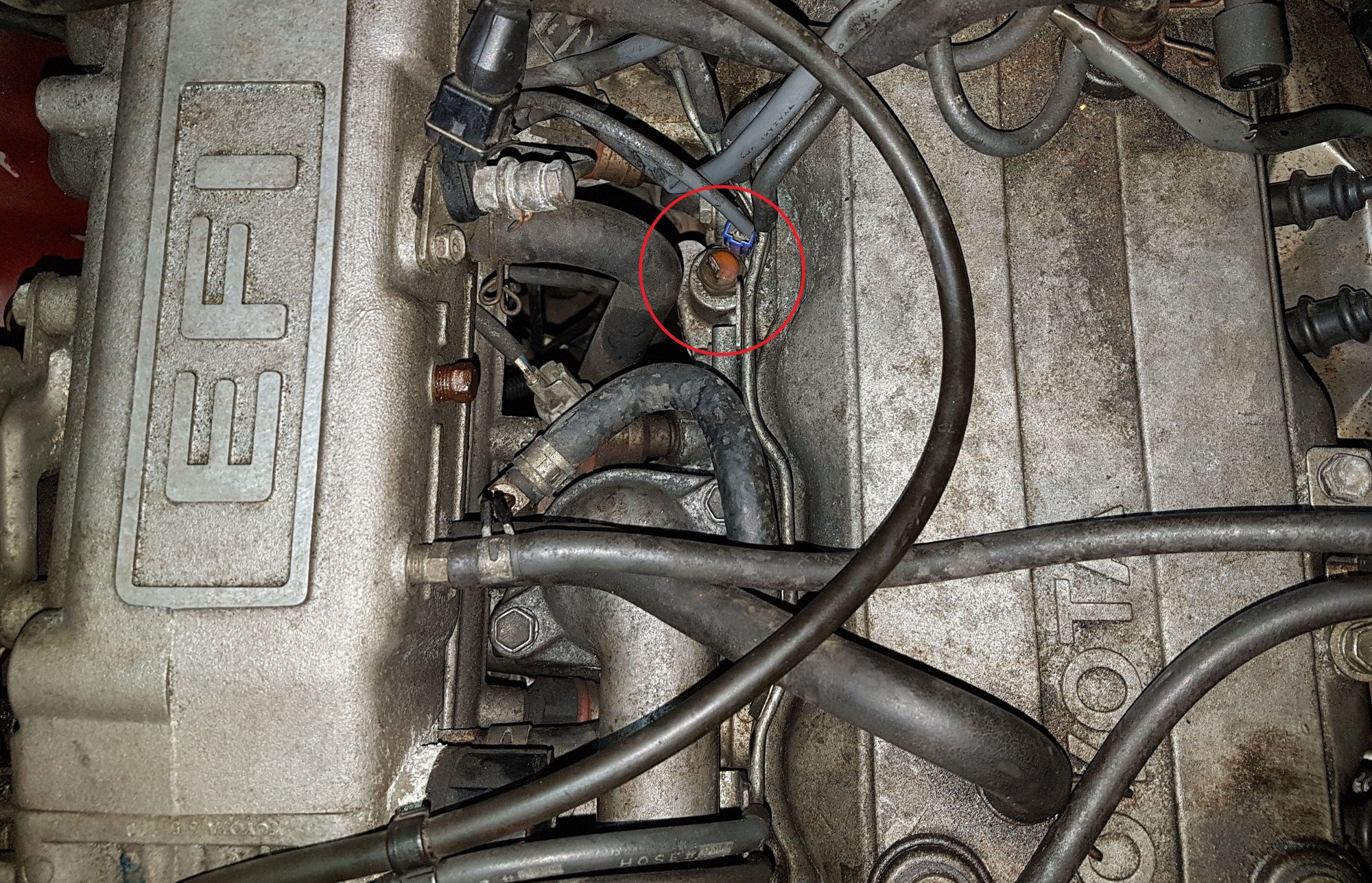

but it's not in my 4R. I think, in my case, it's the one inside the red circle (please see pic attached), is that correct?

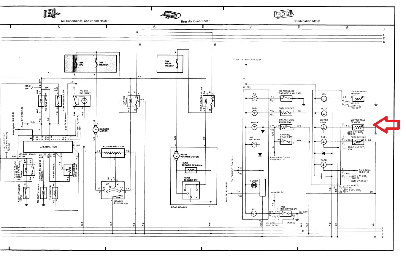

The pigtail's blue and the wire's yellow with green stripes, like the one the temp gauge receives (see red arrow in the electric schematic attached).

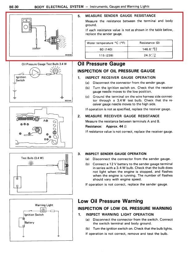

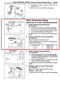

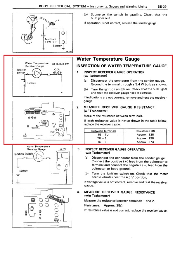

Here's to test the "gage" half of the system:
Originally Posted by 881stgen
Picked up a 3.4w bulb and hooked it up per the manual and the needle went right to normal and the light lit up. The manual says if results aren't as expected then test the actual gauge but since they are as expected I guess my next step is to pull the sensor, clean it and test it. I was getting a false reading before when I tested the resistance. I made sure I got a good connection and each time it gave me different readings. Usually in the 40-75 ohm range. I'll report back when I get it cleaned and tested and I will clean the threads as well.
The sender on top of T-stat housing is the Coolant Thermo Switch (TSW for ECU), not the temp gage sender. The temp gage sender is the one on your photo...
(THANKS FOR THIS PHOTO! I could not even find sender on mine)
Coolant Temp GAGE sender.
Here's the test for the sender. It only have one wire connected to it so needs clean, bare, metal contact with the block.

Dash gauge temperature sender is located below cold start in the middle of the lower intake, what you see in RAD's photo is a temp switch.
I'm going to test that gauge water temp sender, and I'll report back.

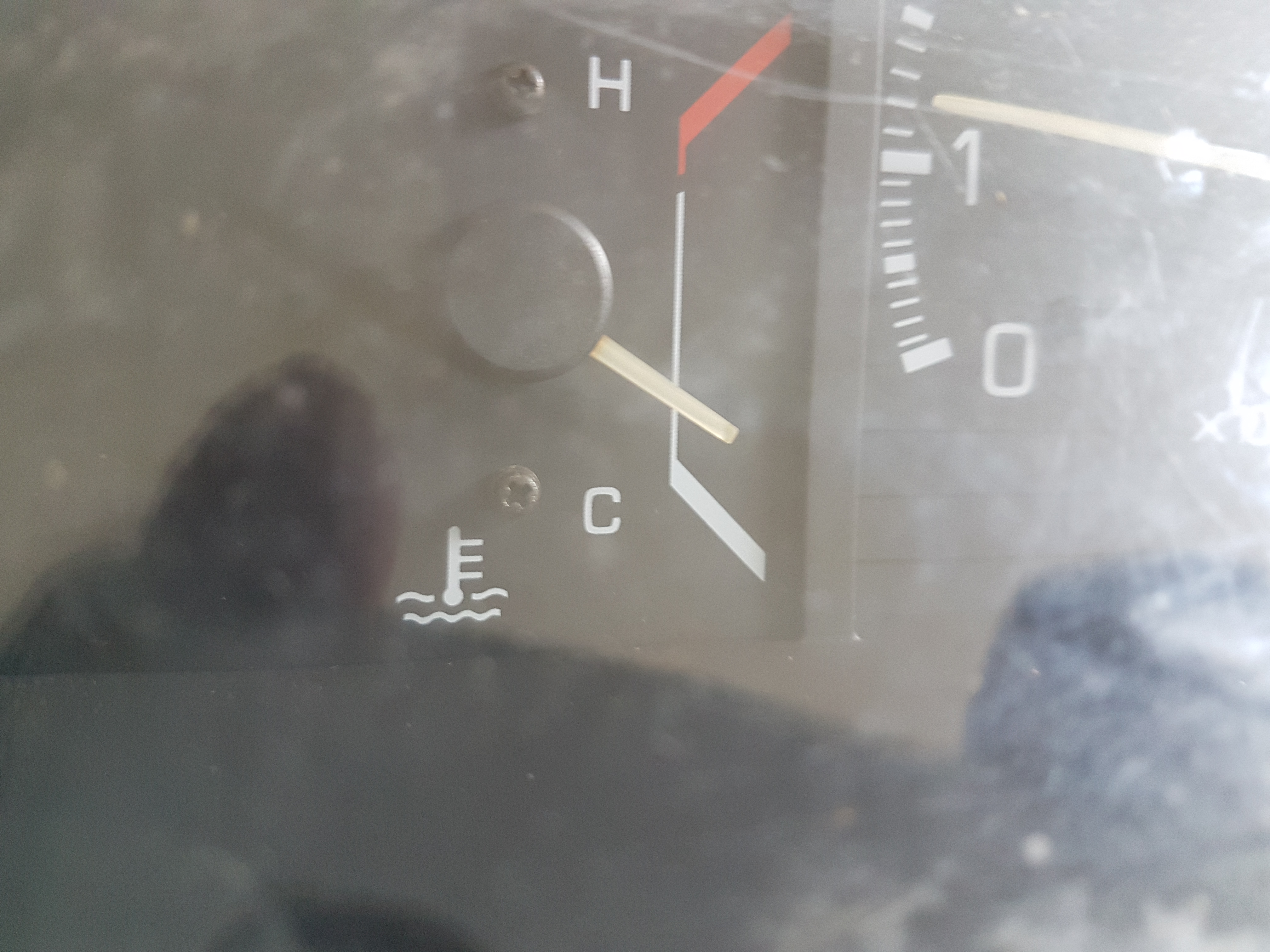

It works!
Hi guys!
I wanted to update this thread. It works now.
I removed and cleaned the gauge water temp sender. In fact I cleaned the other two senders also like in this 22RE Performance video:
After that I flushed the cooling system, I replace the thermostat. I put everything back together. I blocked the rear wheels and I jacked up the front wheels to be sure the top of the radiator was the highest part of the c.system. I slowly filled with Toyota red coolant. After 25 minutes with the engine running waiting to purge, the temperature gauge needle went up a quarter. Happy with the progress, but I expected to go a little bit higher. Is that good?

Update:
I think the engine was not warm enough.
After running the engine for other 30 minutes to purge the cooling system, the needle went up a little bit more. It looks good now.

Awesome! Thanks for the update. The temp gage normally sits below the halfway point. It's never exact. It just indicates:
1) Cold,
2) 1/3 of the way = Normal op. temp
4) 1/2 of the way = Working harder than usual
5) About 3/4 of the way = Do something about it (turn AC off, slow down if going uphill, turn heater on, check radiator/fan, etc.)
6) Red mark = overheat, stop, check everything.
