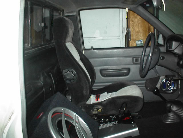

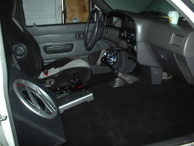

Quick pics of the interior
and one to show off more of the carpet
More coming later...including a report of her starting (I hope)

Old May 2, 2005 | 12:19 PM
  #163
Bassinfool's Avatar
Joined: Jan 2005
Posts: 885
From: Roseville, CA
Morph-
I'm thinking about copying your speaker pods, but was wondering how exactly you attached them. Did you just screw them straight into the inner panels, or put a backing plate on the inside of the panel, or what???
Edit: PS: That carpet looks friggin GREAT!

Old May 2, 2005 | 10:04 PM
  #164
Morphine's Avatar
Joined: Jan 2005
Posts: 571
From: Moreno Valley, Ca
Bassinfool: To mount the pods all I did was screw directly into the panel. I made sure to get a screw that would go through the wood, through the padding and through the door panel backer. The tip of the screw is right at the dynamat/metal. Since i'm not running an amp to the door speakers is sounds awesome. Theres no rattling or vibrations from it. Hope this helps but if you need more direct info let me know.

Old May 3, 2005 | 07:57 AM
  #165
Bassinfool's Avatar
Joined: Jan 2005
Posts: 885
From: Roseville, CA
Perfect. I think I'm going to start on them this weekend. The only other thing I was wondering from looking at your pictures is, have you tried rolling up the window with the pods there? It seems like you would hit your hand on it because the pods are fairly close to the crank.-?? Just wondering, because if so, I'd like to make sure & mount mine a little lower.
Old May 3, 2005 | 10:34 AM
  #166
Morphine's Avatar
Joined: Jan 2005
Posts: 571
Every so often I clip my hand. I tried to measure it out the best I could. It doesn't interfere but if you're in a hurry "Yes, you will hit your hand". I'd also recommend staying away from the rounded corners as the fabric was a real pain. Granted I had no clue what I was doing, but just a word of caution. My next design would be more along the lines of this:
Sounddomain link HERE
It still has a sweet look to it, offers options for mounting, and looks real clean.

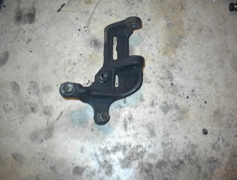

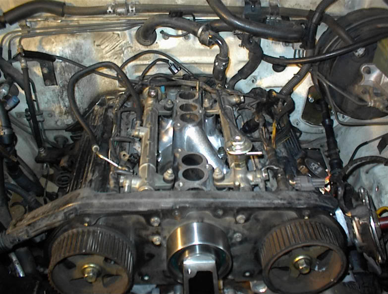

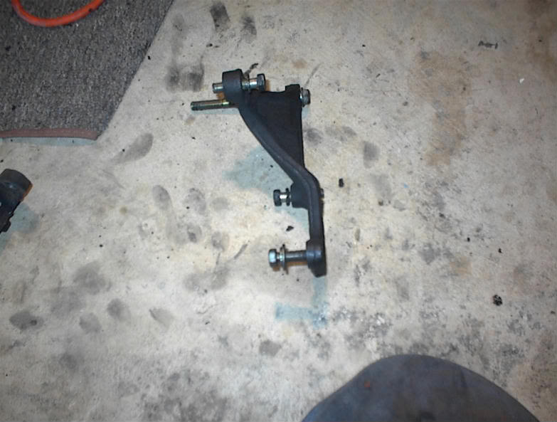

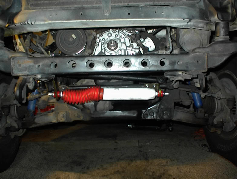

Ok, thanks everyone for chiming in and helping me over my mental hurdle. Well I've made some progress. Just a quick pic to show, and then some mystery parts for everyone to explain to me where to put them back on at.
First my progress...May not be much but it is progress.
steering stabilzer..
Now the 2 mystery parts, brackets of some kind. The first one...maybe a support bracket on the passanger side (where do you go???)
and the second one...
Possibly do one of these help support the altenator? I have the lower support bar but not the upper. Maybe for the power steering resovoir(if this is the correct name). This is my fault for waiting so long. STUPID FEARS. Now I'm working onn my motor on FRIDAY THE 13TH.

Old May 13, 2005 | 02:01 PM
  #178
Morphine's Avatar
Joined: Jan 2005
Posts: 571
OK, I didn't want to edit my post instead I thought I'd post my own answer...
The 2 mystery parts appear to be these support brackets..
Thank you Ganoid for the help and sending me those pics the other day. I guess looking at them at 1:30AM is a bad Idea. I'm still open to answers on the alternator bracket.
Thanks again
-=Morphine=-
EDIT
ok it looks like part 1 goes on the passanger side to support the power steering and that part 2 is the support I was lokking for for my alternator.
Thanks again Ganoid, I'm taking a second look at your pics and I'm "SEEING THE LIGHT"

Old May 13, 2005 | 02:34 PM
  #179
Bumpin' Yota's Avatar
Joined: Feb 2003
Posts: 3,689
From: Sarasota, FL
Yup the good ole power steering bracket! I took it off and cleaned it when I did my timing belt...when I went to put it back on 3 days later I had absolutely no clue how it went back on. Thank god for the dozens of pictures I took!!
I had the same issue with the fan braket - no idea hwere it bolted up to until i looked at one of the pics I had taken.

  #180
rah1420's Avatar
Joined: Sep 2003
Posts: 138
From: Lehigh Valley PA
Morphine, I've been following your adventure and I have to say you have some big brass ones.
The lower bracket looks to me like an alternator holder but I've not popped the hood in about three weeks -- ever since I had a coolant leak out of that damn rear hose under the plenum. Your pix showed me what I'm up against and for that I'm grateful.
