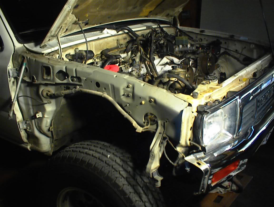

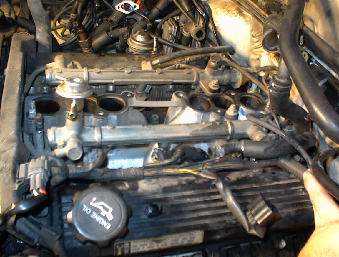

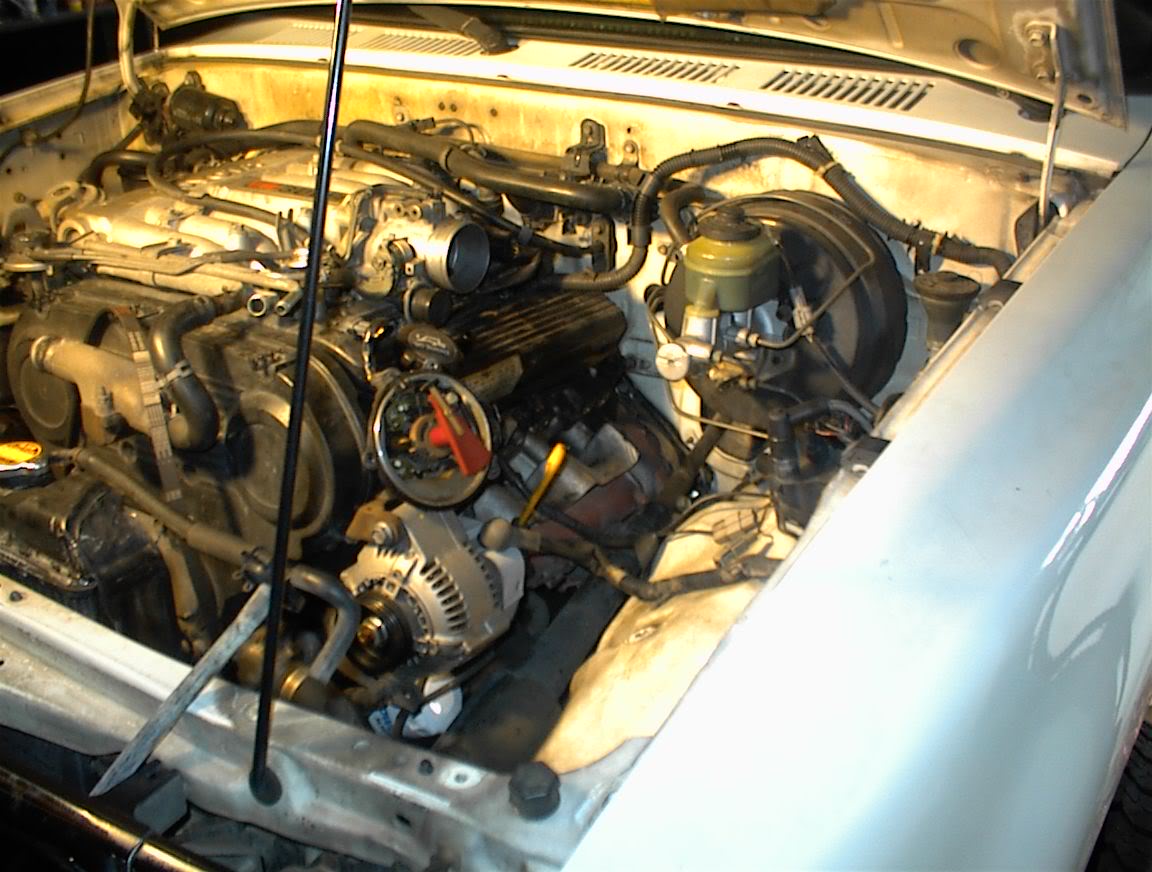

As you know I'm basically rebuilding my top end. So tonight I finally got started and took some pics. It will be slow going as I'm not a mechanic and started before Drkgypsy made it over(man is he going to have FUN piecing this mess back together with me ). Parts on order, machine shop lined up. Let the dismantling begin.
Angles of the engine area:
Room to work in:

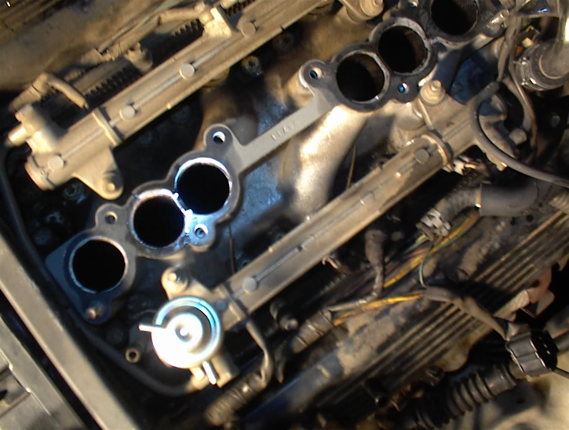

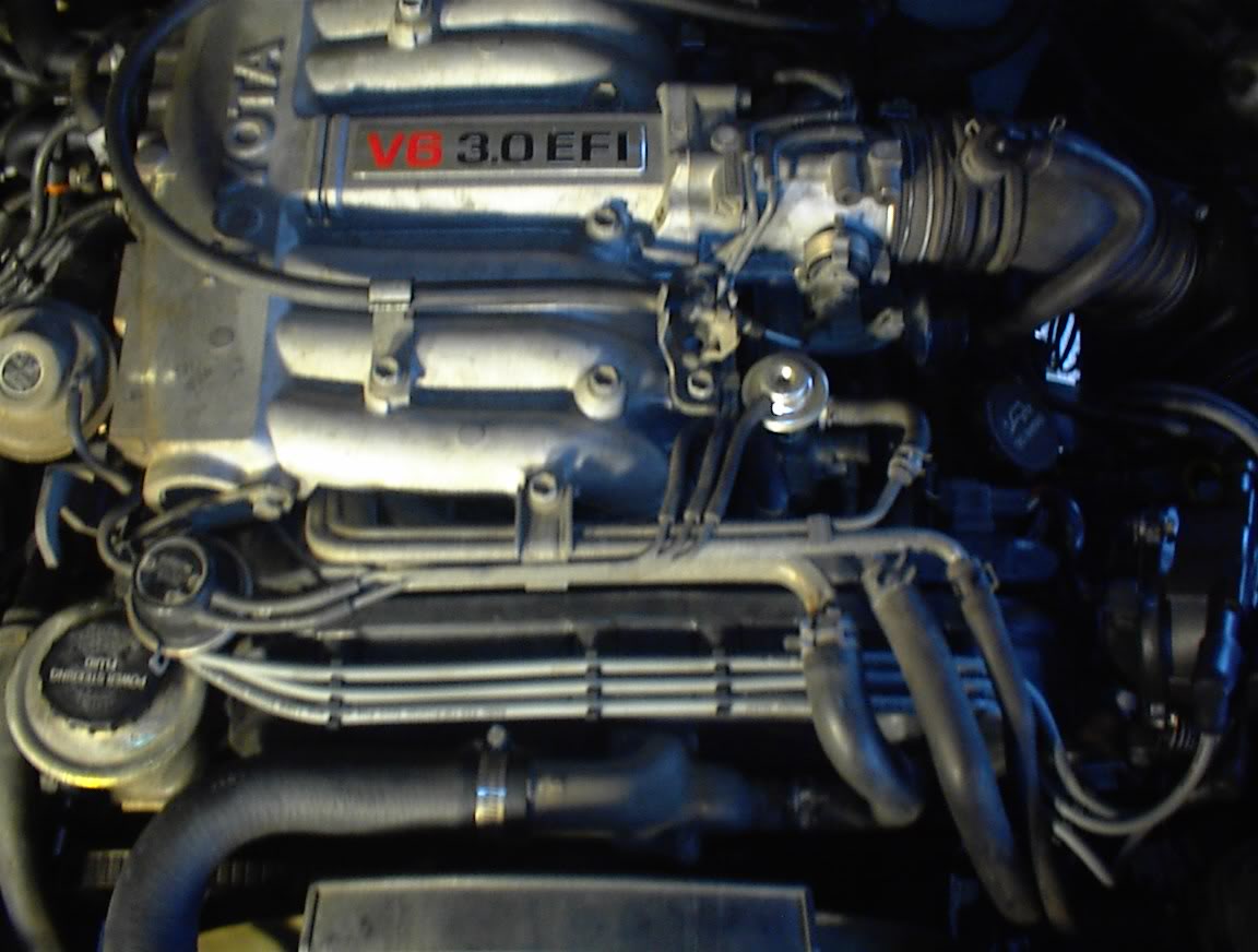

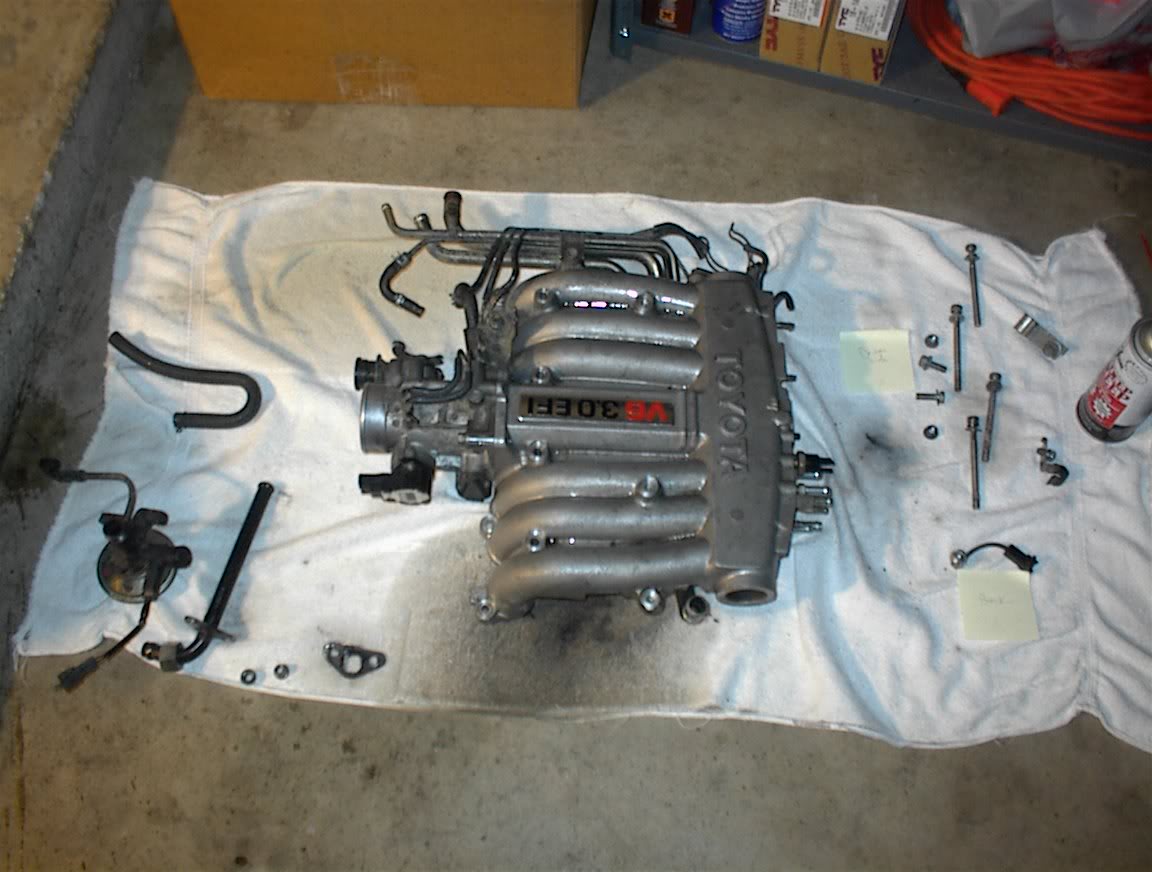

Goal to remove tonight:
Success:

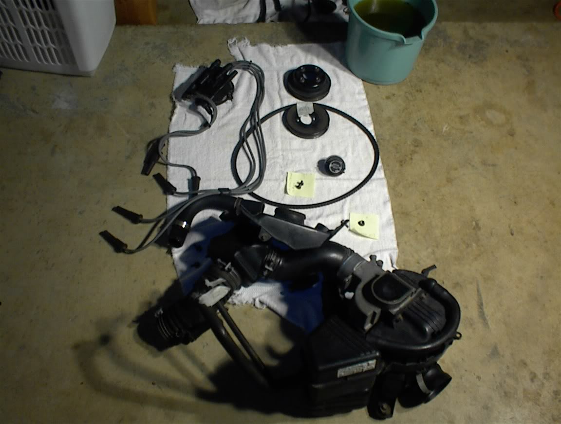

The mess:

Sorry for the large pics if needed I'll resize them.

Is it common for this gasket to be cracked into 3 pieces when you remove the air intake manifold?

Originally Posted by Morphine
EDIT:::
Yes. I've removed my plenum many times and it's always in 2-3 pieces. You oughta see what my engine compartment looks like right now. Good luck dood!

Ok, got it. Hey ChickenLover, is that your radiator I see still mounted? How did you get all that stuff out without smashing it? That's always the first thing I take out.
Old Feb 8, 2005 | 07:51 PM
ChickenLover's Avatar
Joined: Apr 2004
Posts: 2,583
From: NV
Nah, the radiator was the first thing to go. That's just the 'thing' that sits in front of the radiator. Sorry, I can't think of what it's called.

AC condensor is whats still mounted.

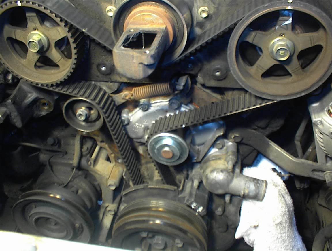

Get your T-belt off. One quick tip also: Make sure you replace your knock sensor and wire! If not it will almost gaurenteed to throw a code 52 after you get her back together. There's many ways to dismantle a 3.0, the 1st thing I would have taken off was the T-belt, starting upfront and moving backwards. It's pretty much up to you. The advice I use to give to people when taking a 3.0 apart was: take pictures and get yourself some pieces of cardboard, the cardboard was for to put the bolts from the heads in order in which they came out,and other bolts (unless your replacing them), That way you'll exactly where they go. Your doing a fine job! Good Luck!

Agreed, and yes that lower intake plenum has the #2 idler for the timing belt attached to it. Pull the timing belt like nunsa said, (after setting the engine to TDC) then attack you cam gears (goodluck hehehehehe they are nasty SOBs to get off) only then can you take the rear timing covers off, then the fuel lines/rails/injectors, then lower intake.

Ok, timing belt and accessories are next. I already set TDC and marked it, so I'm good there. I've heard from many sources to replace the knock sensor and wire now so that's been added to the list.

I have carboard and post-it notes labeling everything and my digicam is going crazy. Putting here back together is going to be a PITA.

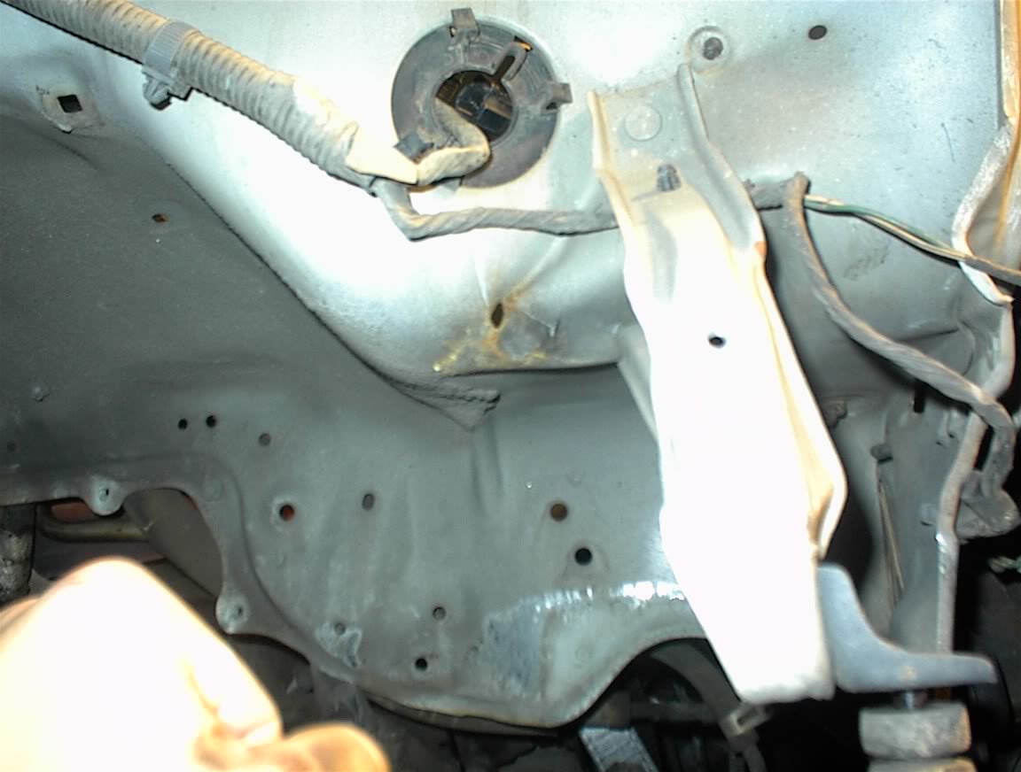

Ok, with so much torn off the engine I decided to take a stab at some body work while I'm at it. In tearing down my 3vze I've found the fuel injectors (2 of them) were held to the electrical connector with zip ties. Completely fouled up I'll be sending them for a cleaning and comlete flow test to Cruzinperformance. Heads will be going to the shop on friday. Here are some more pics...
Timing belt

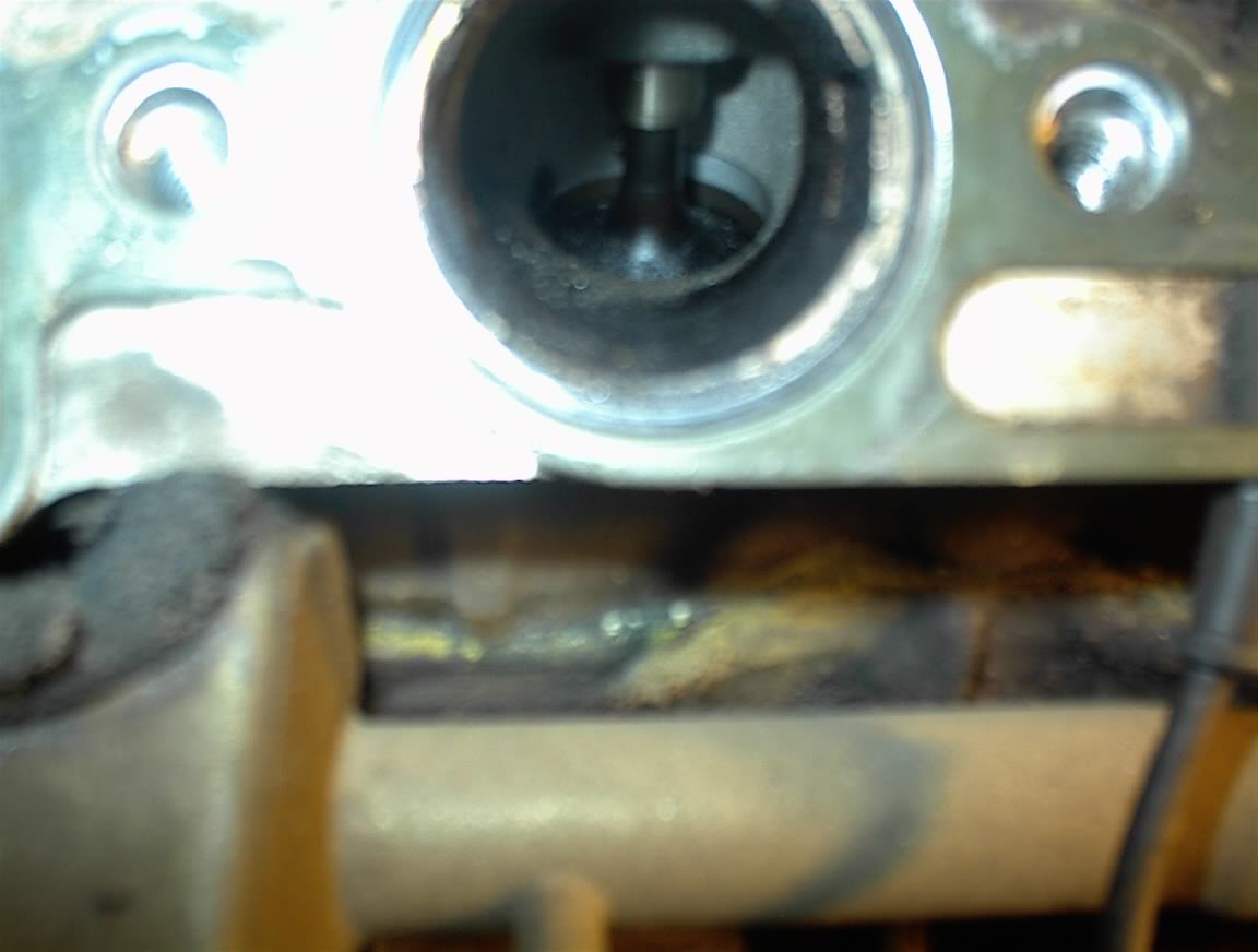

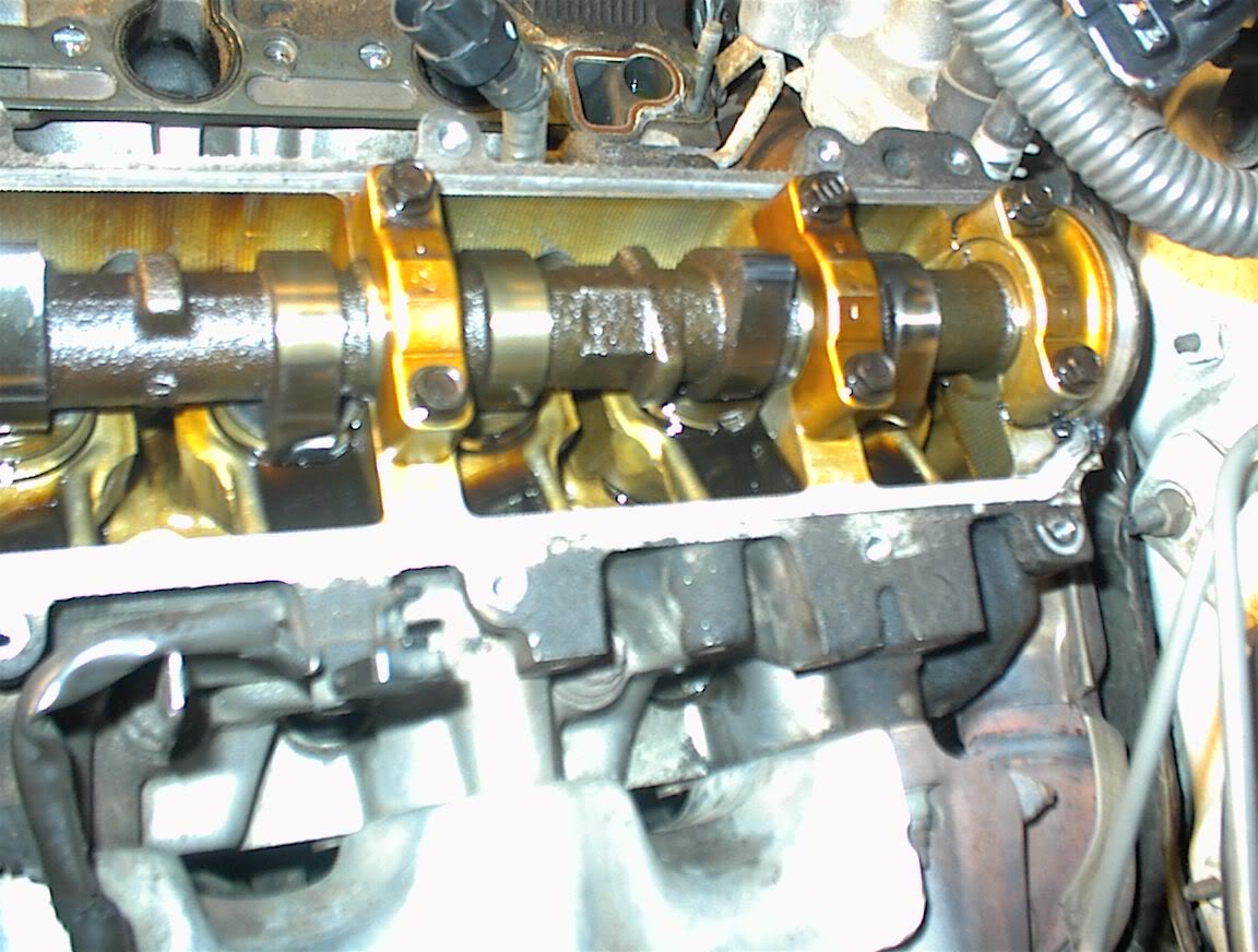

Valve covers off
Dirty and carbon/crap build up.
Start to work on the body
Close up of the dent fron behind the fender

PS - yes that's the knock sensor. You should REALLY change out those steel freeze plugs....I bet they are rusting like a mofo...
