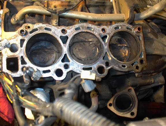

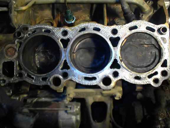

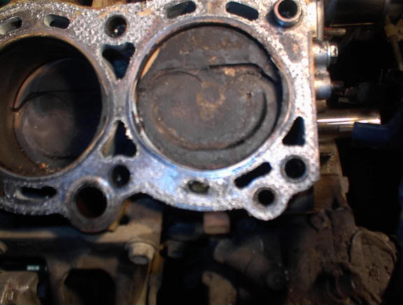

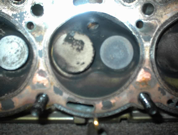

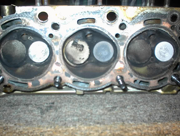

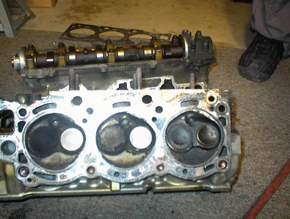

The HEADS are off
OK the heads are off...My garage is a mess....I broken down and actually bought some off my OWN tools so I wont need to borrow from friends later. The heads are off!!! The block is DIRTY and the valves are, for better words, "NASTY"
Here's the SST I used to break loose the camshaft pulleys.....My buddy Gary stopped by and was a huge help!

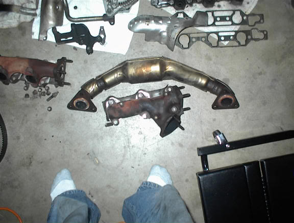

My friggin' crossover pipe...What a damn pain in the A$$. Patience and time and some contortionist stretching and she came loose. I didn't remove the crossover until the heads were off.
Below the passanger side heads:
Heads with valves:
Below the drivers side head:
Drivers side head:

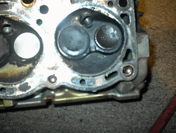

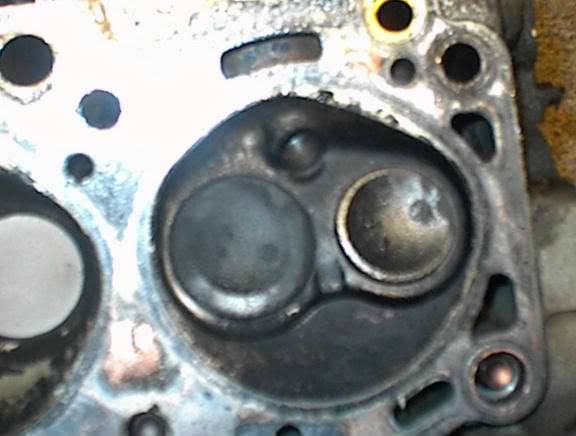

#6 valve and then the block at Cylinder #2 up close...Cylinder #6 is were my problem are.
Please comment on the shape and apperance of the block and valves. I'd like to get down to the machine shop tomorrow and have the head work done:
Surface work, pressure plated, slight over bore to accomodate the new oversize valves, valve shimmed(adjusted) and other stuff I'm not familiar with.
-=Morphine=-

Additional tools used
I ended up using a chain wrench (at least I believe that's what is called) to hold the camshaft pulleys in place, then a breaker bar and socket, then lots of force and my own SST Gary as seen above.
Red 85: good point. When I did the compression test I redid it again with teh same results. Next I squirted a little oil in the spark plug hole and retested...no change in the results letting us know that the seals are decent. I don't think that would point to my pistons but I defenitely could be wrong...I AM NOT A MECHANIC.
***please someone address this issue if you could***
After looking at the above images it may as well be my pistons.
Thanks for all the support my fellow YOTATECHers.
the journeys is only 45% done now...stay tuned for the other 55%
-=Morphine=-

I just got mine back together tonight and everything seems to be working fine. I'm sure the tops of your pistons could use a good cleaning. I actually used my dremel on mine and it worked nicely. There was a ton of build up on my pistons where the valves seat on them. I also had to replace all of my valve cover bolts, the originals were breaking left and right (before getting to 5ft/lbs). I had some problems with 3 of my intake manifold bolts not tightening. I had to go buy longer bolts that would reach better threads. So, heads up on that stuff.
I was relieved to find out that the OEM headgaskets have been redesigned since 1995. My gaskets looked exactly like yours and in my pic below you can see what the new ones look like. I've been at it for 12 hrs today, so I'll try to remember some more tips tomorrow when this headache is gone.

I do not think that there is a means of checking for a ring problem when the HG is shot. You should have seen nice number for the odd side that did not have the bad hg, all bets are off for the side with the bad HG. I have yet to have to replace rings on a HG that was caught early. I think that your was caught in time and not run after so you should be okay with the rings you have. IF you use the dremel tool to clean all that up which you can, be careful not to take up too much of the metal as that is a mating surface and it has to be reused. When I do mine I use a fine grade oil based honing stone (normally used for knife sharping) a very light machine oil or a half weight eng oil. Use of a 6 inch stone in an eight pattern almost makes it impossible to create a low spot however the stone will do nothing for the piston tops for those I use a soft scrub pad (the wife hates it when I take from the kitchen) and the same light weight oil. Not as shinny as the one pictured here but it works well.

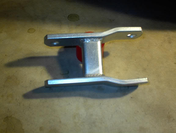

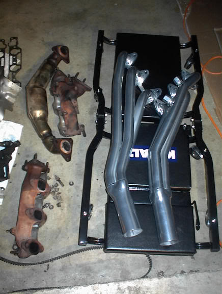

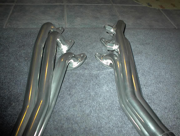

Updates

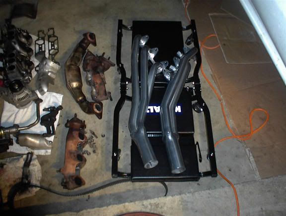

OK, heads are at the machine shop and should be ready Friday. Bruce at partsdinosaur is awesome. I'd highly recommend him and his company for gaskets and various items. I ordered the full gasket kit and being the noob I am, when I dropped the heads off I forgot about the vale seats. So I go back to his site and order them. Within 10minutes I have an email from Bruce informing me that they are included in the Full gasket set I purchased the day before. Now Bruce knows I'd like to get these as soon as possible and when he found out that I was in SoCal, same as his distributor he made arrangements for them to ship the products directly to me instead of his store shipping them from out of state. Awesome service and support.
Next I found my Downey headers localy (within 45 miles) and at one hell of a price. Downey Ceramic headers, new in the box with all mounting supplies and the Smog sticker for $155 cheaper than Downey directly.

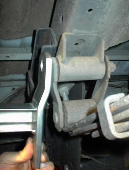

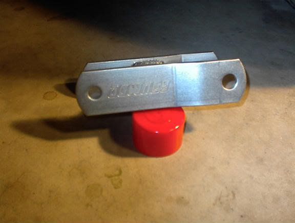

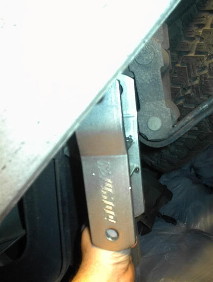

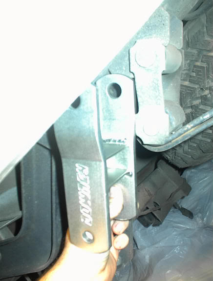

Now with the money saved, I picked up some Downey HD shackles.
And finally some pics.
Headers
Old exhaust manifolds and crossover next to the headers:
New shackles and a comparison to the stock setup:

I see those headers...hey just for you buudy...dont put those things on your truck. your truck is way to good for such a thing, Come on they are not even shinny enough to comb your hair in.......just send them over to me in Japan, and then you can get something that your truck is worthy of.....hey may be after you ship those downeys over here to Japan I will have my stockers chrome plated and I send to you......think about you would be the only guy on your block with chromed stock 3VZ-e headers....you can't go wrong with a deal like that.......
okay maybe it not such a good deal for you....what can I say...NICE, VERY NICE
