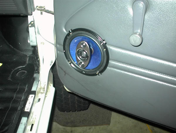

6.5" in the door panel. I will be redoing the door panels to accomadate a better look and fit for the truck and the speakers.

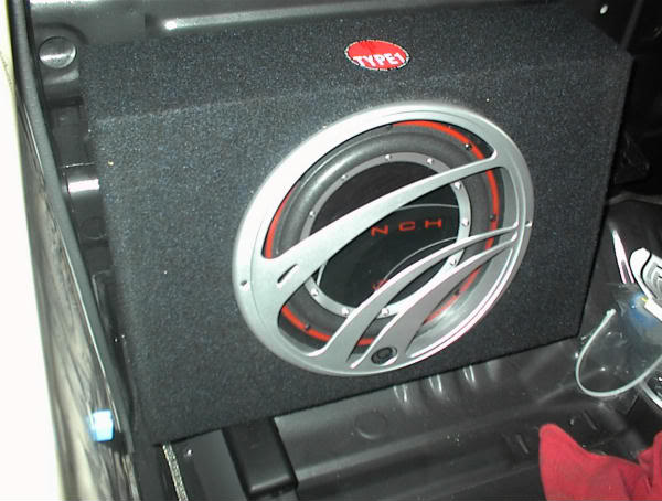

Sub, Rockfordfosgate P1 punch 10" in a qlogic truck enclodure. This will be behind the passanger seat and this is only a test fit for now.

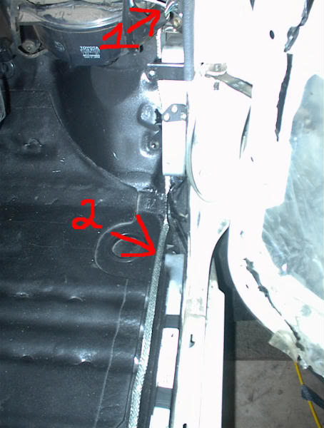

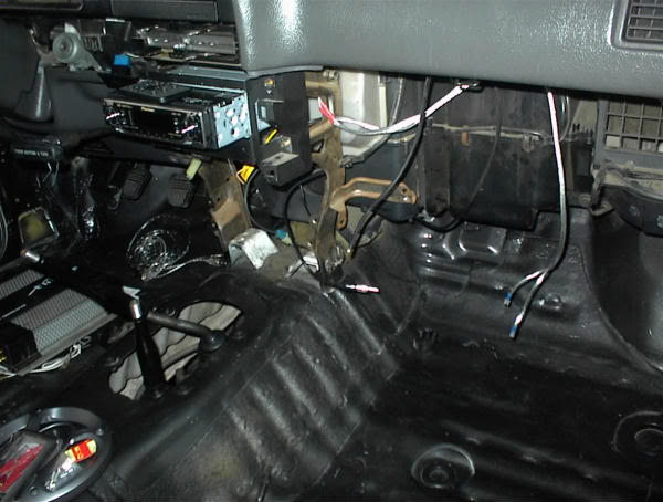

For the amp install, to run power I used this grommet in the engine bay to feed the 4ga power line through and will most likely run the line were it is shown it the picture only securing it though.
Area 1,) shows where the line comes into the cab. Area 2.) is where I'm thinking of running the line under the carpet to keep it out of the way. Any input on these would be greatly appreciated. (Bumpin'Yota, I sent you a PM regarding this).

I think that is a good a place any to run the wire throught the FW, the path down the door jamb is where almost everyone else goes as well. To me and IMHO your on target with the install.

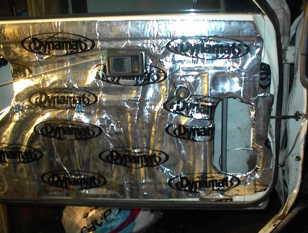

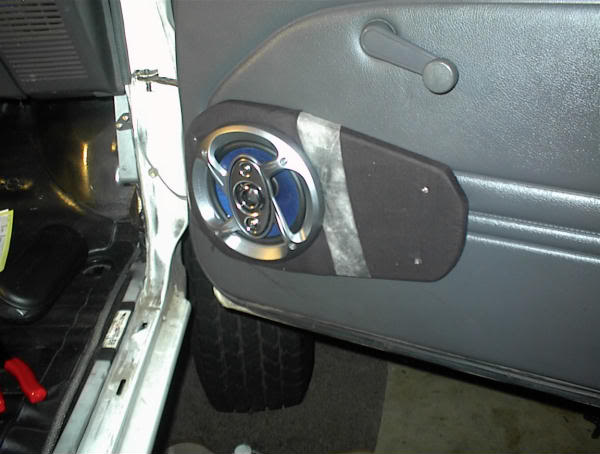

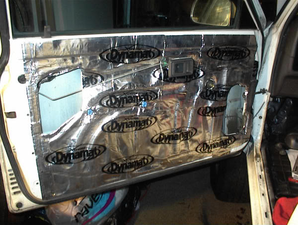

No really, I used Dynamat on my door panels and finished my custom speaker pods (more like panel extenders to clear the magnet). Take a look below and telll me what you think.

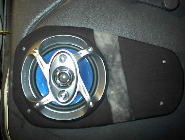

Custome door pods, two tone fabric, my first attempt and I'm damn happy with them and the sound. (mickey mouse ground to test stereo)

Nice install! (BTW, did you see my soundproofing install on p.2 of my sig home page?). As for grounding, you can also ground to the frame as far as I know. I have a 4g ground to the engine, and 3 other 10g grounds going to the frame and 2 body locations. I will just let the elctrons pick which way they want to go and they are happy.

Morph, dont know if this would be any help to you or not, but when I had my std cab and put a system in it, I ran the power cable from the battery, down the fender well, underneith the truck and then up into the cab through a rubber plug thats already in the floor of the cab. It put the cable comming up behind the seat. The cable was ran in custom bent pvc conduit from the battery down under the truck and ended where the cable went up into the floor. It was 1 guage welding cable from a welding supply place. Worked like a charm for many years. I pulled it all when I sold it.

Thanks for the input williemon, but I'm gonna leave the 4ga power line going through the FW where it is in the pics. Seams to be working fine for me. My only question now is what bolt to use to secure my battery's ground cable to the block. Any one, please, help
