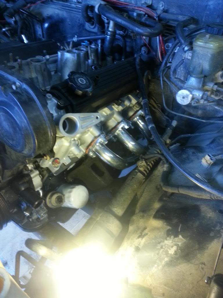

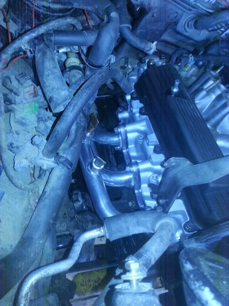

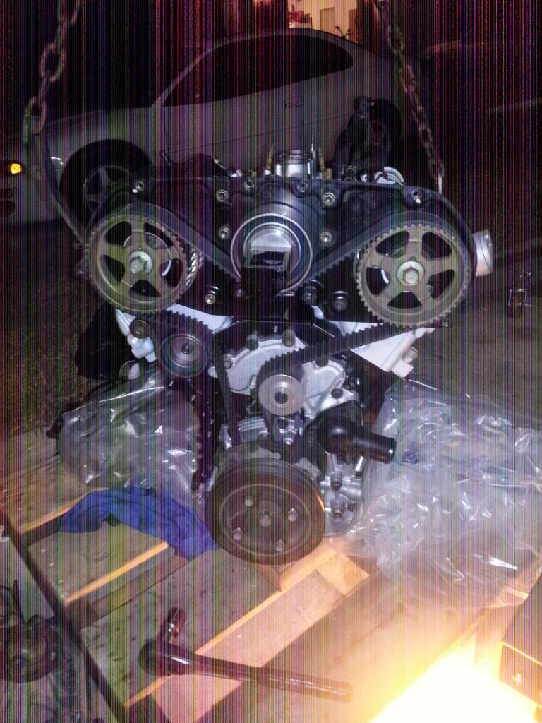

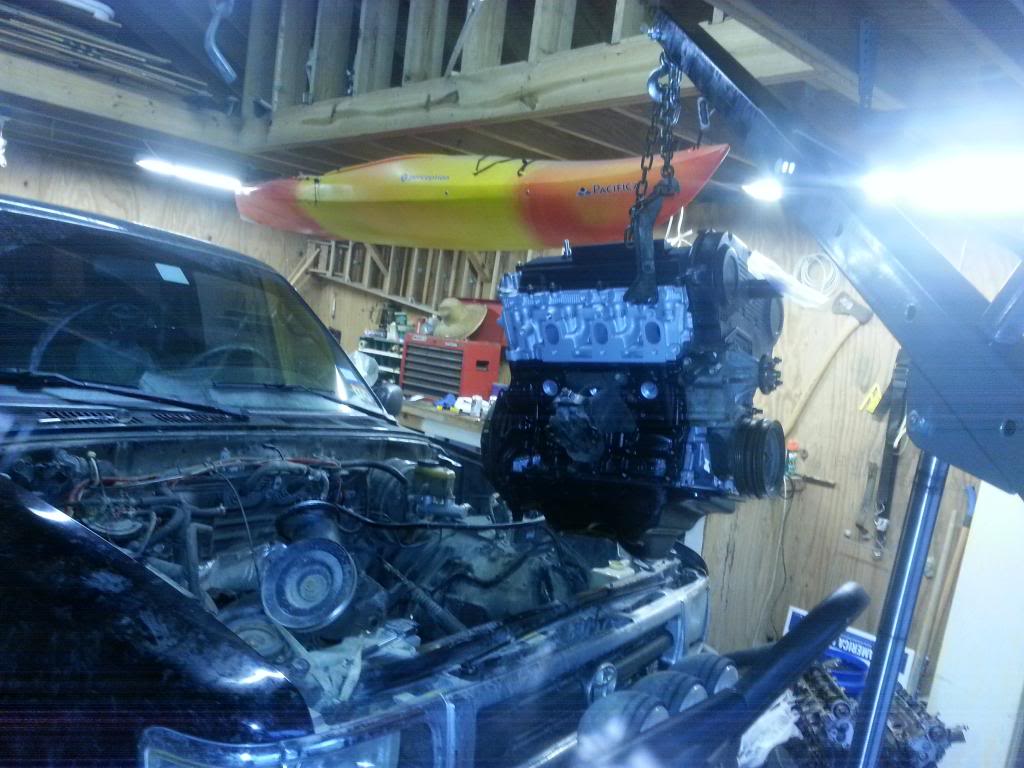

Got the timing on a few nights ago! And got the engine installed yesterday. 1 more full day and I hope to be finished!
Got a free pipe for my isr!!
Also decided to run dual oil filters.

Its lookin good!! that's one clean engine! (better be for brand new right?)

Looks like you're running two oil filters as well. I always knew the 3VZE had two oil filter bosses but I have't seen a block yet with both of them machined to accept two oil filters. Or are my eyes deceiving me?

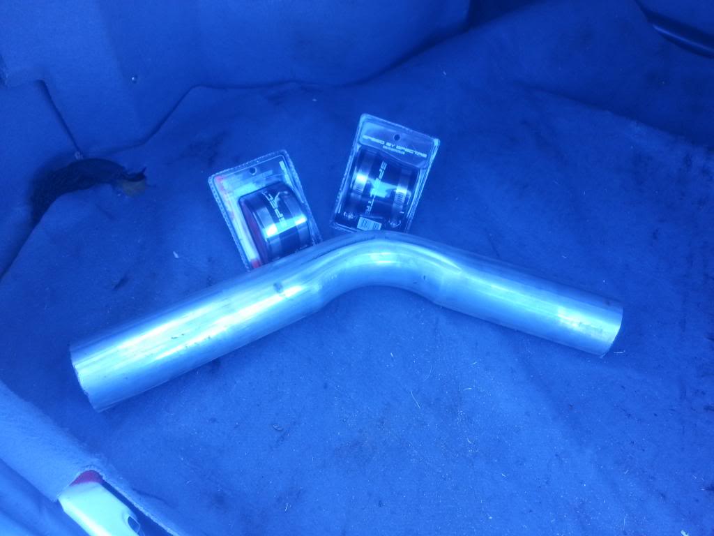

Originally Posted by 95blackToy
That pipe will actually REDUCE your hp. You need a mandrel bent 45, not a crush mandrel bent 45.
AKA http://www.summitracing.com/int/part...1437/overview/
The crush in your bend reduces the flow significantly and will create turbulence. you are better off using the stock pipe.
Engine looks great BTW.
