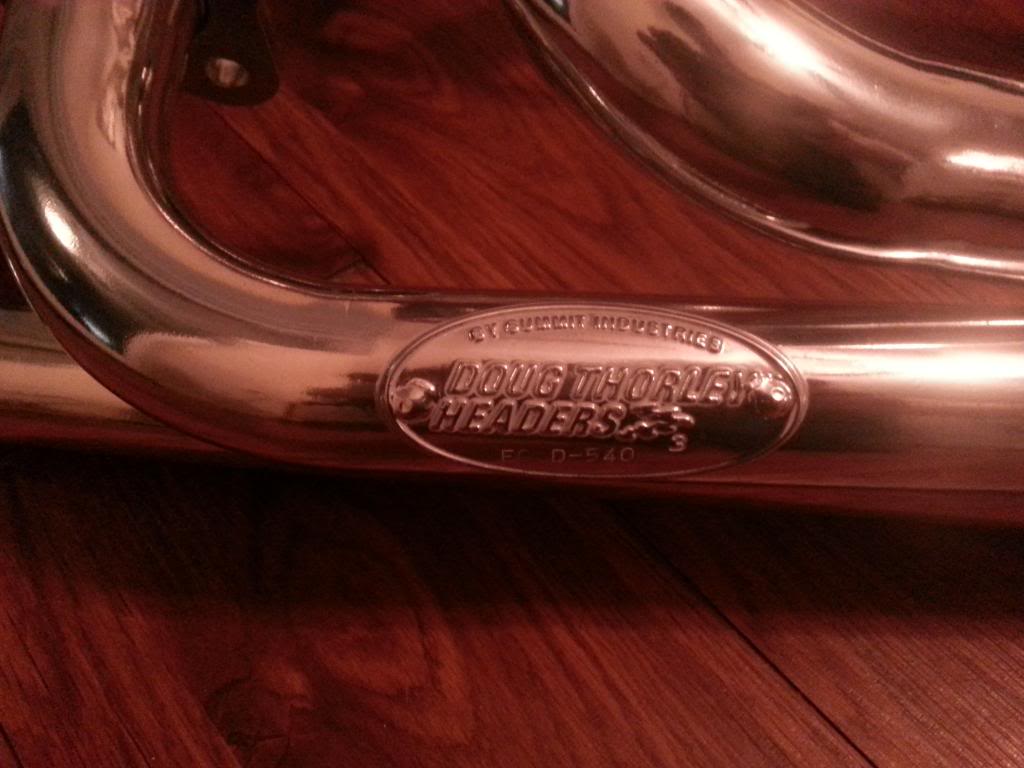

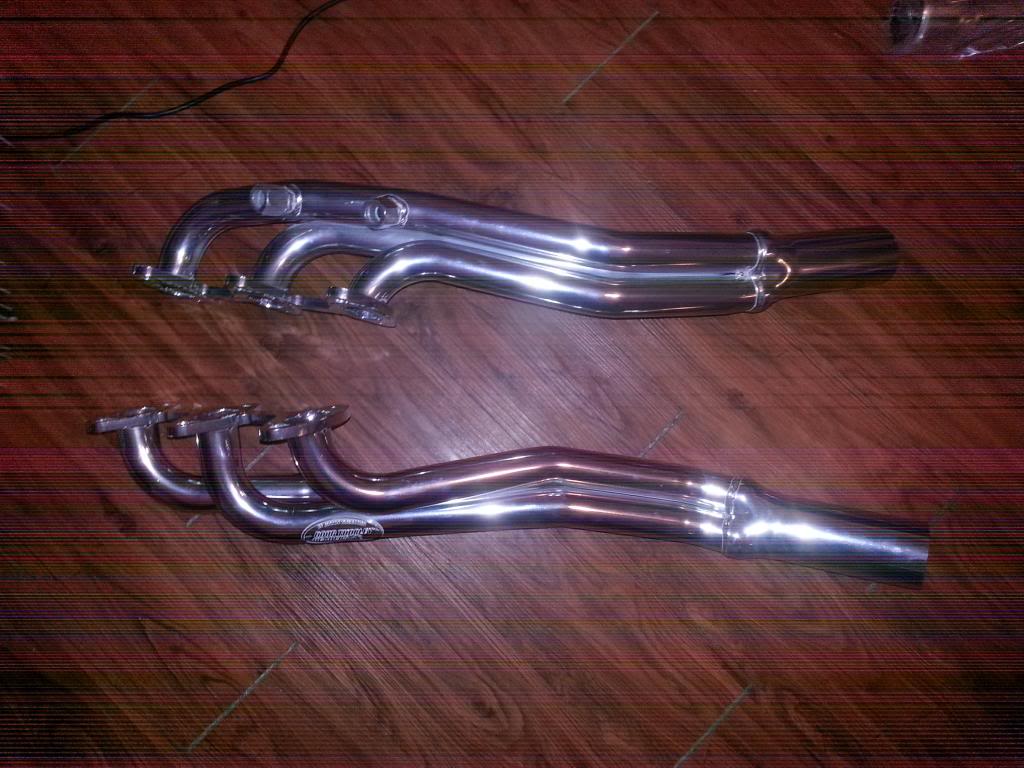

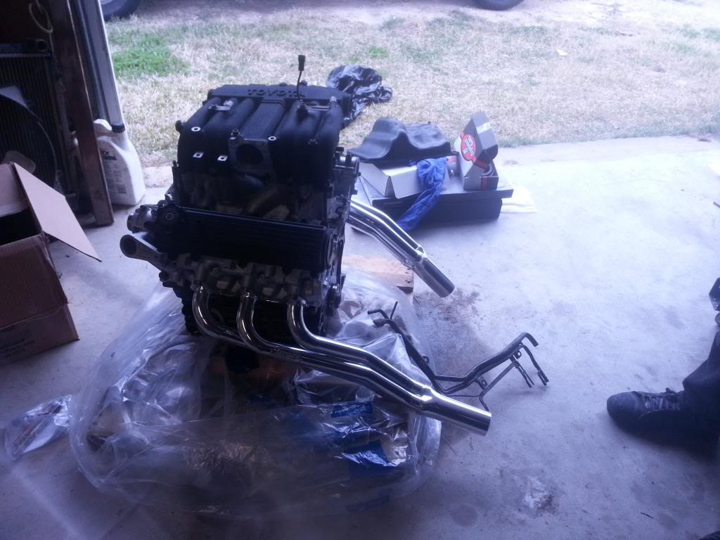

My question is is it possible to install headers with engine out and drop engine in with headers already installed?
Would I risk damaging something? or the headers themself?

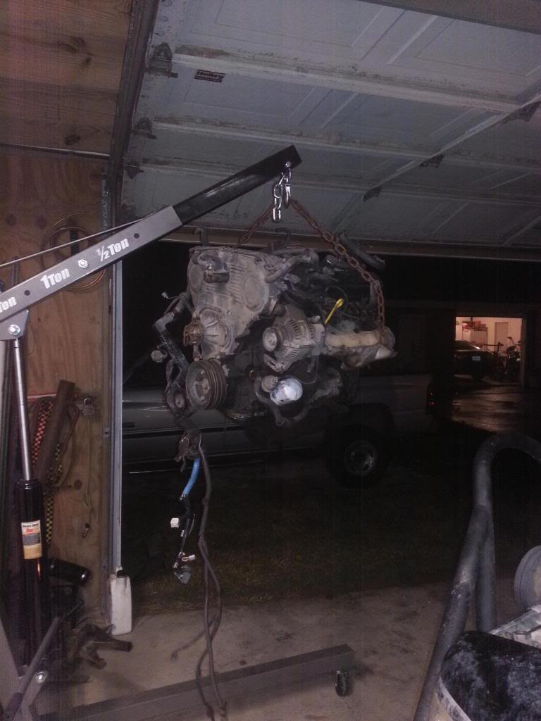

Engine Out

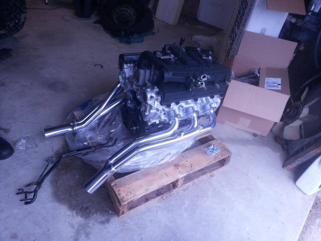

Headers

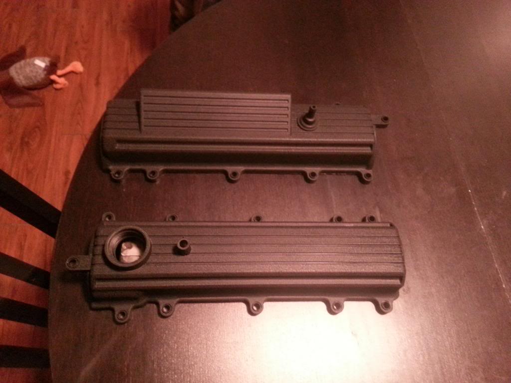

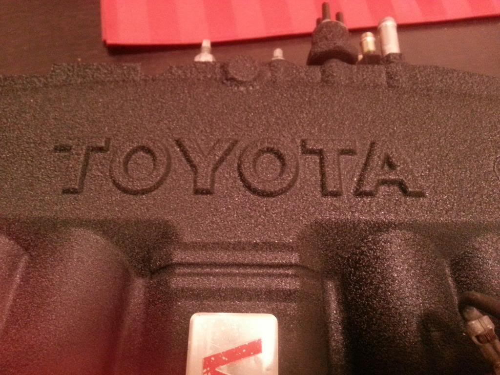

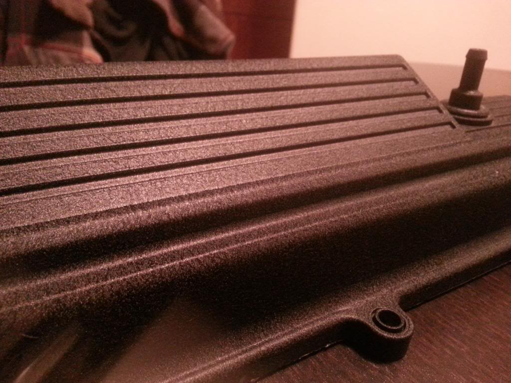

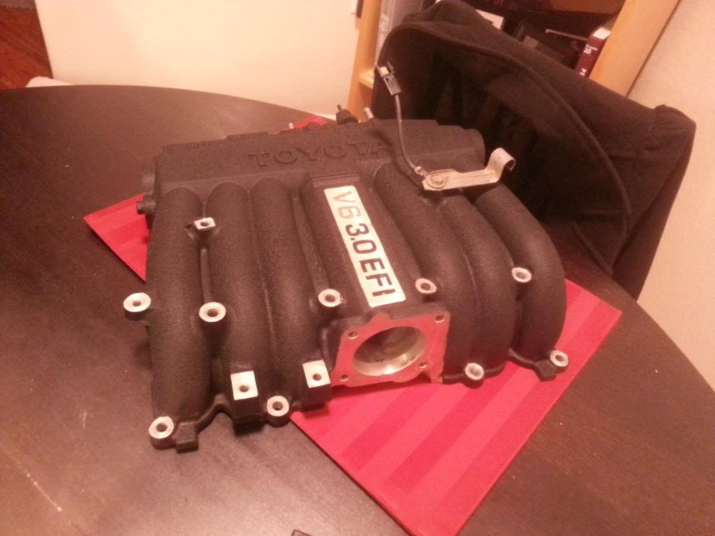

Painted my intake and valve covers with black wrinkle paint.
Going to sand TOYOTA logo with a sanding block for a nice brushed aluminum look, hopefully they will last and wash off easily.

Actually not powder coat. Its VHT wrinkle paint, I sprayed on really thick and then put it in the oven at 200 for like 3 hours. Takes about 24 hours to fully cure.

Looks good. VHT honestly needs the oven to cure correctly. it should hold up.

Mak, I've seen your exhaust thread. Do you think they would slide in with engine?
Old Mar 7, 2014 | 08:38 AM
MaK92-4RnR's Avatar
Joined: Mar 2008
Posts: 6,059
Likes: 101
From: Sacramento, CA
Originally Posted by 95blackToy
That's what I found about the vht as well. I painted and ak47 I built with their 2000 degree paint. Holding up awesome.
no idea, it was a tight fit when I did it with the engine in there. They might or might not. only one way to find out!

I'll probably set engine in and install headers in engine compartment just not all bolted down.
Thanks for the input!
Excited about the new engine! Should run pretty good!
Anyone else installed headers with engine out of truck?
Old Mar 7, 2014 | 10:29 AM
250000_yota's Avatar
Joined: Sep 2007
Posts: 919
From: Longmont, CO
I was able to pull my engine with my Downey headers still installed but putting it in might be quite a headache. I think you'd be better off doing them once the motors set in with everything out of the way.

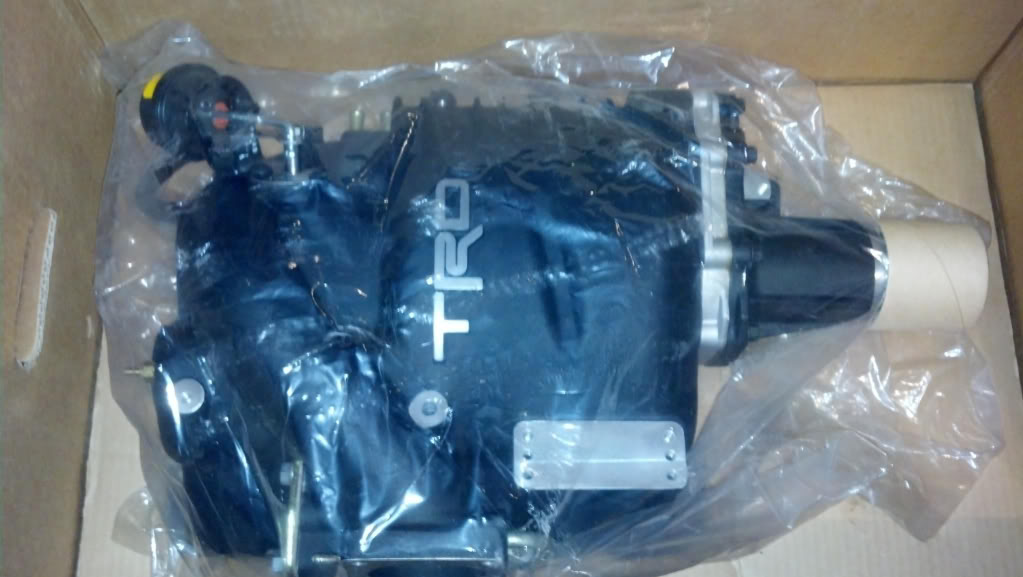

And that wrinkle paint looks amazing on that intake. Should look even better with the Toyota sanded. I love contrasted looks like that.
Actually, it'll look very similar to the TRD superchargers nowadays.

That's probably what I'll do! Won't have hassle of removing the original exhaust setup. Thanks for the compliments!

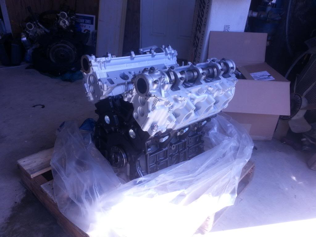

Old Mar 13, 2014 | 09:30 AM
95blackToy's Avatar
Joined: Dec 2009
Posts: 754
From: Pearland, Tx
Size:  67.4 KBEye candy!!

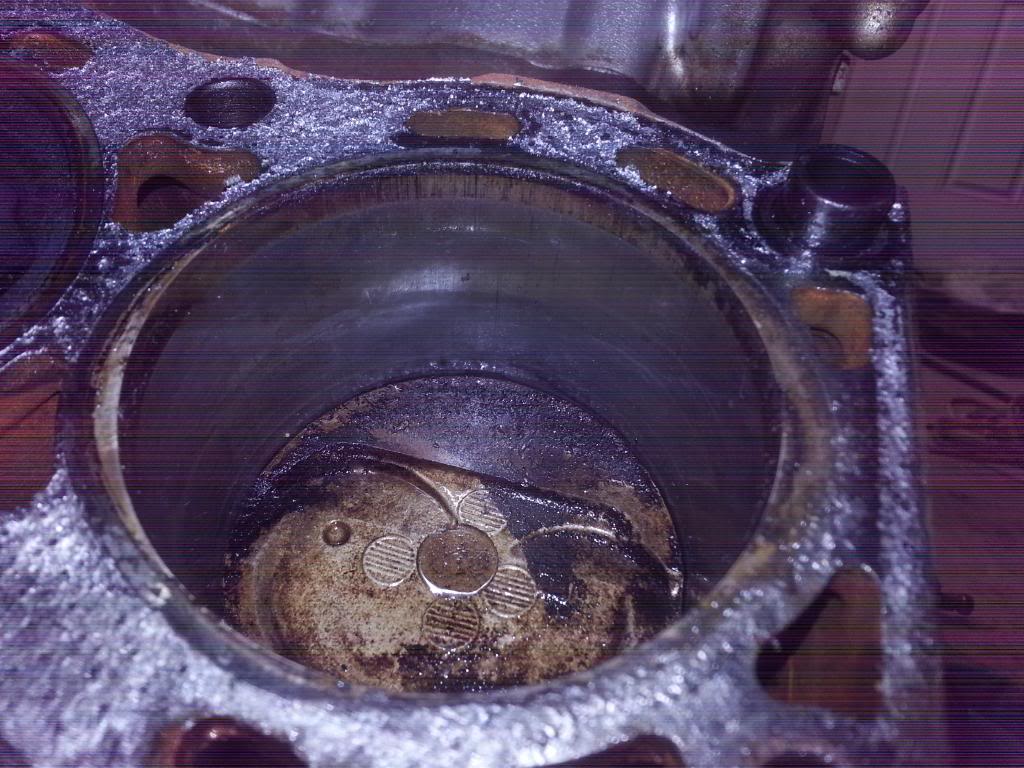

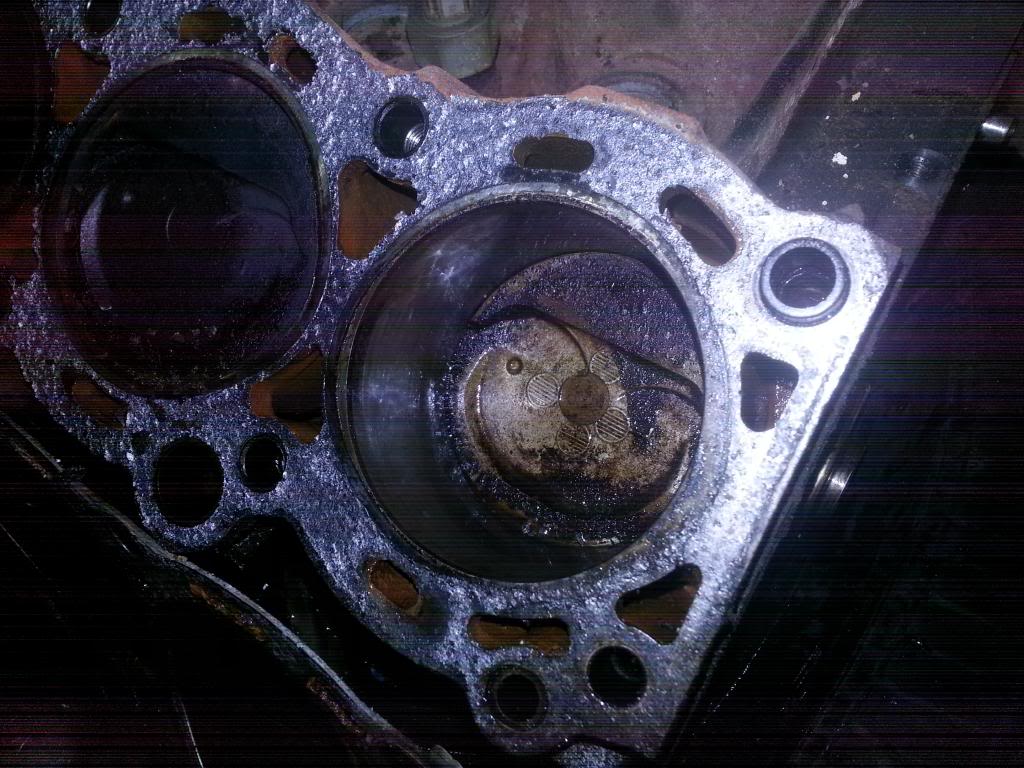

Old Mar 15, 2014 | 02:01 PM
95blackToy's Avatar
Joined: Dec 2009
Posts: 754
From: Pearland, Tx
Here's the blown cylinder

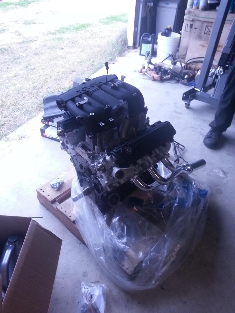

Mocked up the new engine

Old Mar 15, 2014 | 04:34 PM
ksti's Avatar
Joined: Dec 2011
Posts: 1,388
Likes: 8
From: CA, Until TSHTF!
The mock-up looks great!
Get that bad boy in (this weekend) and let us know JK lol
