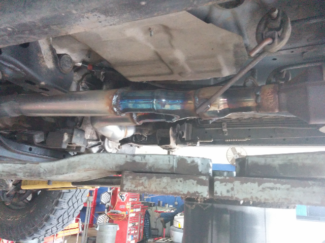

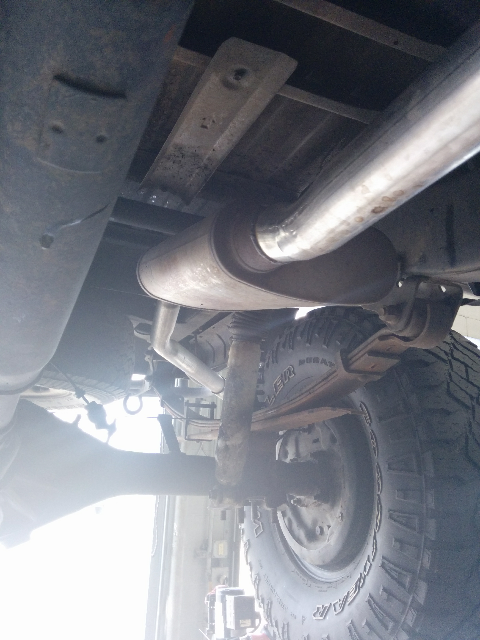

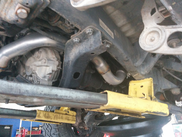

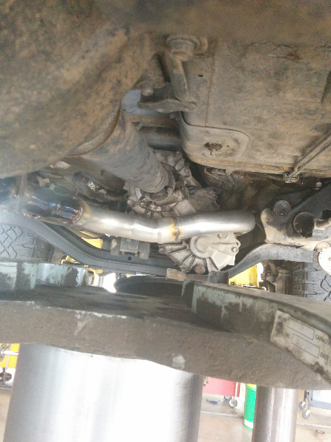

Definitely a code 52. Read it like 4 different times, but I did get pics of the exhaust setup.
They did an awesome jib used the same y-pipe and o2 bung because I didn't want to pay more for them to make custom ones. Had them rout it around the transfer case.

I hav the thorley headers, with a custom routed down pipe and y. The down pipe on passenger side goes between the transfer case support and the body right next to the tcase. Then turns right and goes into a universal aftermarket cat and a magnaflow muffler.
Alvin muffler in Alvin Texas did an excellent job if anyone reading this is any were near the area.
