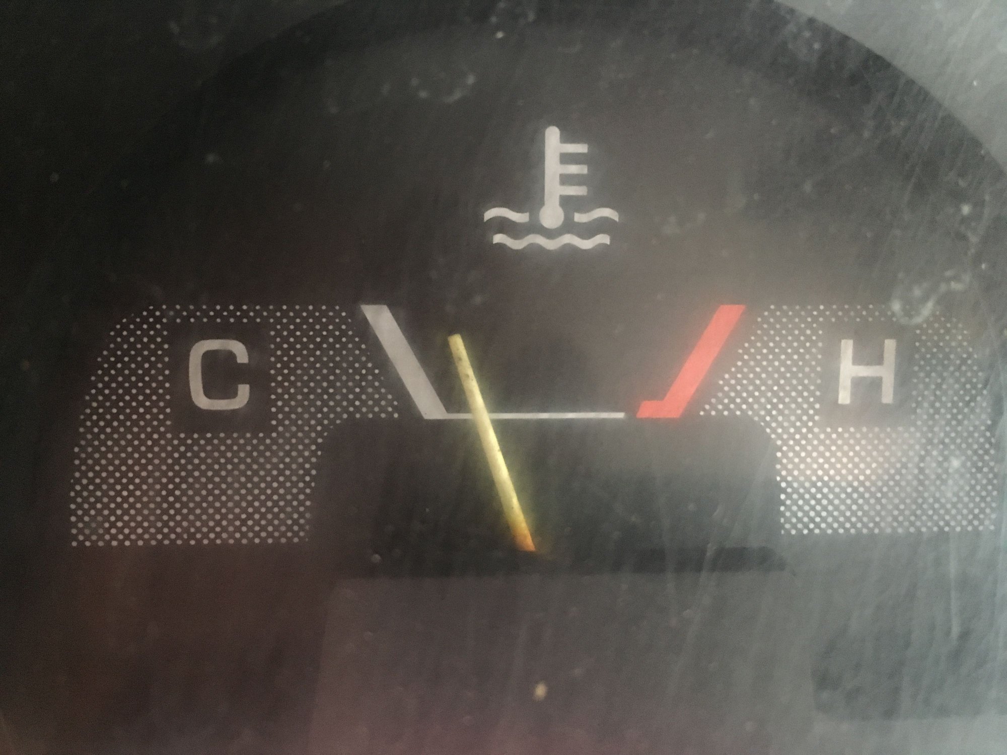

Hey guys, I’m having an issue with my truck not warming up to operating temperature, on the highway, the gauge just creeps over the white line and in the city and at idle, it goes up to about 1/3 but never reaches up to operating temp like it used too, changed the thermostat, any ideas or thoughts ?

My 92 pickup never goes past 1/3 unless I get on it real hard. Then it will creep up just a little bit, but go back down to about 1/3.

This was driving for a while in the city, and on the highway it goes even lower, is that normal ?

About 1/3 to 1/2 up the gauge is what many people see when the engine is up to operating temperature with these gauges.
Your gauge is definitely on the low side.
Now we need to figure out if the engine actually running on the cool side, or if the gauge not reading accurately.
Do you happen to have an infrared thermometer gun?
If you do, you can point it at the thermostat housing and the top of the radiator to get an idea of how hot the coolant is.
Which thermostat did you use? Toyota says it should be rated at 88°C or 190°F.

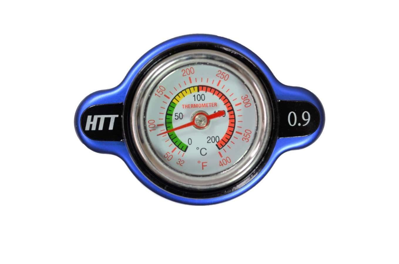

This is good too to confirm gauge/sender in truck is correct, it was the right size for a 4wd stock '92 radiator:
https://smile.amazon.com/gp/product/...?ie=UTF8&psc=1

Nice find, Paul22RE!
