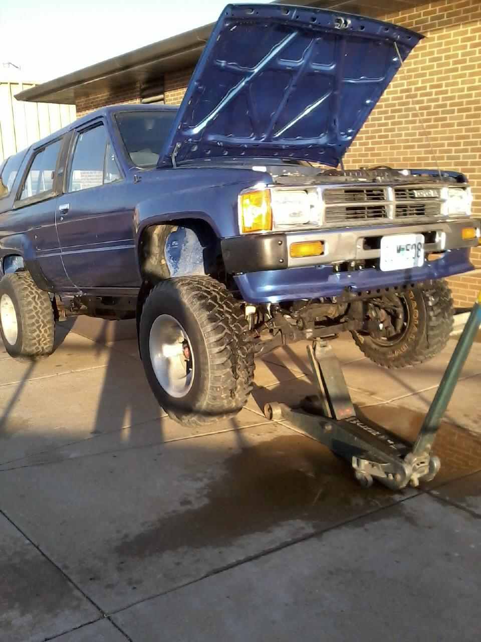

Here is how I burp my system, raise as high as I can and run without radiator cap for about 15 minutes to rid the system of air.
