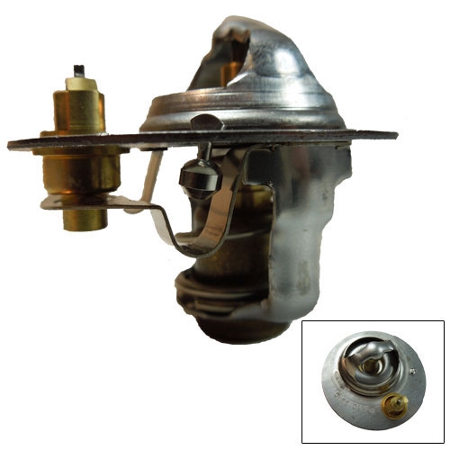

OEM Dual-Stage T-Stat looks like in stock photo.
Some may come in "Toyota" packaging. Actual tstat I got from LCE is shown in TAMA package, according to LCE is the manufacturer for Toyota.
