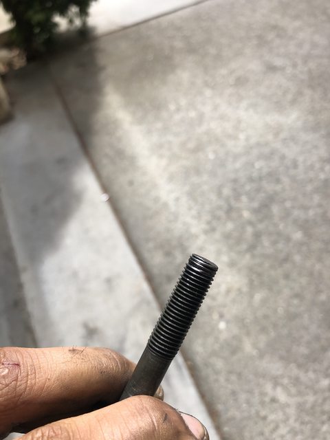

Well this was definitely my fault... definitely will do a better job cleaning and blowing stuff out of holes when reassembling.

We all have tap and dies to fix our mistakes. Along with helicoil sets, smoked drill bits, and abused vise grips. It just happens. Almost everything is fixable, thank god.

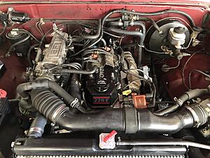

Well, some good news! I was able to borrow an M10x1.25 tap and ran it all the way down. I noticed the hole went a lot further down than the length of the bolt, so I replaced the 60mm bolt with a 75mm one and was able to torque it down to 29 lb ft without any issue.
The engine is mostly back together now (just have to tighten the belt and replace the fuel filter and add fluids), but to be honest this is the biggest job I've ever done and I'm pretty nervous to even turn it on. I keep having a recurring dream that the temp gauge will end up shooting past halfway again...
