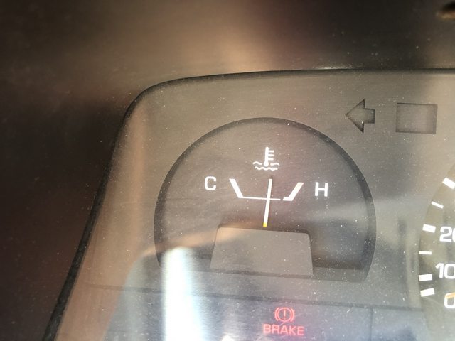

I've been driving the truck for close to 1k miles, and am curious about the temp gauge (still). Sometimes, even on hot days, the temp gauge will sit at below halfway and I'll think nothing of it, but other times, even on cooler evenings, the temp gauge will be just above halfway, like this:
From what I can tell, the coolant level seems to have stopped fluctuating in the overflow bottle and the truck runs fine otherwise. Part of me is wondering if it's a bad fan clutch, but the truck is so noisy while driving that I can't tell if the clutch engages when it's supposed to. The fan clutch is also a new Aisin unit from Rockauto (so hopefully no counterfeits there!).
If I turn the truck on with the hood open and let it idle, will the engine get warm enough to engage the clutch, and will it be obvious if I'm standing right beside it?
Anything else worth checking, or is this all in my head?
Thanks for any (more) help!

There’s a audible difference when the fan clutch locks, but just letting the vehicle run at idle probably won’t generate the heat needed. You’ll need to raise the rpms.
The clutch usually works in city, stop-n-go type driving where the engine is working the hardest and there’s not much air flow.
The gauge seems to go down a bit once I get off the highway. I haven't had any issues in stop and go traffic (though due to shelter in place there hasn't been a whole lot of stop and go traffic).
I think I'll keep driving it and see if the gauge ever creeps past that level. It does seem happier cruising at 65 mph than 70+. Maybe the radiator is the limitation, in which case I'll probably get a CSF 3 row radiator for it next year (along with new hoses).

If it’s not losing coolant and has a fairly new OEM thermostat than the radiator starts falling under suspicion.
Make sure you do both lower radiator hoses. Everyone sees the one going to the bottom tank, but it’s the second one under the alternator that tends to soak up any leaking oil and burst. Not the most fun to replace, either. But essential.
