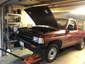

This is how I've been (trying to) bleed the system:
Regarding the heater cooling the water down too much before getting to the thermostat, I thought that could have been an issue, and bought the dual stage Toyota thermostat that allows it to open at a cooler temperature. Even with that dual stage thermostat in, the upper radiator hose doesn't get hot.
I will try cycling the heater a few times and also use an infrared thermometer pointed at the head and thermostat housing and update the thread. I'm thinking (and mentally preparing) for it to be a head gasket issue, though.
