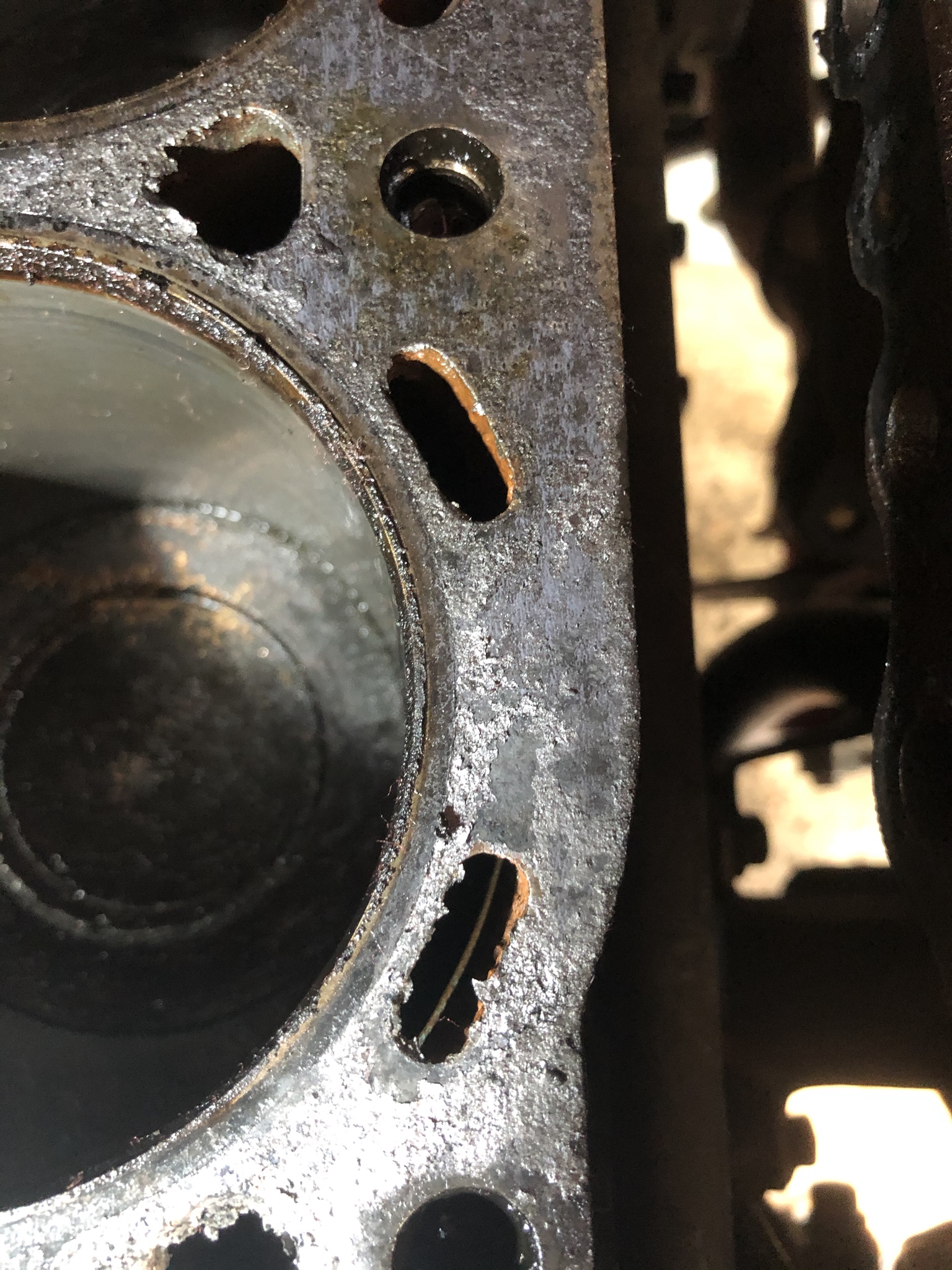

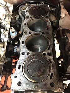

Originally Posted by Jimkola
It was hard to tell by the one photo if there was something in the water jjackets. A few did look odd towards the rear, but closer photos of the gasket and the block surface before cleaning would be nice.
I peeled the old headgasket off and the block does look a lot cleaner than I thought:
It still needs some cleaning for sure:
Unfortunately the oil pan is stuck on there super well from when I removed it and put FIPG sealant. I couldn't get it off today so I'm hoping I can somehow pry it off tomorrow.

Those passages look ok. As a side note from what I can see the cross-hatching on the cylinder walls look very good. I can’t see the thrust side, but still.
