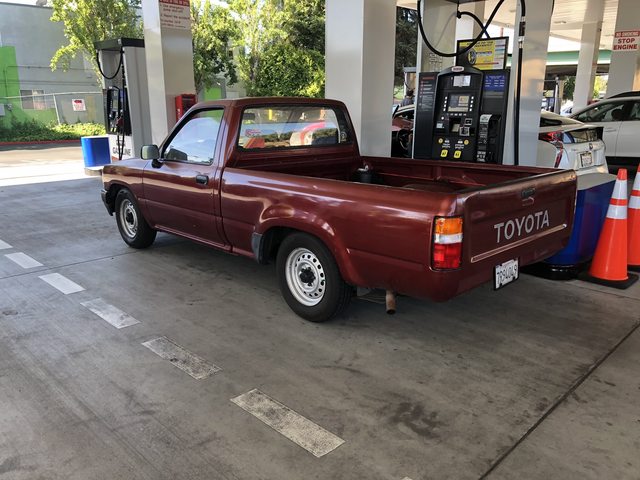

Update: Truck is running great! I got it aligned and the temp seems to be holding, even in the 90+ degree weather we had over the weekend.
This weekend hopefully I will be able to get the OEM Toyota coolant sensors and put some actual coolant into it. Thanks for all the help!
(ps I still need to check the difference between the upper and lower radiator hoses for the other member who asked).
