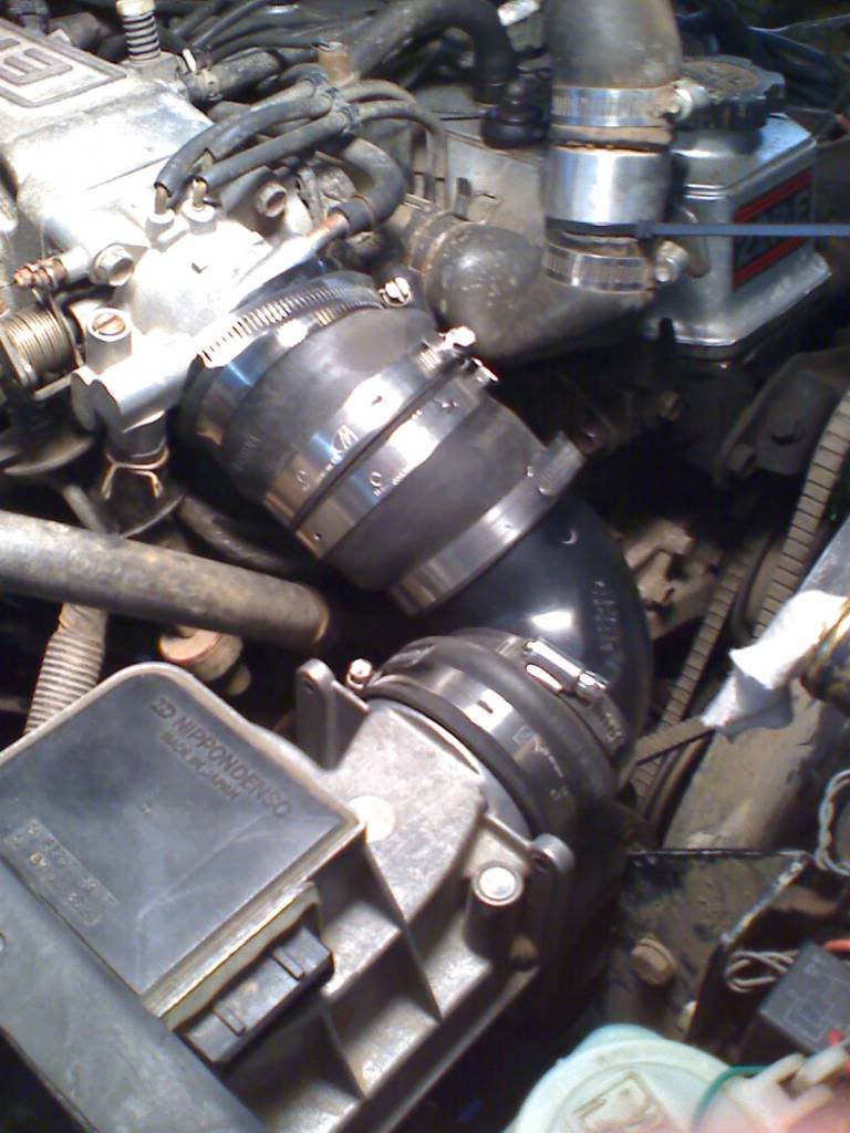

You can put it in the upper rad hose:

BigBluePile,
Did you build that coupler in your upper radiator hose? What's it made from?

Originally Posted by Beefmaster
BigBluePile,
I ordered mine thru LCEngineering but you can make your own...or ebay!!
