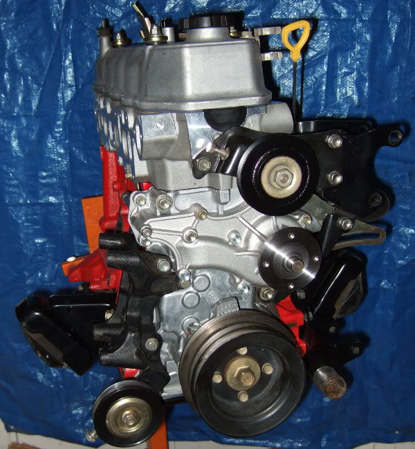

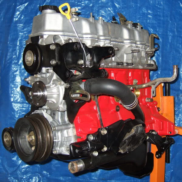

It's starting to look more like an engine. These pics aren't the best, but they'll have to do. I may paint the valve cover later, but probably not.
I haven't decided yet whether to have the alternator rebuilt. It's filthy from a leaky front seal, and I doubt the brushes have much life left. One local shop wants $95, and another said $65 to $130 depending on what it needs.
I need to get a new A/C idler pulley bearing. My original went out years ago and was replaced with a super cheap non-sealed POS. It squeals when wet. Apparently the A/C idler bearing is different from the top one. From what I've read, it needs a SKF 63012ZJ or Timken 301SS. Both are over $20 at Checker. Ouch. Any ideas where to get one cheaper?
I moved the passenger side motor mount rubber part to the driver's side. The old, cracked driver side rubber sits a bit crooked, like it has been squished over to one side. I might have to spring for some new ones. New or old, I'll probably chain them. Gotta figure out how exactly I want to do that in case something needs done before the engine goes in.

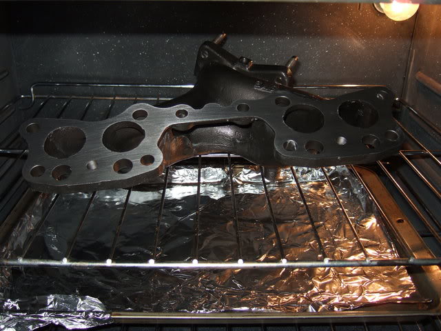

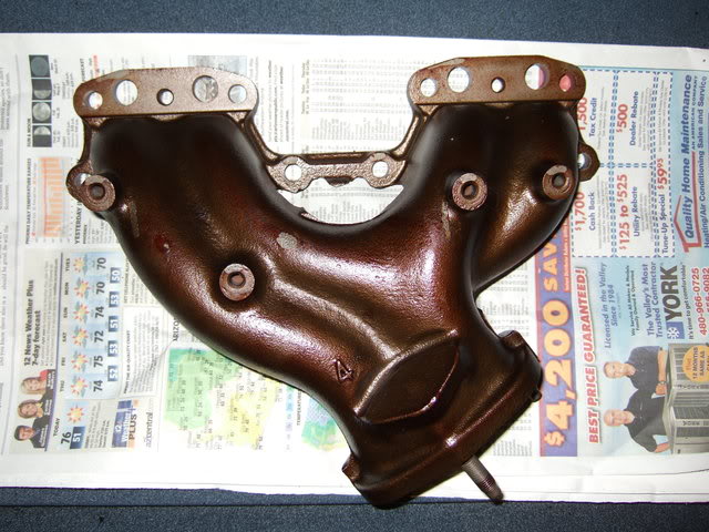

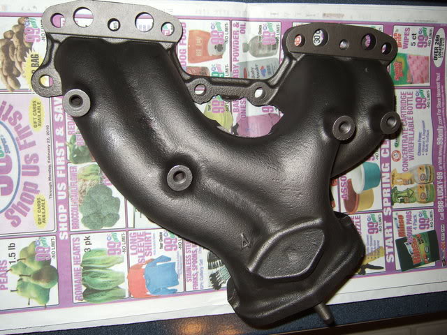

Earlier Stace mentioned that some guys were seasoning exhaust manifolds like cast iron cookware instead of using fancy, expensive high temp paints.
Mine only had light surface rust after 23 years. I presume it didn't come with any coating from the factory. So, I'm not concerned about protecting it. The aluminum cover/shield that routes warm air into the air intake pretty much covers it up, so appearance isn't really an issue to me either.
As an experiment I decided to give this a try. I'm betting the seasoning will burn off when the manifold gets up to operating temp, but we'll see. Maybe it will provide a cheap, long-lasting dark finish. Since this is supposed to be an old school sort of thing, I e-mailed Ted and asked what he knows. He said he had never heard of doing it, though he bakes connecting rods (I'm assuming to make sure they have been properly drawn and aren't overly brittle).
I used a thin coating of Crisco. Baked at 350 for 2 hours, then turned up to 400 for another hour. When cool it had a few drips in places that had coagulated, but they wiped off easily. The coating is still quite soft overall. If this works and appearance is a concern, I'd suggest seasoning several times. Bare cast iron cookware usually requires several sessions to get everything coated and baked in well, at least in my experience. Later, through repeated use, the seasoning turns darker and harder. One time here will have to suffice.
I tried to avoid mating surfaces, but still got a little grease on them. I'll clean them off with a wire brush in the dremel.
Edit to update: A wire brush didn't touch even this relatively soft coating. Sandpaper did.
Smell wasn't any worse than seasoning anything else cast iron. I only had one smoke detector go off. Roasting chiles on a stove burner usually sets off at least two.
Clean as it came back from the shop.

Thin coating of Crisco and positioned like this in the oven. Notice the foil lined cookie sheet underneath to catch drips.
