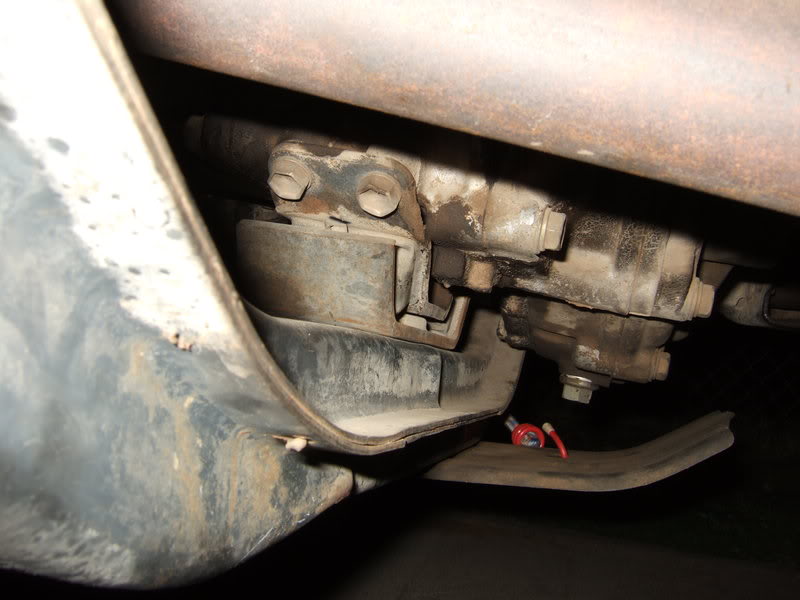

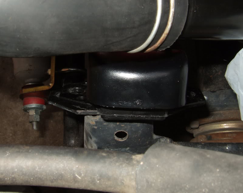

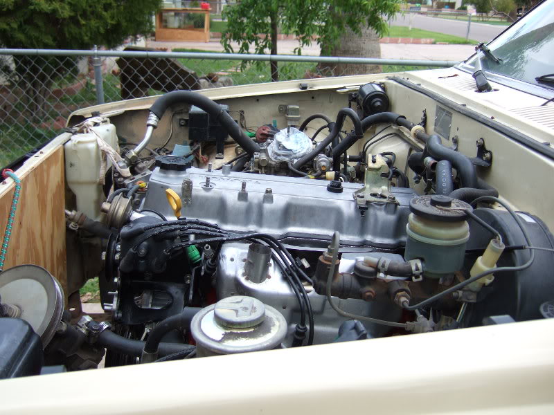

It still wasn't easy, but finally the engine stabbed in. The bottom of the bellhousing/engine made full contact. The top had about a 3/8" gap even after putting some bottom bellhousing bolts in and lowering the tranny and engine. Installing the two evil top bolts closed the gap. We got them in using swivel joints and a stack of extensions. Tight fit, especially on the driver's side, but we managed without lowering the tranny.
A problem remains. The motor mounts don't line up. The driver's side is the worst.

Notice how my old driver side mount is squished over as though it didn't line up very well either.

The passenger side is off some too, but not as as much.
Any suggestions how to deal with this?
Old Mar 8, 2010 | 06:21 PM
  #307
iamsuperbleeder's Avatar
Joined: Feb 2008
Posts: 12,248
Likes: 33
From: Lake City, Fl
what's the trans mount look like?
Old Mar 8, 2010 | 06:37 PM
  #308
TinMan's Avatar
Joined: Jul 2009
Posts: 832
From: Eastern NC
Yeah unbolt the trans mount and push the engine forward, bolt the eng mounts in lightly, and then bolt the trans mount back up.

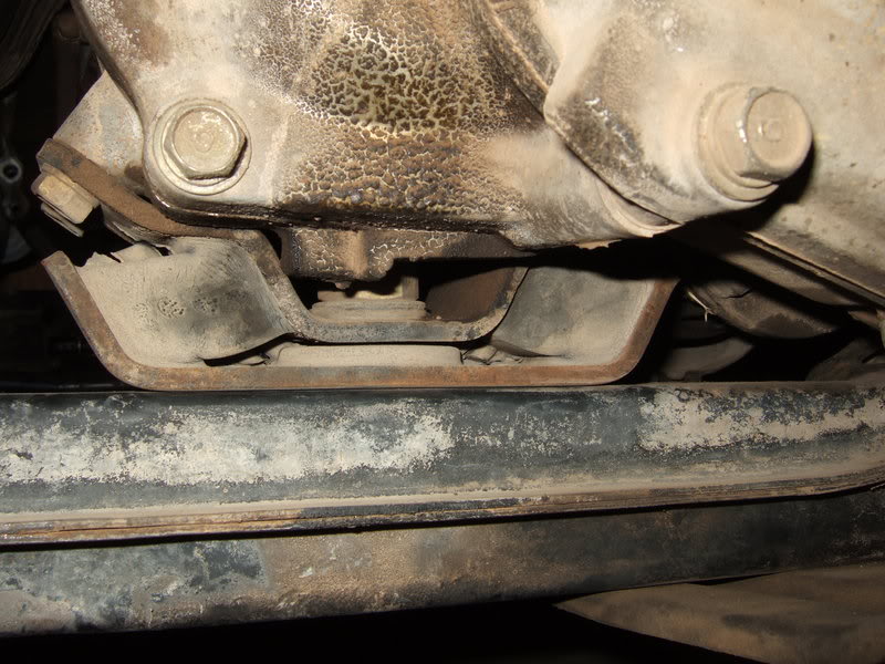

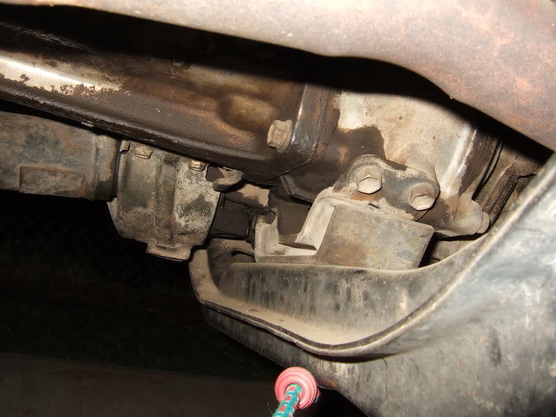

Looks pretty good, I think. Here are some pics:

ok im a bit late on the suggestion for the engine stab. but ill say this for next time. ive put mine in twice over the years with exactly same cherry picker. short chain on intake side, short chain on exhaust side. two guys on engine and one on floor jack working tranny height and it would go in with valve cover on..........
last tiem with engine i had to loosen motor mounts bolts and then take a pointed prybar to get them over to line up. put a bolt in a few turns then work on next one. then slowly tighten them up up. like u would for torquing a head. good luck and once agian great pics

When I put new eng mounts in mine, the tranny mount seemed good also. but when I lowered the eng down the mounts did not line up. I fought with it for two days before loosening the tranny mount. once I did, the eng mounts slipped right in, and the drive train was in good alignment. then I went back and tightened the tranny mounts. I am talking about the tranny mount bolts that go up through the crossmember, not the ones into the tranny itself. good luck.
Old Mar 9, 2010 | 05:18 AM
  #312
Staceman1's Avatar
Joined: Oct 2009
Posts: 134
From: NW Phoenix
I do see wiggle room on that Trans mount. It looks as if it could move forward 1/4 to 1/2 inch. Notice there is more of an overhang of the mount on the rear of the crossmember? Loosen the 1 bolt on the trans mount at the crossmember, move engine/trans/case forward as 1 unit just far enough to secure the motor mounts. Resnug the trans mount bolt, and job well done.

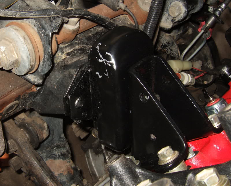

You mean the big bolt in the middle of the trans mount that would be hard to get a wrench on with everything together? It holds a circular piece underneath. I tried everything except that.
To gain play, I loosened: 4 12mm bolts in the trans mount, crossmember bolts, engine mount to block bolts. The nuts on the mount studs were already loose. Got underneath and used my legs in an attempt to shove everything forward. Also tried to knock the trans mount forward using a block of wood and hammer. Made sure the crossmember itself was as far forward as it could go. Pried the mount brackets on the block forward. The engine was mostly supported by the hoist through all this (hoping it would be easier to shove forward).
None of that did anything. I got the bolts in by prying the rubber parts of the mounts forward. The passenger side didn't need much. The driver side required a lot -- enough that it can't be good for the rubber to be stressed like that. However, the old driver's side mount was similarly mushed over.
I wonder if the dent in my crossmember is partly responsible.

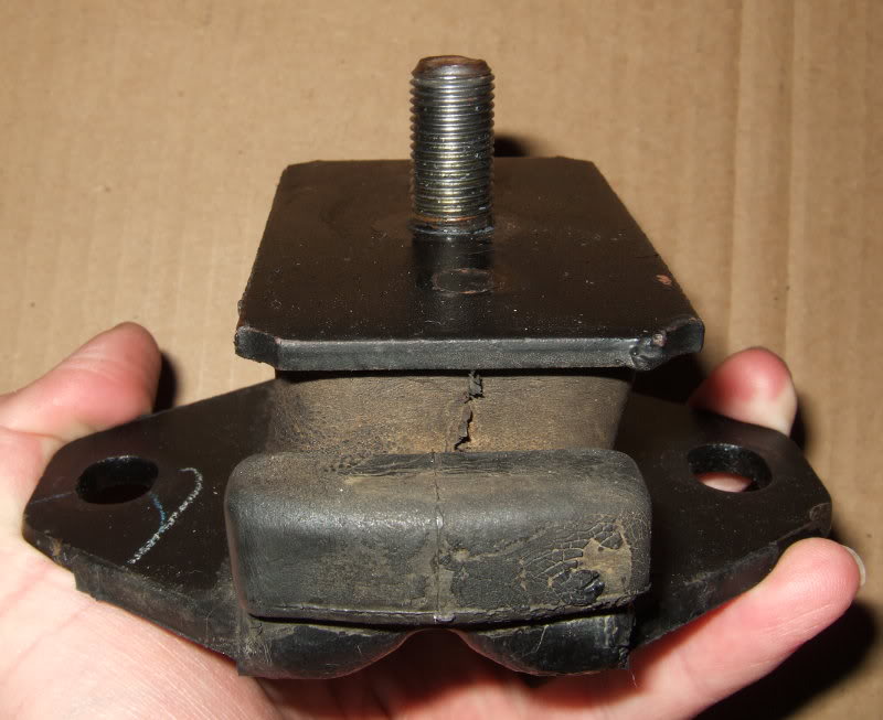

As shown before, the new mounts are taller than the old ones (see this post). Maybe too tall. I had a very difficult time getting the valve cover on past the heater hoses. At first I didn't think it would go at all. Look how nose high the engine sits. Is that normal for new mounts? Do they start like that but quickly settle in? Maybe they aren't the right ones.
I'm thinking the fan will be too high to fit in the shroud. I plan to check that next.

Apparently some 4 bangers in these years came with V6 mounts.

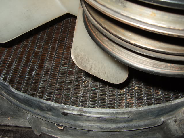

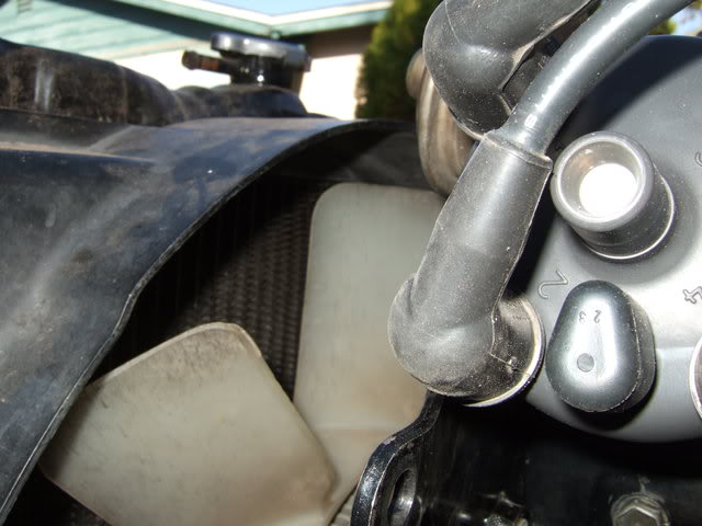

I didn't have much time today. I put the fan and radiator in with a few bolts to check the fit. The top gap between fan blades and shroud measured about 13/16". The bottom was about 1 1/4". The nose is up a tad, but far less than I had thought.
I tightened all the bolts on the motor mounts and everything else I had loosened in my attempts to move the motor forward. Got the starter, slave cylinder and clutch hose in before running out of light. Then realized I had forgotten a bellhousing bolt blocked by the slave. Doh! That's the way these things go. 3 bolts and the slave should swing away enough to get the bolt in.
Top fan clearance:
Bottom:
