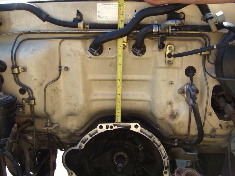

I got started pulling the engine with a friend's help. I'm taking pictures and labeling. I'm leaving intake and exhaust on. I want to disconnect only what is required to yank the thing out as whole as possible. Can't work very long in the sun here in the desert. The high here today according to my thermometer was 108. A few hours in the morning are tolerable. My driveway isn't shaded.
So far, everything is disconnected except the remaining bell housing bolts. The infamous top ones were a PITA. Reaching them from the top wasn't a viable option. I tried. Passenger side would have been the easiest to do that way, but with all the carb crap still practically impossible in this situation as tight as mine were. If you could find a slim enough cheater pipe to fit over a box end wrench with no angle at the end, and the bolts hadn't been in for 23 years, maybe... Then again, the 12 point box end may have just rounded the bolt. A wrench from the top on the driver side with exhaust manifold attached and other garbage in the way is a definite no go in my case.
We got the passenger side bolt loose with my friend's air gun with a stack of 1/2" Harbor Freight extensions and a HF impact "u-joint" adapter (they sell two kinds -- we used the ball and socket type -- the 3/8" and 1/2" combo set). As many have said before, stacking extensions takes the punch out of an impact gun. But, we eventually got it out. It took a lot of force to crack free.

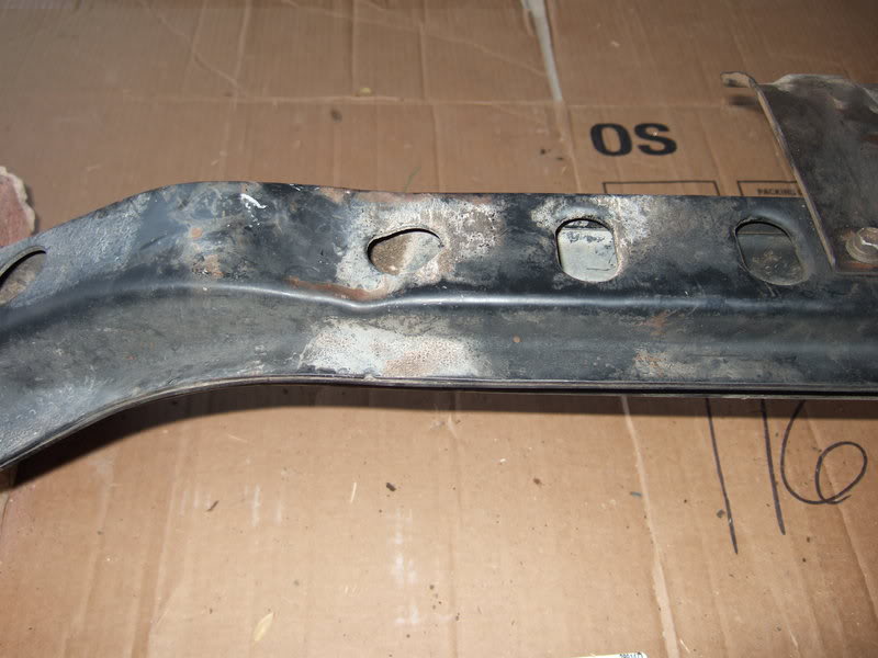

On the driver side the setup we used wouldn't fit. So, we decided to lower the tranny. Unbolted the crossmember and took it down a bit. The impact gun at even 140 psi couldn't rattle through all those extensions enough to get that bolt free. With the transmission down that far, and so many extensions, we had a straight enough line on that side to put a cheater pipe on a flex handle with enough room to rotate. That cracked it loose after a strong grunt. So, those bolts are out.
We went to bolt the transmission crossmember back up and found it wouldn't fit. It wouldn't no matter how we tried to start the bolts to tease it in. The thing is splayed out at least a good 3/16" side to side. All I can figure is the dent I put in it years ago created some outward tension that caused it to spring out when it was removed. I'll need to wallow out the insides of the holes to get it back on. I'm presently contemplating what tool to use for that job. Grinding bits in a drill didn't work, and the round hand files I have are small and fine-toothed. I'd like to find something that would work in my angle grinder.

I found a coarser, larger round file, elongated the crossmember bolt holes, and got it reattached. I should eventually replace it. The stock design isn't very good. A Budbuilt crossmember looks nice, but $200 is way too spendy for me. I'll keep an eye out for a used Budbuilt or other aftermarket crossmember. It's not worth spending much. What my truck needs most upgrade-wise is a good rear locker. Electric or ARB. I don't want an auto. I have rarely had clearance problems, but the open diffs are a hindrance.

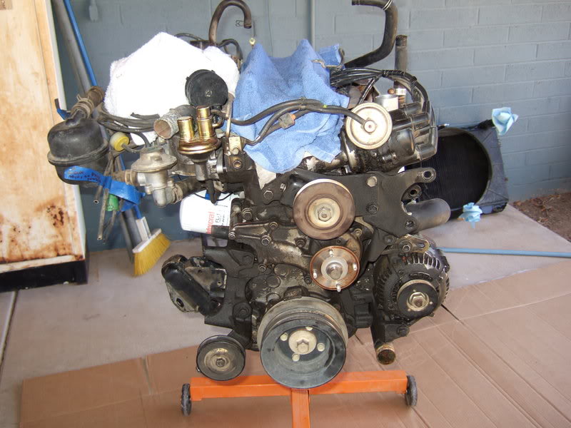

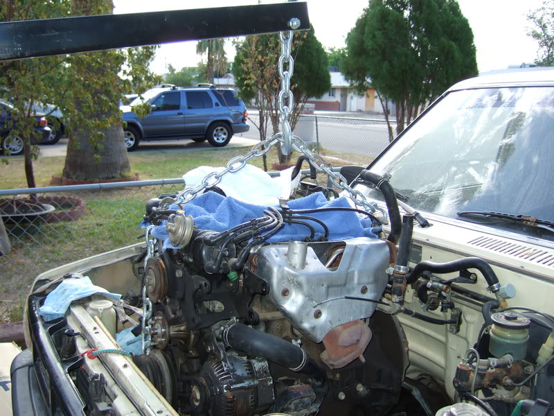

The engine came out easily. Don't forget the 17mm bolt by the clutch fork. I almost did. We took the tie off the a/c compressor shown in the previous pic. My friend worked the compressor around the passenger side engine mount as we brought the engine forward.
We jacked the tranny up some for the oil pan to clear the differential. No problem there. With the hoist raised to match, the engine slide right out after a few wiggles.
The clutch bolts came out easily. A smack with the palm of the hand on the end of a socket wrench broke them free. I used my electric impact gun on the flywheel bolts, though there are ways to handle them if an impact gun isn't available. I should have also used the gun on the 12mm bolts holding the engine/trans plate thing, because I partially rounded one of them using a socket wrench. When I slapped the end of the handle the dangling engine moved forward enough that the socket slid part way off the bolt. Not a big deal. I'll get a new bolt.

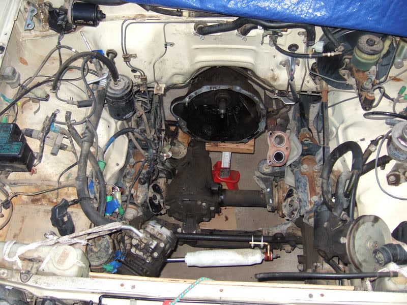

On the way out. Note the thin plywood placed in front of the a/c condenser to prevent the engine from banging into it. It wasn't needed as the situation turned out, but may have been if we had to get rough.
We raised the transmission this much to pull the engine. I thought I should keep track so I can position it about the same for reinstallation. We later propped up the bellhousing with a stand and removed the jack. The engine rolled slightly to the passenger side as it came off. Might need to use a ratchet strap to rotate it back to install.

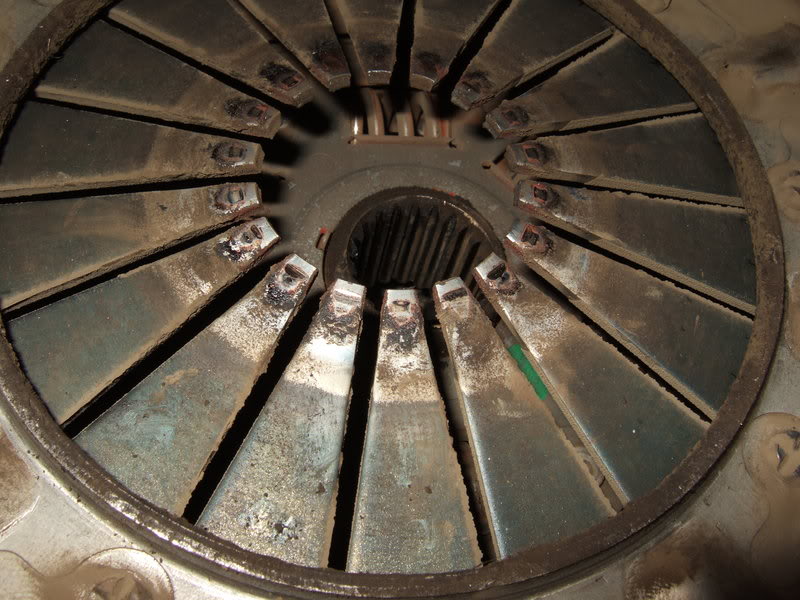

Wear on clutch plate fingers. This is the original clutch with 116K miles.

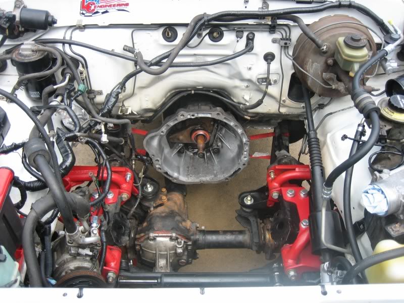

btw, it might be easier to just wrap a ratchet strap around the frame rails and then under the trans, to keep it supported; makes it a little easier if you have to roll the truck out of the way somewhere, lol
you can kinda see what I'm talking about in these pics of mine:

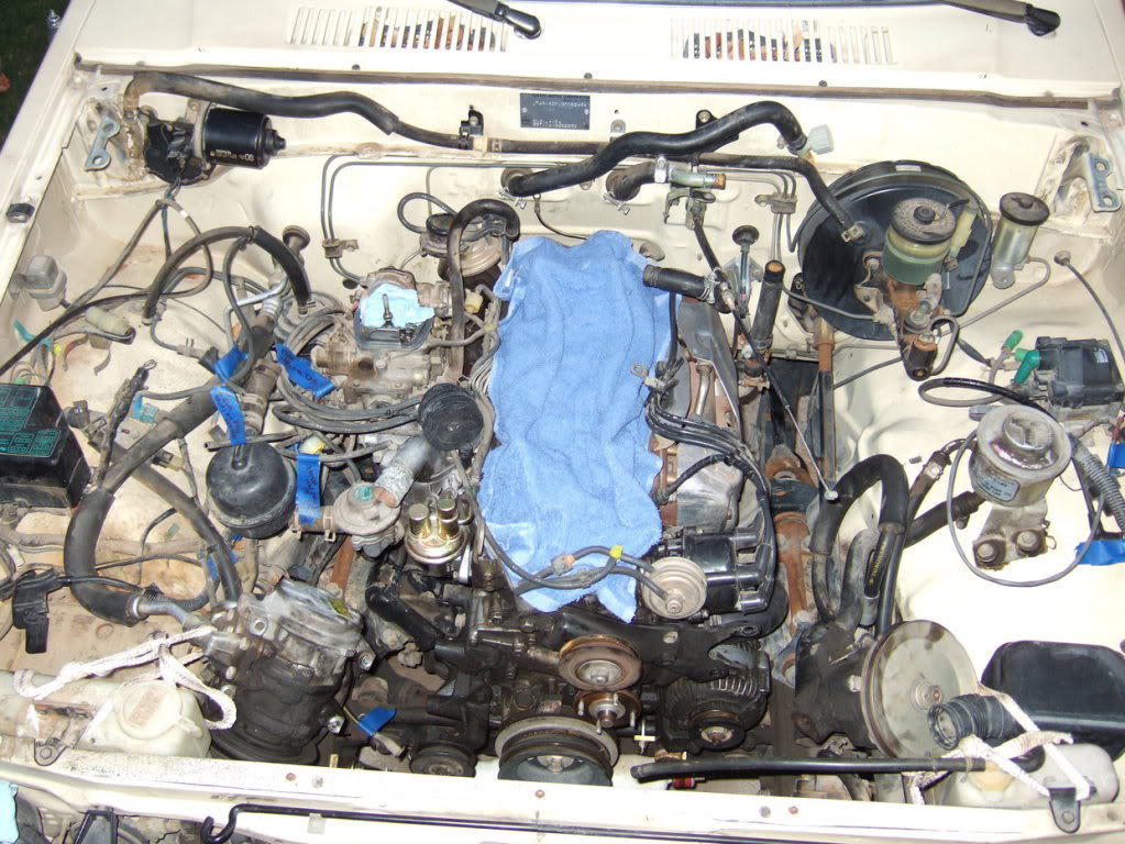

I noticed I forgot the obligatory empty engine bay shot, so here it is.

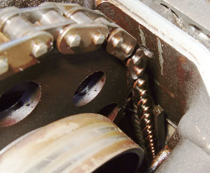

The timing chain guide is chipped off at the top on the driver side, but look how the chain has apparently contacted the head. How did that happen? Strange.
