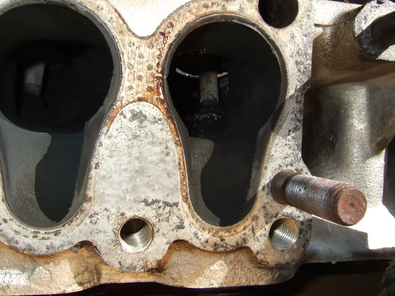

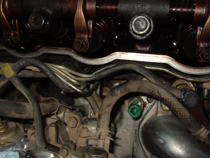

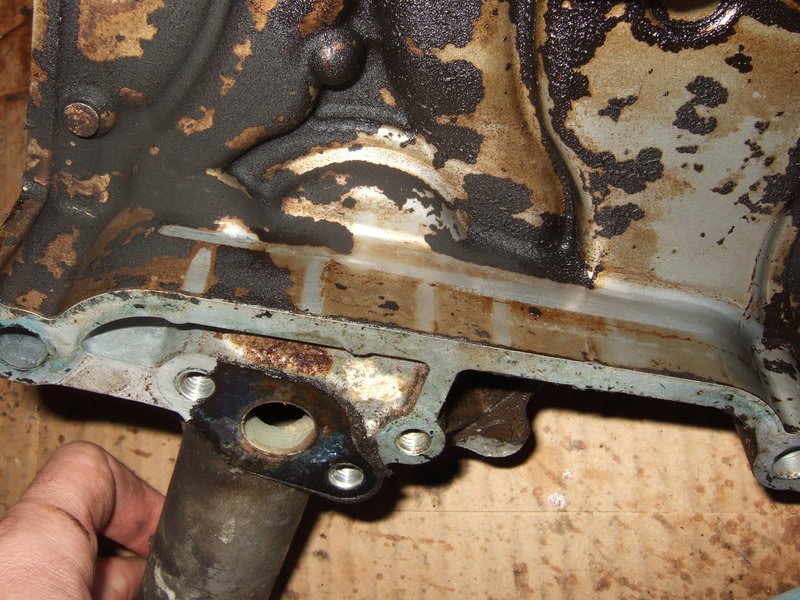

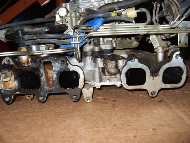

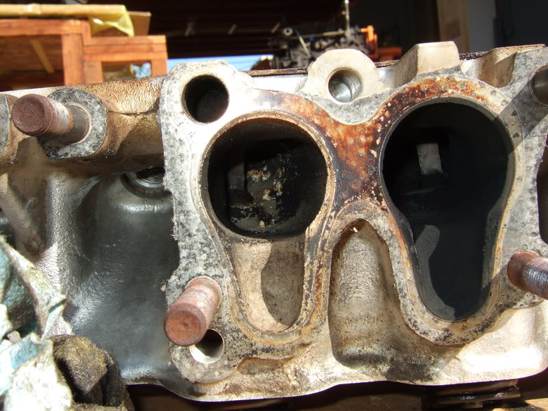

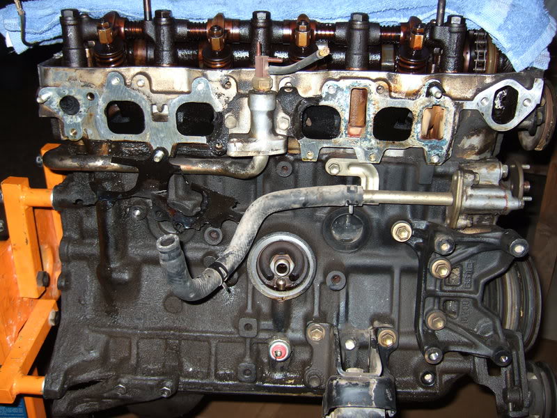

Here are a few pics, starting with an angled shot from the rear of the intake.
Moving along the top. For perspective, you can see where the EGR tube connects in both pics. That vacuum tubing assembly will stay on the intake. It's free from the head.
Up front.
Underneath.
Can you see anything I'm missing? The coolant pipe that runs to the bottom of the side cover is also stuck tight. It doesn't need to come off to pull the intake, but may indicate how baked on some things are.
I doubt it will help, but I sprayed PB Blaster all around the intake gasket.

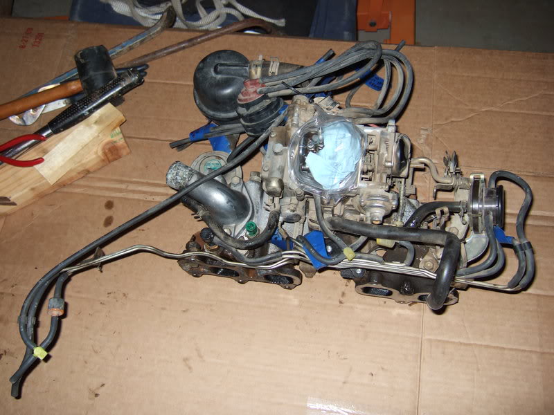

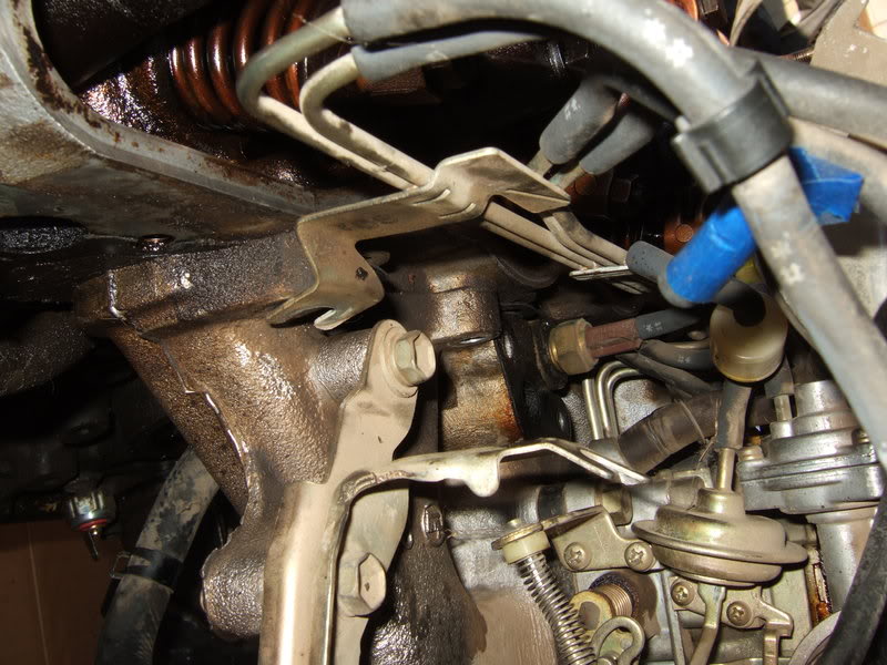

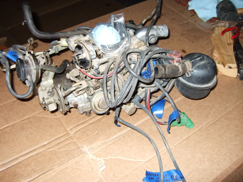

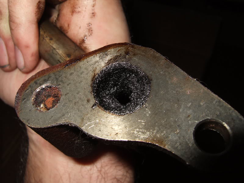

I got the intake off.
After some contemplation (and a few beers), I went after it with a 2x4, a 1x2, and a hammer. After smacking pretty hard around the edges it eventually came free.
I had to disconnect the 2 hoses going to the valve in the side cover:
The intake as I removed it.
Note the pencil end stuck in the vacuum line that goes to the AAP. Mine ruptured years ago, and the engine wouldn't idle when cold. I cut the line and plugged both ends. Problem solved.
EGR tube.

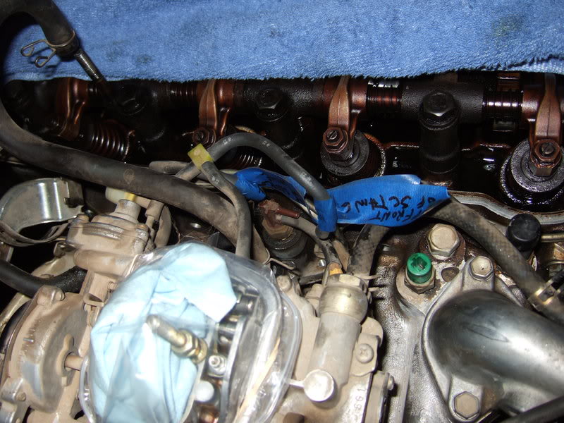

I turned the engine to TDC before removing the distributor. Replacement chains have an identifiable link to put on the dot. All the links on my factory chain are the same color. Ignore the effect from the camera's flash. Two at the top say Japan -- the one over the dot and the one to the right of it. I don't know if that is significant because I didn't pay attention to the rest of the chain. There may be other adjoining links that say Japan. Doesn't really matter except for forensics because I'll be installing a new timing set.
While at TDC I shook the loose rocker arms to estimate the valve clearances. #3 exhaust caused a holy $&@! moment, so I checked them all.
1 intake: .006
1 exhaust: .008
2 intake: .001-.002
2 exhaust: .008
3 intake: .007
3 exhaust: WAY off. To estimate how much, I worked in the the .035 and .032 feelers stacked together, but barely, so I figure maybe .065-.066 actual. Ouch.
4 intake: .007
4 exhaust: .010
All clearances were fine last I checked. Can't remember if they were .007 and .011 or .008 and .012, but all were about right. Something got screwed, but what, why and how?
I plan to use new rocker adjusting screws and maybe also new nuts. I've read that these are not items to skimp on, so I'll probably buy them from Toyota.

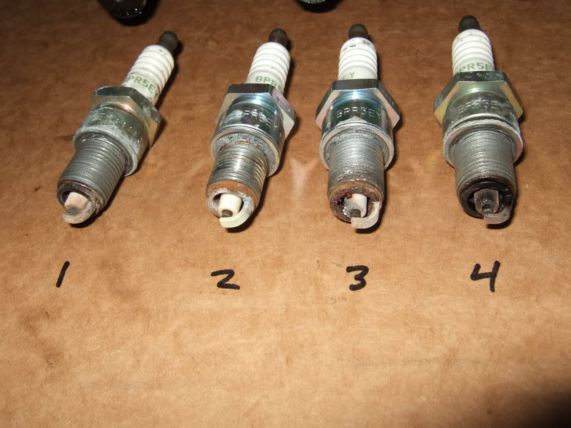

I pulled the plugs. I had to use a cheater pipe to wrench out #2 and #3. I knew these were messed up before, and I plan to use a new head, but fighting plugs out still made me queasy.

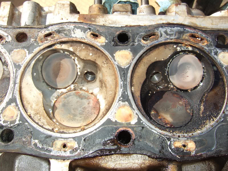

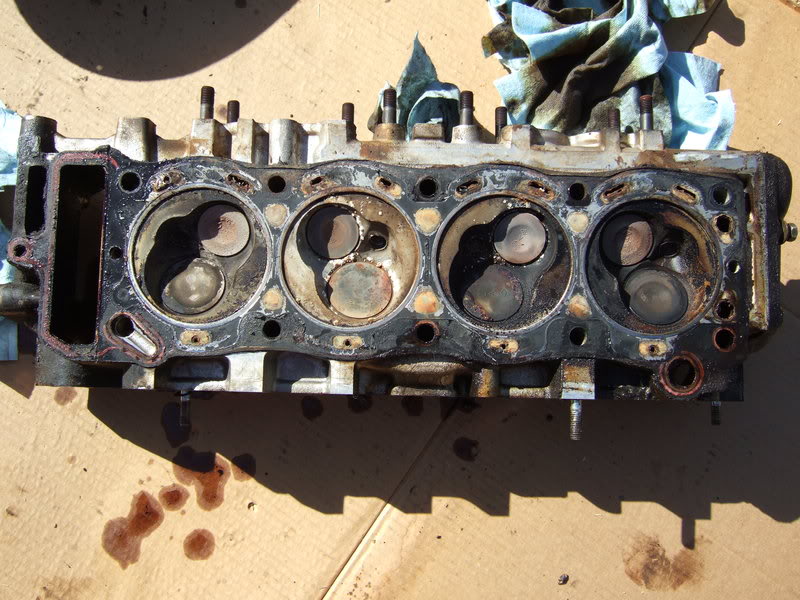

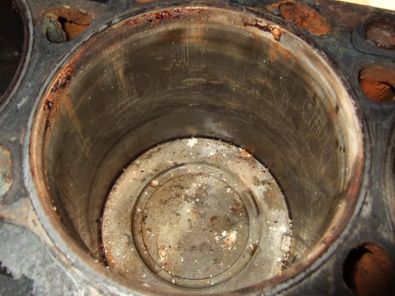

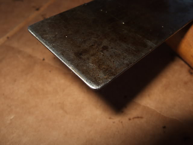

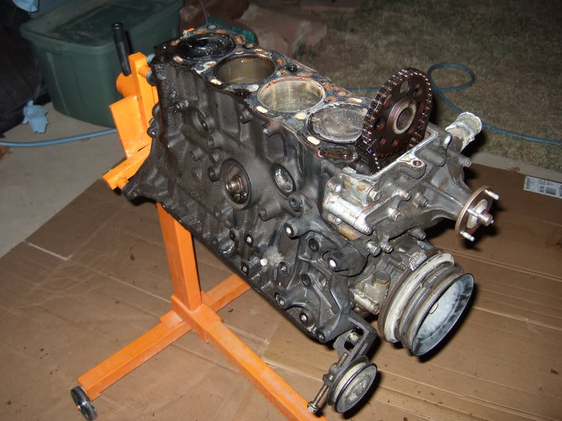

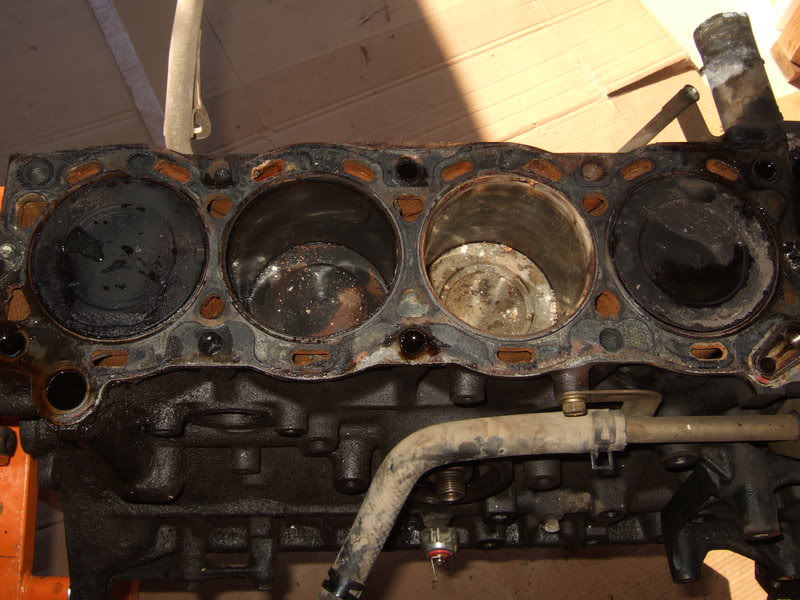

Today's progress.
Number 2.
Number 3.
Gotta like this one. #3 exhaust valve is stuck. You can see daylight around it. That had to have happened very recently.
#2 and #3.

I hope it ends up being a love story. Right now it's a more of a suspense. I look at the growing accumulation of parts and wonder if I'll be able to put this thing back together correctly. I hope I don't make an expensive stupid mistake along the way.

keep up the good work -- your marking of all your vac hoses was probably the single most important step for finishing this job successfully with the least amount of frustration

Thanks, yodta. I've been debating what to use on gaskets. Seems to be a lot of controversy: dry, Hi-Tack or similar, a skim coat of RTV, etc. as well as where all to use it. I notice the factory water pump shows some orange FIPG around the edges.
I'll definitely use something good on the oil pan, either Toyota's FIPG or The Right Stuff (the kind labeled for imports, I presume?).
I bought a pack of nitrile gloves before starting this. I'm tired of my hands being soaked in brake cleaner or worse every time I clean parts. Can't be healthy.
I don't know yet what I'll do with the intake. The ports going to the head don't look too bad, but the plate under the carb (water bypass plate) and the heater bolted in the middle of it have gunk all around the edges. I hate to think what the inside looks like. I'll replace vacuum hoses one at a time, but I don't want to take off the whole tangle of tubes and hoses. The EFI guys have it easier.

Lots of good info, and coming along nicely. You definately got coolant into cylinder 2. Looks like the passages around the cylinder are a little blocked, corroded. 3 certainly is a burnt exhaust valve. Bummer on that. What you doing with the head? replace or clean-up/valve job? I used straight hi-temp engine paint when I did block, no primer. It'll be superclean when you get the block back from the shop. As for your exhaust manifold, I did mine with hi-temp silver/fake aluminum color. What some guys do on 4x4wire, believe it or not, is to brush on old bacon grease, throw the manifold in the oven for 30 mins or so to really work in. Manifold will come out a beautiful black, and stay that way for a long time. I'm doing it the next time I ever have it off. Have you removed the bearing caps and removed the crank yet? Be sure to post pics of the bearing surfaces as they come out. Give me a hollar if you need help with re-assembly. I'm no expert, only rebuilt 1 22RE, but, no issues with 30,000 miles AND its a daily driver. Take care, Staceman.

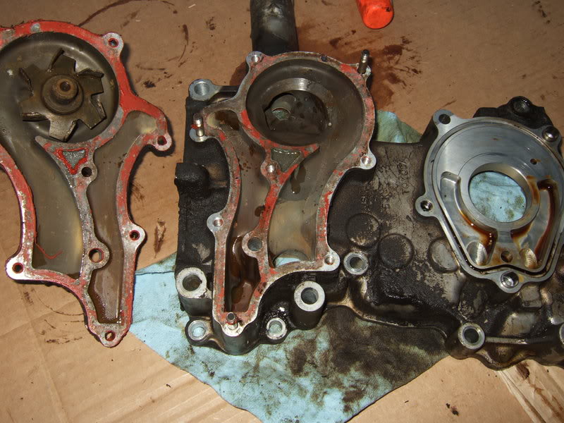

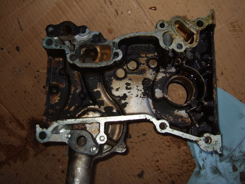

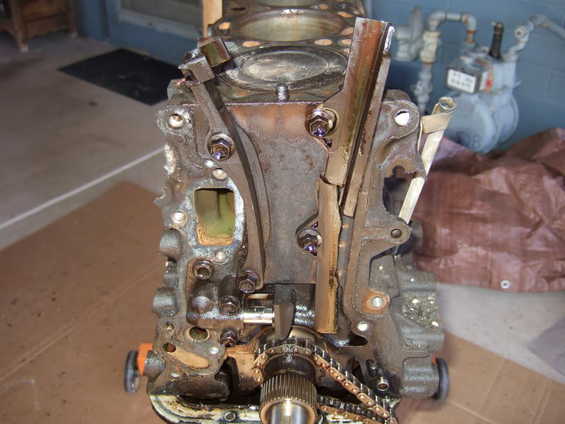

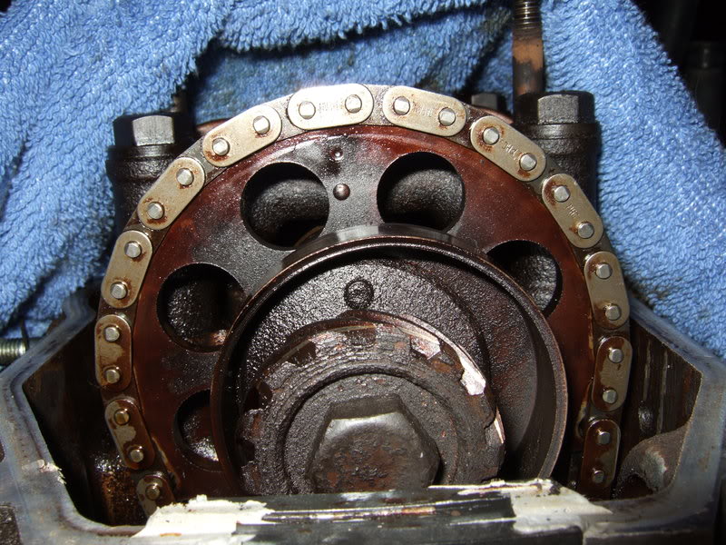

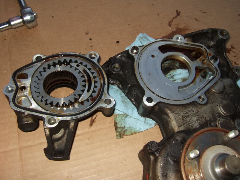

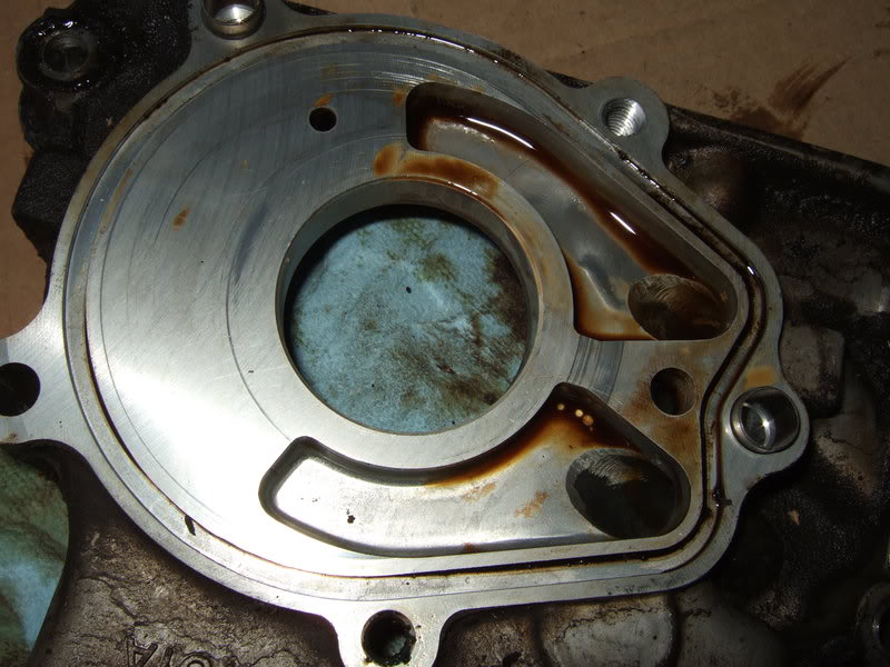

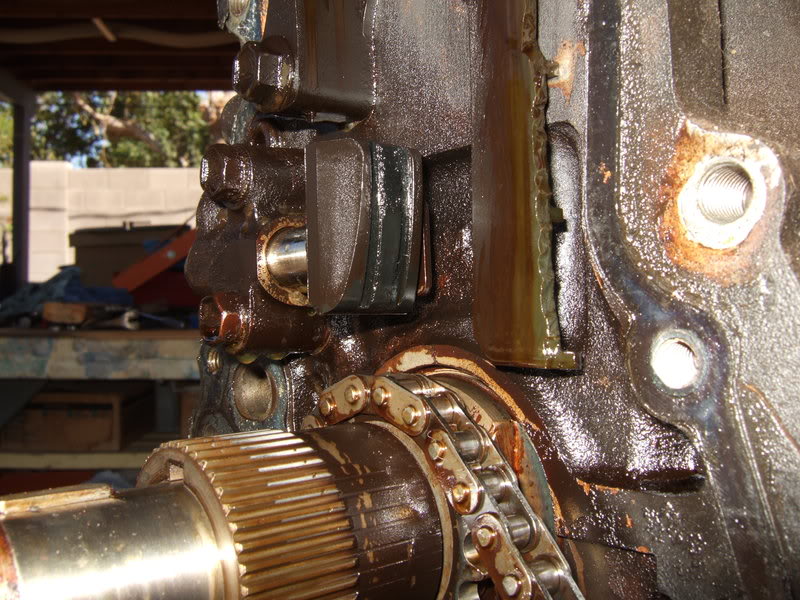

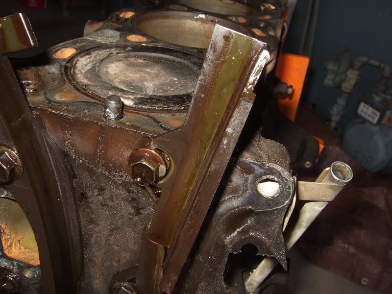

As I suspected, I was missing a bolt -- the one by the oil pressure relief. I clarified the diagram posted above. Plus, in the upper right they point at a water pump nut instead of the proper bolt that also holds the alternator bracket.
It's hard to tell from this pic, but there isn't much wear from the chain.
But, the driver's side guide is a mess. The top half fell off when I removed the cover. The passenger side is loose on its top bolt.

She didn't have much, if any, care the first part of her life. It's a 1986 I bought in 1993. Even back then the inside of the valve cover had that crud built up.
I heard timing chain guide parts fall as I flipped the engine over. The oil pan came off easily. I slightly sharpened the edge and rounded the corners of an old putty knife. I tapped it in gently about half the thickness of the pan lip all around. The pan popped right off after the second pass.
Notice the sealant is gray. I thought Toyota's FIPG for pans is black.
Earlier I noticed piston #4 in particular sticks up relatively high above the block. Factory specs for quench are 0 to +.006". Since there is some crud on the block and pistons, I couldn't get an accurate measurement, but a .016" feeler slid in under a square with room to spare. #4 had unusually high compression, and I'll bet this is why. #1's quench seemed to be about .007". I didn't check #2 or #3. I'll have to mention this difference to the shop and find out how they intend to address it.
How should I number the rod ends and caps before removing? Hammer and screwdriver?

My oil pump measures ok according to the FSM (LU section).
Gear to body: .005" (max is .008)
Inner to crescent: .007" (max .012")
Outer to crescent: .009" (max .012")
Side clearance: .003" (max .006")
I'll check the new one when I get it and compare.
I'm surprised how good my water pump looks. The bearings feel snug and smooth, no wobbles or slop.

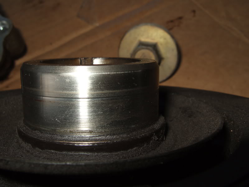

This so far is the best picture I've managed of my crank pulley. Is the groove deep enough that I should sleeve it?
