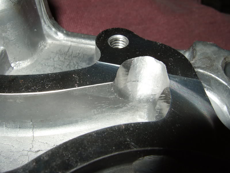

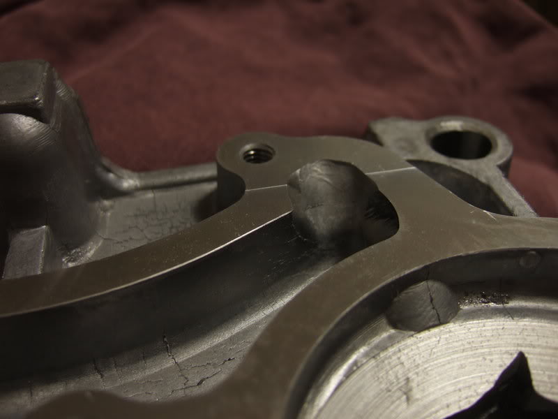

The timing cover also isn't very impressive. What at first glance looked almost like cracks in places are actually small ridges. Sort of an eggshell effect . The oil passages to and from the oil pump are quite rough. Most of that is cosmetic. The potential functional issue is the water pump mating surface is not completely flat. A portion at the top wasn't milled to the same depth as the rest. It's hard to show in pictures, but here are a couple:
I don't know if the step is bad enough to cause an issue. It is a little concerning. I've read many advocate putting the water pump gasket on dry. I'm not sure a gasket by itself will seal in this case. My pump didn't have a gasket, only orange FIPG. Any opinions? I need to decide whether I'm going to use this one ASAP. The shop is waiting for me to bring parts.

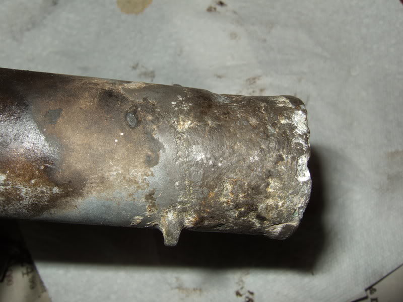

The only thing wrong with my original cover is the radiator hose tube is badly corroded. In the worst spot it's very thin, almost all the way through. Strange how it corroded like that under the hose.

I am alot concerned about those pictures, cosmetic or not.
I have heard only the highest praise for ENGNBLDR on this site. I woud think that you should contact them and voice you concerns. Myelf as a non-mechanic, I am concerned that you picked up all those irregularities / deficiencies whereas I may not.
Please post what you are going to do. I know you said that the shop waiting for your parts, but I'm sure you aren't their only income and you should have complete confidence in what you are bolting on 1st.

Not sure what to do about the timing cover. If worse comes to worst I'll find someone to weld up the corroded part of mine. New Aisin covers cost about $120.

Sounds like reusing the old pump is the way to go. It's pretty bad that the new pump is out of spec - that does NOT reflect well on Rock parts. You absolutely should not have to pay someone to repair a brand new part (the cover) that you just bought. Talk with Ted and tell him it is not acceptable and I'll bet he'll take care of you - at least he might sort through his covers and find you a less bad one. It sounds like he needs to source parts somewhere else.

My old Aisin cover is corroded where the radiator hose attached. Apart from that, it's fine. It's the one I'd try to repair.
The Rock cover has a small step (about .003" higher) in the upper part where the water pump attaches. And it's generally messy. I'll clean up the inside if I use it. Some of those "ridges" flake off with a fingernail.
