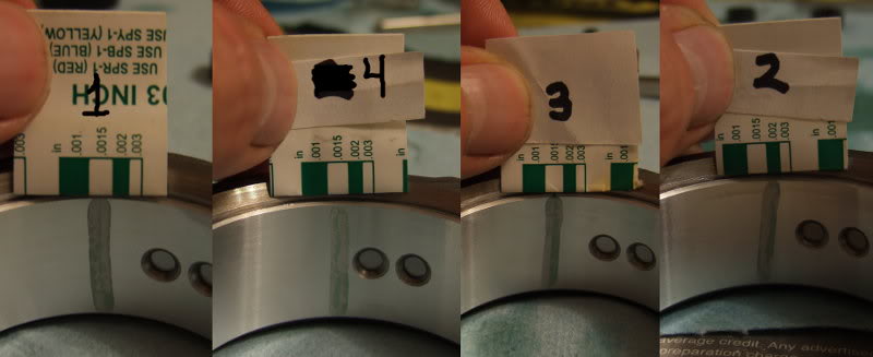

I got the other two pistons in. The crank rotates fairly easily using a proper wrench. The shop "redid" 3 rod ends so standard size bearings would fit with the proper clearances. Looks like he did a good job with that. My manual says spec is .0010" to .0022", with a max of .0039":
Thankfully, none of my pistons stick up too high. Measuring height isn't easy because they don't sit perfectly square to the deck all around. Laying the back of my calipers across from different directions and measuring with feeler gauges, I got approximately:
#4: dead even to +.003"
#3: approx -.006" to -.008"
#2: dead even to -.0025"
#1: ? to -.008"
Seems like quite a bit of variation. Is that normal? My original #4 piston stuck up frighteningly high (way too high), but maybe the carbon layer on it was thicker than it appeared.
The block was decked .009".

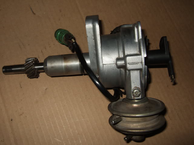

Distributor cleaning began by scraping off chunks with a screwdriver. It was filthy. I replaced the o-ring that the cap sits against. I think I saw a shaft o-ring in the gasket kit.
I should have snapped a before pic. I know this is only a boring picture of a distributor, but I had forgotten what they actually look like. For cleaning parts like this I'm thinking a small steam cleaner might work well and save considerable time.

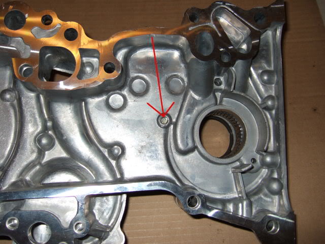

I wiped Vaseline into the oil pump gears but wasn't sure if the oil passage holes where it sits on the timing cover should also be filled. I put a little in, but if those holes/depressions are better off packed full, please speak up now.
Here is a picture showing the top oil pump bolt from the back side. It's the one that needs some sealant on the threads. It's also the one you need to make sure isn't too long. Mine won't protrude past flush when fully tightened.
