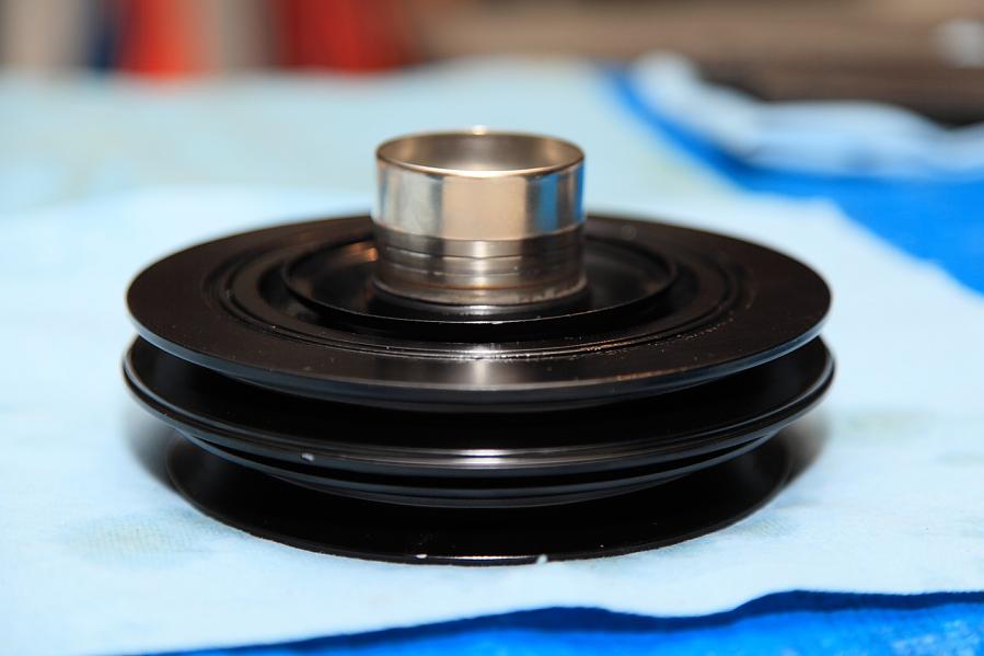

Using the FSM diagram for bolt storage--genious. I taped mine to the timing chain cover box and cut an "x" over every bolt. This was a great way to hold them in order. It's hot here in AZ, so I had to work fast to get eveything in place before the RTV dried up! Pic below...
You mentioned sleeving the harmonic balancer. I went with it, and sealed it in place with the Ultra Grey. I hope it doesn't turn out to be a mistake as one poster mentioned issues. Pic below shows the sleeve before I "pursuaded" it into place with the RTV. It did not go all the way to the "shoulder" (where the machined part ends) of the harmonic balancer shaft. Hopefully it will work.

I'm glad the pic helped. IMO, printing out the drawing is a lot easier than trying to scribble everything yourself on cardboard.
Your sleeve doesn't look to be on far enough to do any good. Since your pulley has two grooves, I'm guessing someone already did the thinner seal trick. You could probably do it again if you position the seal lip between the existing grooves. Maybe you got lucky with your new seal and landed far enough away from an existing groove.

i hope you packed your seal with some grease around the spring.. it will keep that spring from shooting off into your oil pump... and it will prevent the seal from leaking
