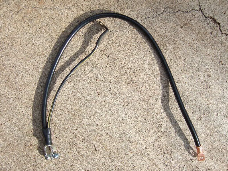

I went to an Interstate battery store/warehouse (69th and Orangewood for those in the west valley) and had them make me a battery cable. They didn't have any 4 gauge wire, so they used 2 gauge. Crimped part of my old main cable into the clamp to go to the fender/body ground screw. Only cost $11.48 after tax. Nice, helpful people there. Before making the cable they pulled a pallet off a top shelf with a forklift and dug through the boxes it held to see if they had a pre-made one that would work. A+ for customer service.

Yeah, it sure beats $30 everyone wants for a 6 gauge original style cable (actually, the orginal looks smaller than 6). Someday I'd like to put in a higher output alternator. When replacing cables, might as well get ones beefy enough to handle it. 2 gauge is overkill.
