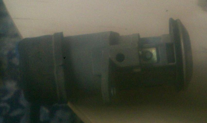

Ok, back in town and happen to have my spare setup in front of me. If you look in the picture below you will see a small gold square with a little silver pin in the center. You press this pin in with a small jewelers screwdriver or similar and the lock pulls apart into two pieces, the actual cylinder and the electric switch that controls the window.. The setup is pulled apart slightly in the pict. Once it is put back together the pin pops into that little hole to the left of the gold section. The pin is spring loaded.
Note: If you are just re-keying the setup you can just switch your new cylinder into the back part of the assembly without removing the entire black plastic fascia. You have to loosen it and let it hang down a little, then it is accessible. If you need to replace the switch for some reason, then you will have to disconnect the plug to it from within the tailgate to get the whole system out.
The easiest way to access this is to put the tailgate down then push the latching mechanisms on the tailgate in with a screwdriver. Then lock the tailgate. This will allow the window to be raised (now deployed horizontally) to get the window out of the way so you can access the bolts to the plastic fascia piece to remover it and get to the lock assembly. Support the window with something like a garbage can to take the weight off of it while working or it might break. This way you can get everything out without removing the window.
Good Luck and hope this helps.

Many thanks amigo! I knew there had to be something simple I was overlooking!!
