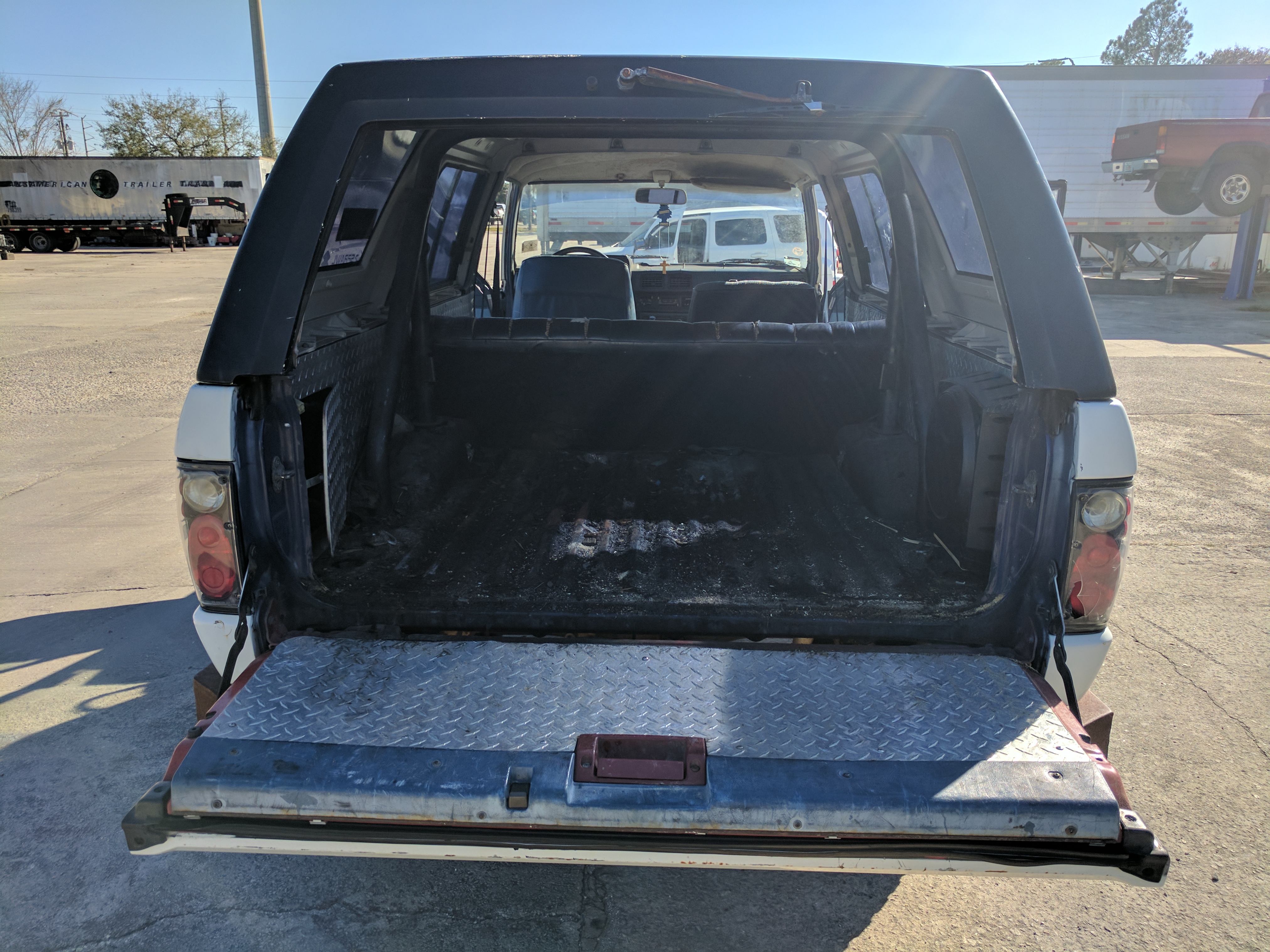

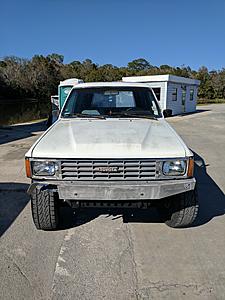

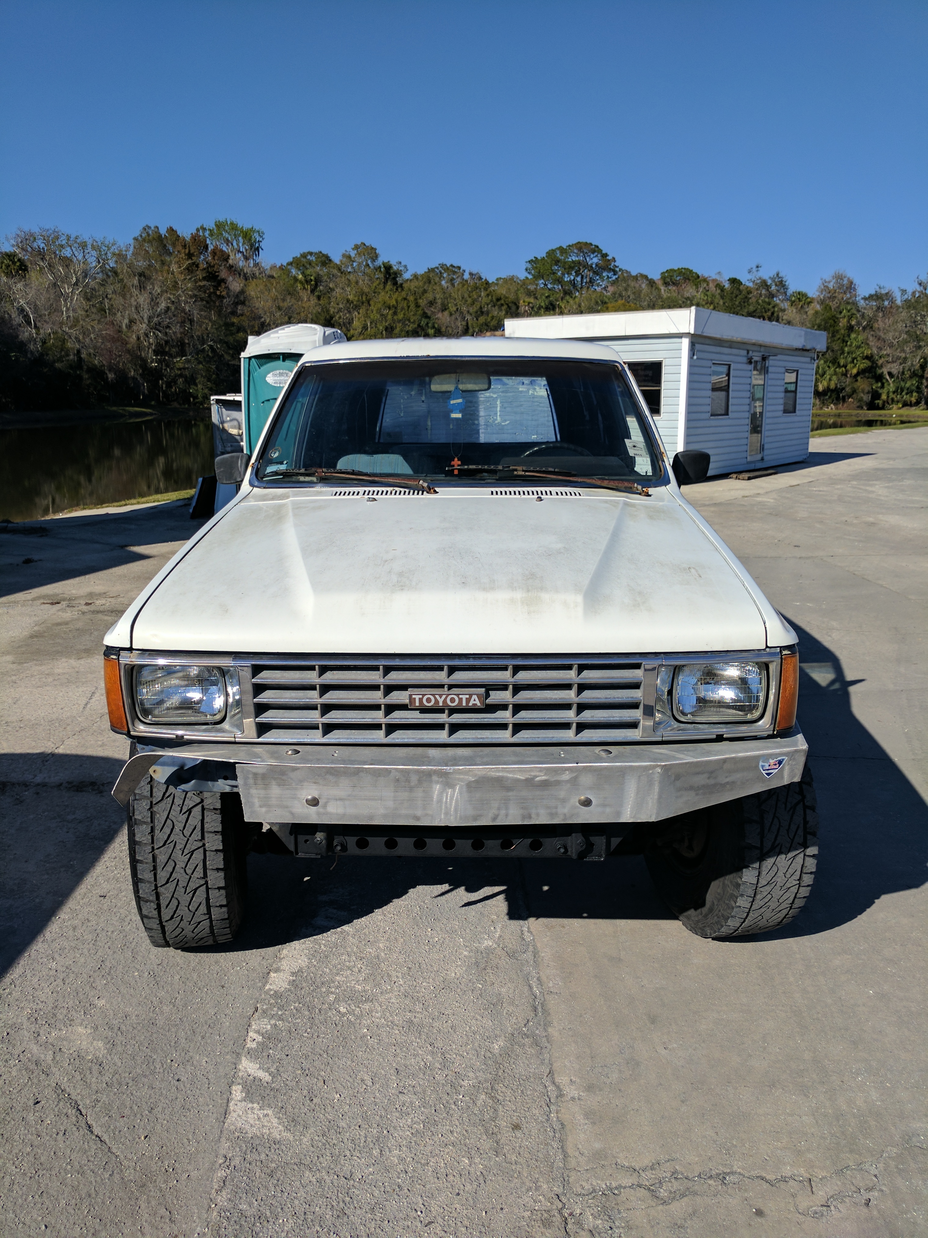

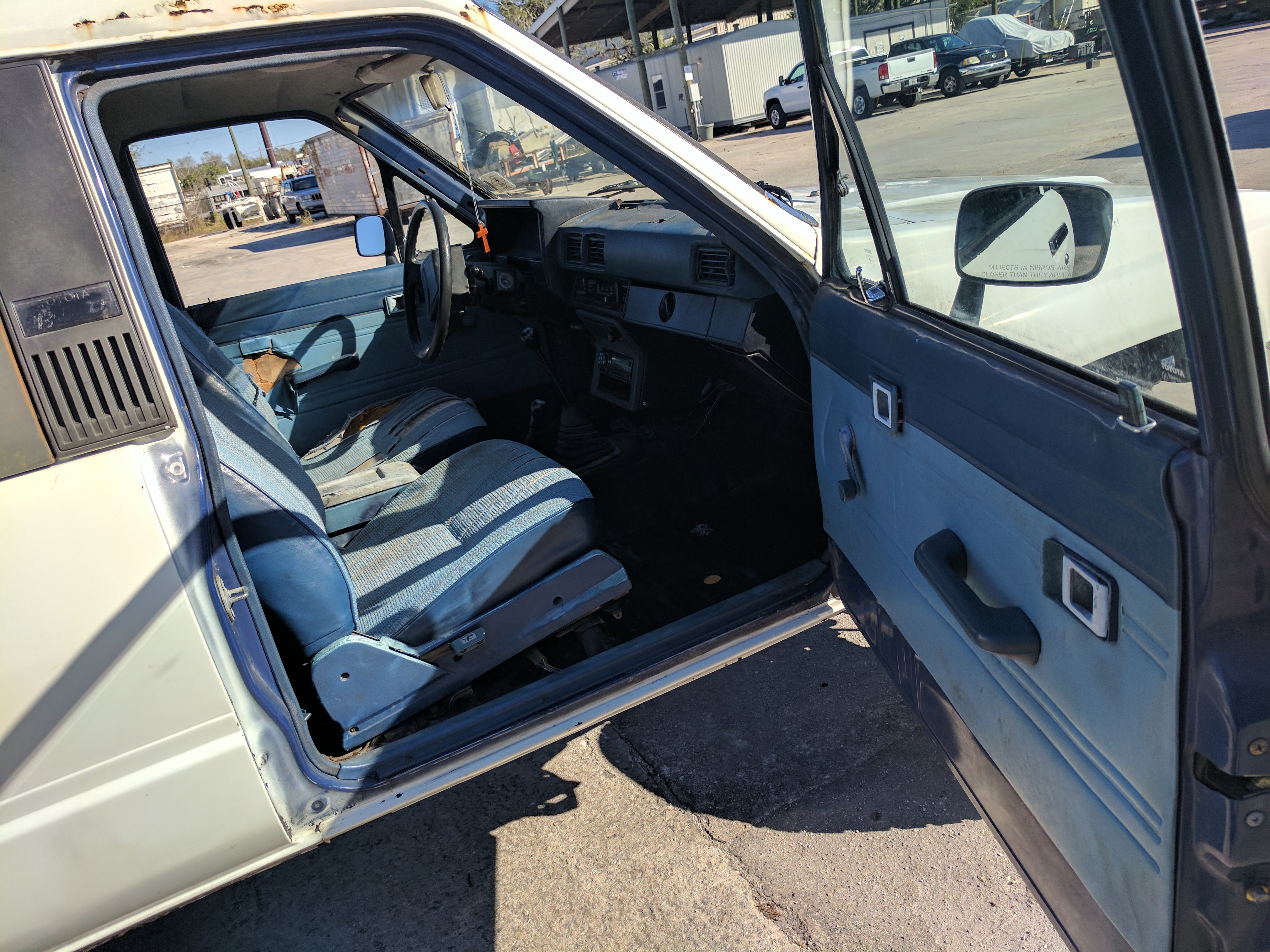

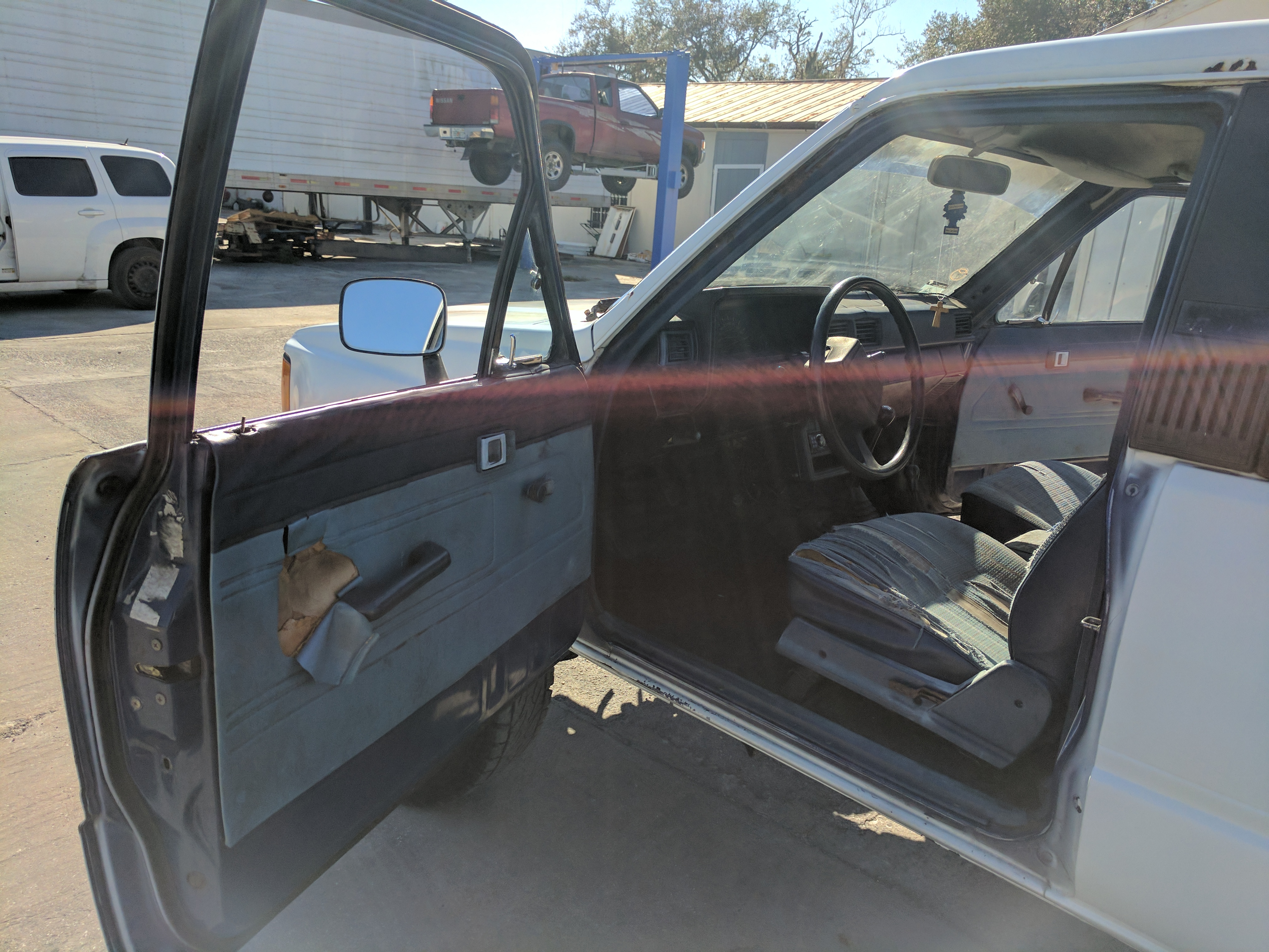

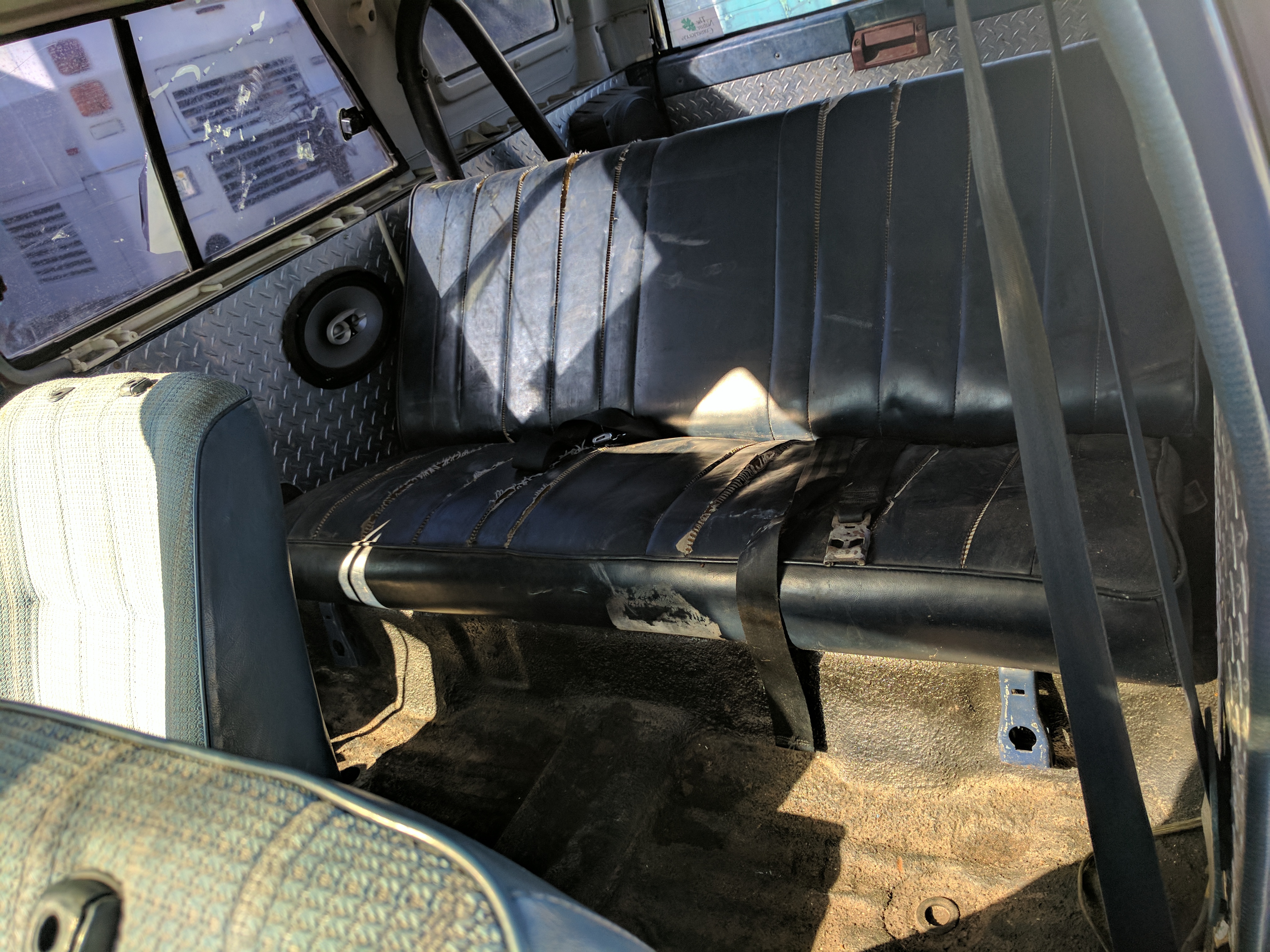

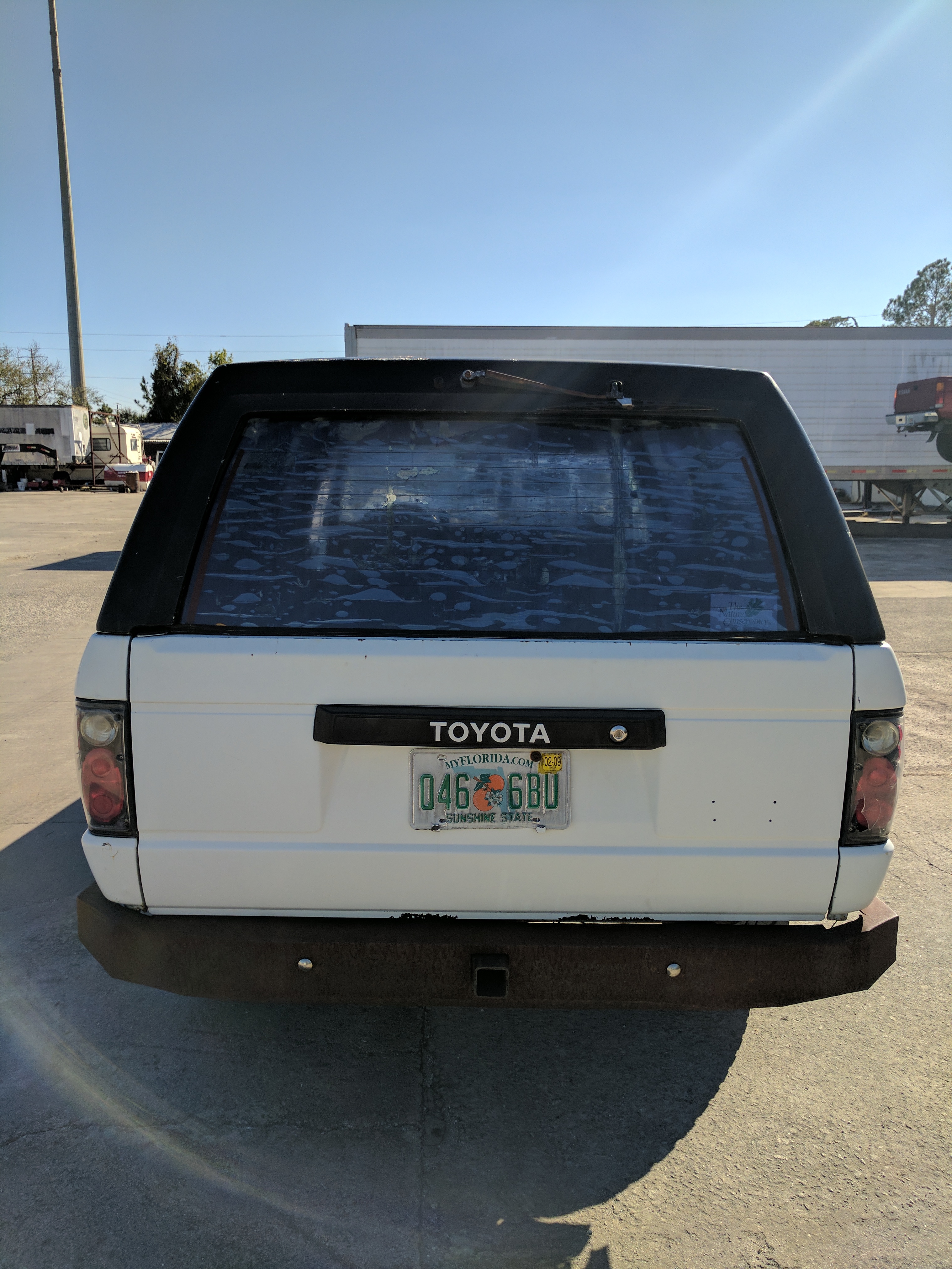

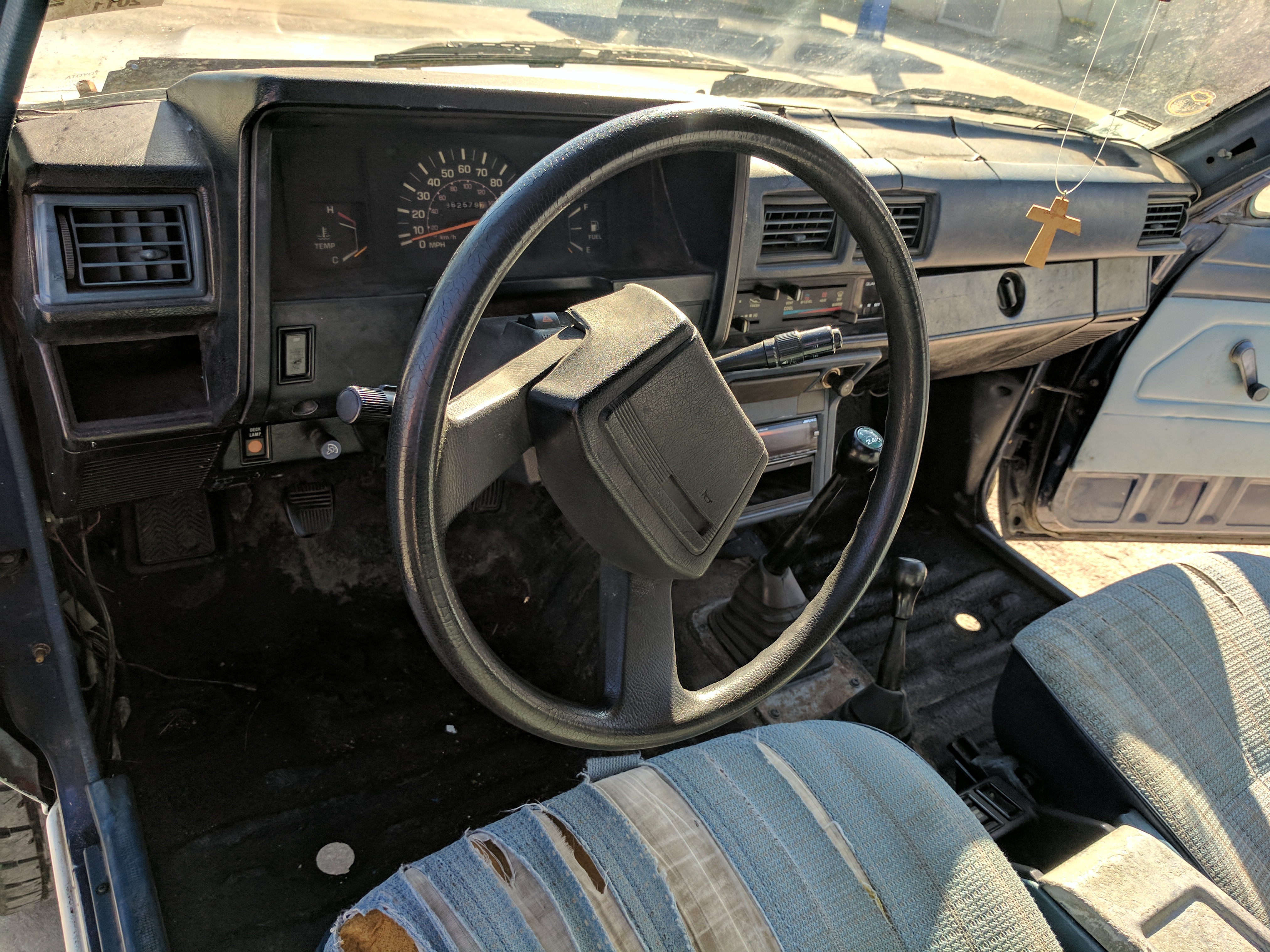

Here you go, lemme know what else you'd like to see.

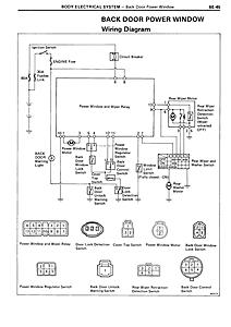

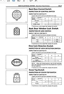

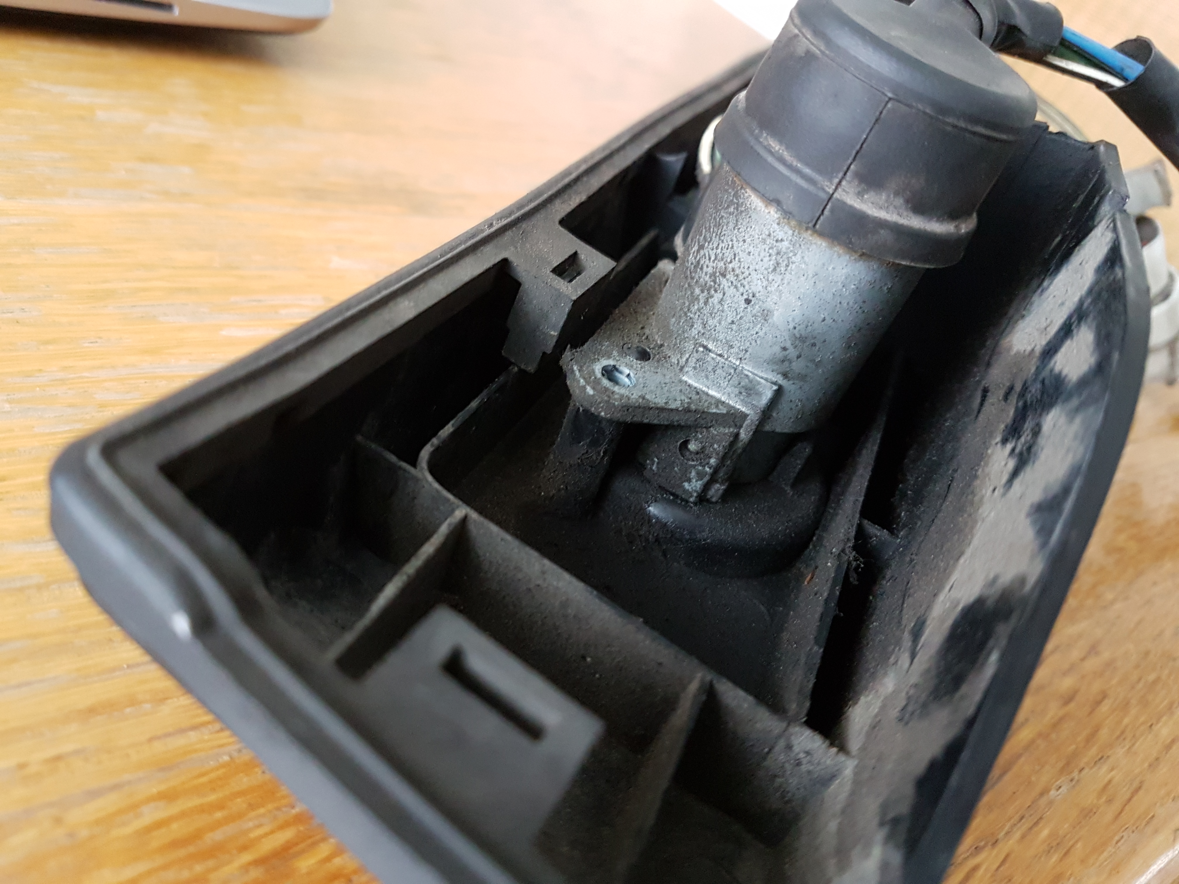

Any tips on the back window only going up with the interior switch and only goin down with the key in the tailgate?
In the past 31 years, someone must have poured coffee, soda or beer on those console switches - LOL!
AND could be bad switch contacts and/or broken wire in tailgate flex harness.
I hate that roll-up window. It does not belong on a spartan, utilitarian truck like the first-gen.
However, here's how that stupid system works, and how to troubleshoot it: https://www.yotatech.com/forums/f199...l#post52355907
Without a volt-meter, you can still do a quick test. See parts locations in link above, do the following and report back:
Console switch Operation:
Connecting wire going to pin 4 (Green with yel stripe) directly to ground should lower window,
Connecting Pin5 to ground (Red yellow stripe) in same manner as above will raise it.
Tailgate Key operation:
Wire to pin 11 (light blue-white stripe) when connected to ground will lower window.
Wire to pin 12 (lt blue-blk stripe) when connected to ground will raise window.
Bare, shiny metal of the body will usually be good ground.
Old Apr 21, 2018 | 11:13 PM
SomedayJ's Avatar
Joined: Jan 2017
Posts: 1,271
Likes: 335

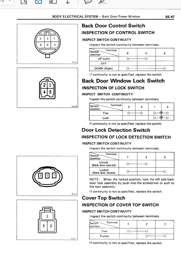

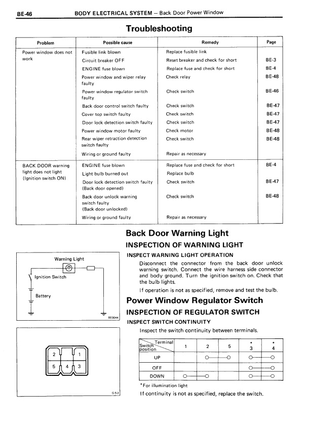

Originally Posted by HTGthird
I'll check that out, I just assumed it to be the high pressure side. I'll let you know Monday what I find.
Any type on the back window only going up with the interior switch and only goin down with the key in the tailgate?
Check the center console switch first, maybe it's dirty.
Check if the wires in the lock cylinder are good, they are under the rubber cover (see photo)
Edit: the electric schematic's for the 88 model.
Attached Thumbnails 1986 1st gen, bringing her back to life.-rw1.jpg   1986 1st gen, bringing her back to life.-rw2.jpg   1986 1st gen, bringing her back to life.-rw3.jpg   1986 1st gen, bringing her back to life.-20170124_143930.jpg

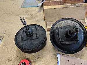

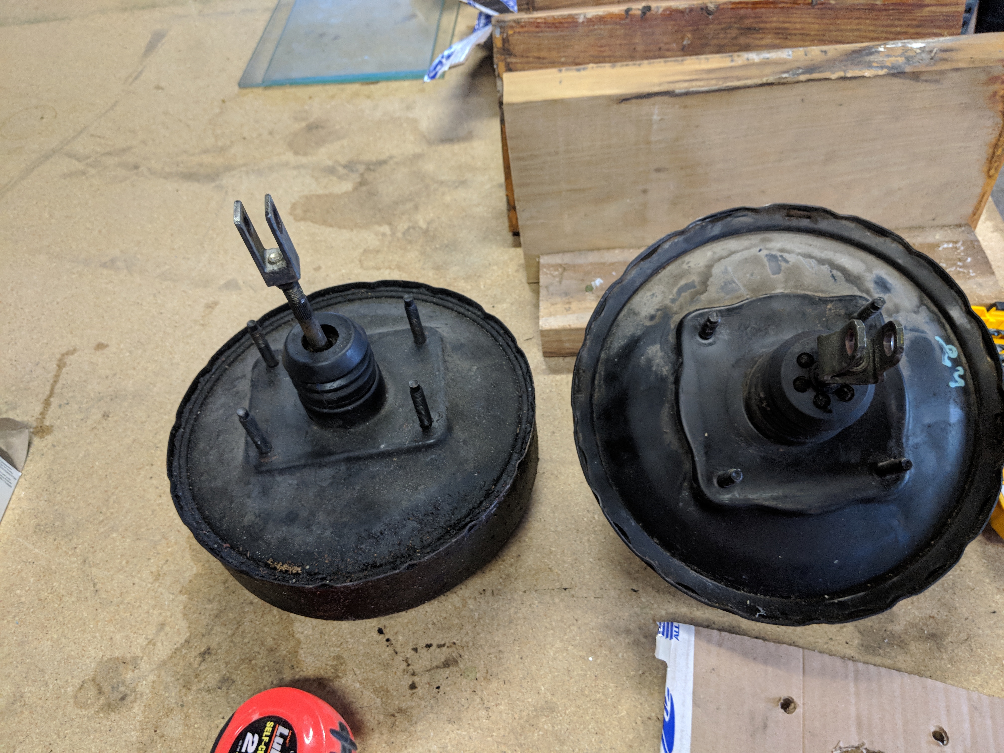

Brake booster woes...
Righto, so I have searched more than a dozen junkyards across Florida looking for a proper brake booster. I ended up yanking one off of a 1991 Previa, it was a stupid, last ditch move that may end up giving me more headaches than I want. I'm considering making a quick adapter plate to get it installed and my 4runner running again.. The Previa Booster is on the right, you can see the bolt pattern is square with the larger hold dead center, the factory booster is rectangular bolt pattern with an offset.
While we're talking about this, what experience do you guys have with vacuum leaks? Where and what are the most obvious culprits? What kind of permanent fixes have you found success with?
