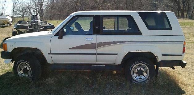

This was my first vehicle back in 2003, The motor locked up in 2004 with 389,*** miles on it. Now i'm ready to tackle the rebuild, debating wether i put the 3.0 back in it or swap out for a 22re.. wouldnt mind the good gas milage. Any suggestions? And i cant seem to find a replacement passenger window. It has been sitting for a long while so it needs a lot of work.

Nice and clean. I would ditch the 3.0 and go 3.4 if you have the know how and money. But 22RE is simple an fairly cheap as well.
I like that runner.....glad to see that someone isn't going to let it rot. Keep us updated!

It will most likely be a daily driver. I'm not against throwing some money into the build but my know how is pretty limited. i just dont want to pay someone to do it. Even if i dont go all out at least i want to do it all
